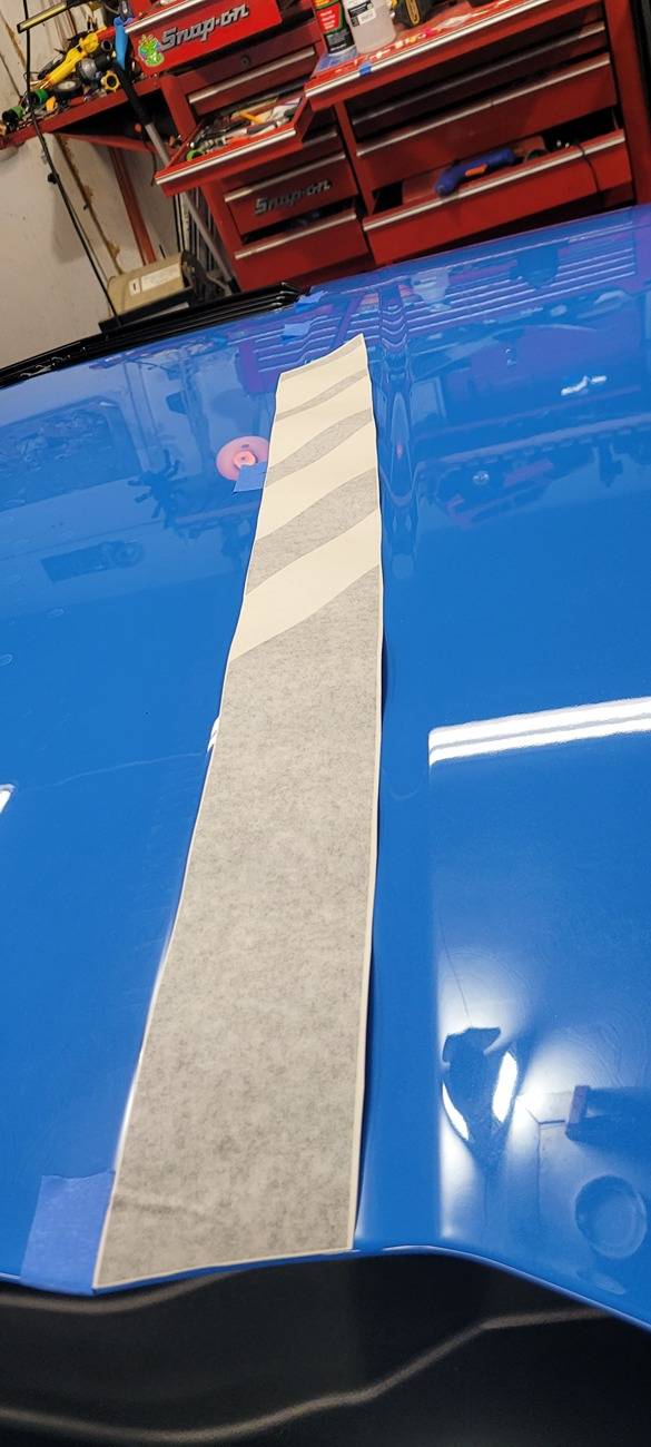

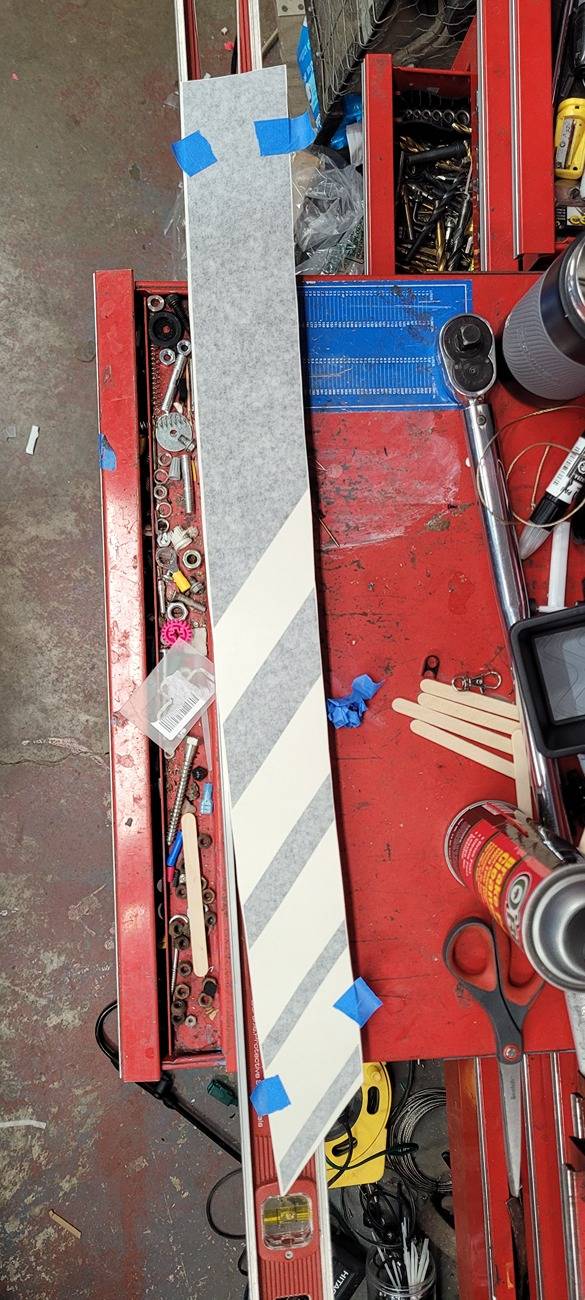

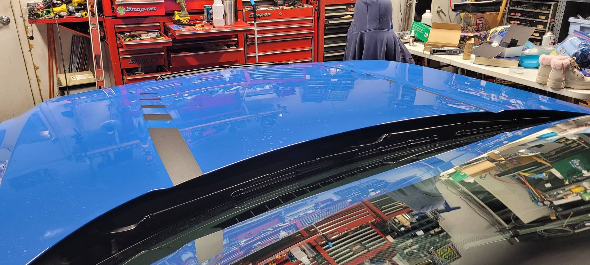

Since the hood stripes were curved like a banana an I had a hard time aligning the last ones against the straight hoodline, I decided buy another set. At least they offer 1/2 off for oops purchase. I just couldn't handle seeing the crooked stripe from behind the wheel.
I decided to cut the top of the hood stripes to make a straight line for me to align with the body line. I used a steel yardstick and used the points at each end of the stripes as datum points. My wife used her rotary cutter (looks like a small pizza cutter with razor edge) on a cutting pad to make a perfect cut. I wrapped the stripe around the back of the hood because the new alignment would have revealed a off angle at the back edge. I am much more satisfied with the result..

That looks excellent. Nice workđź‘Ť.
