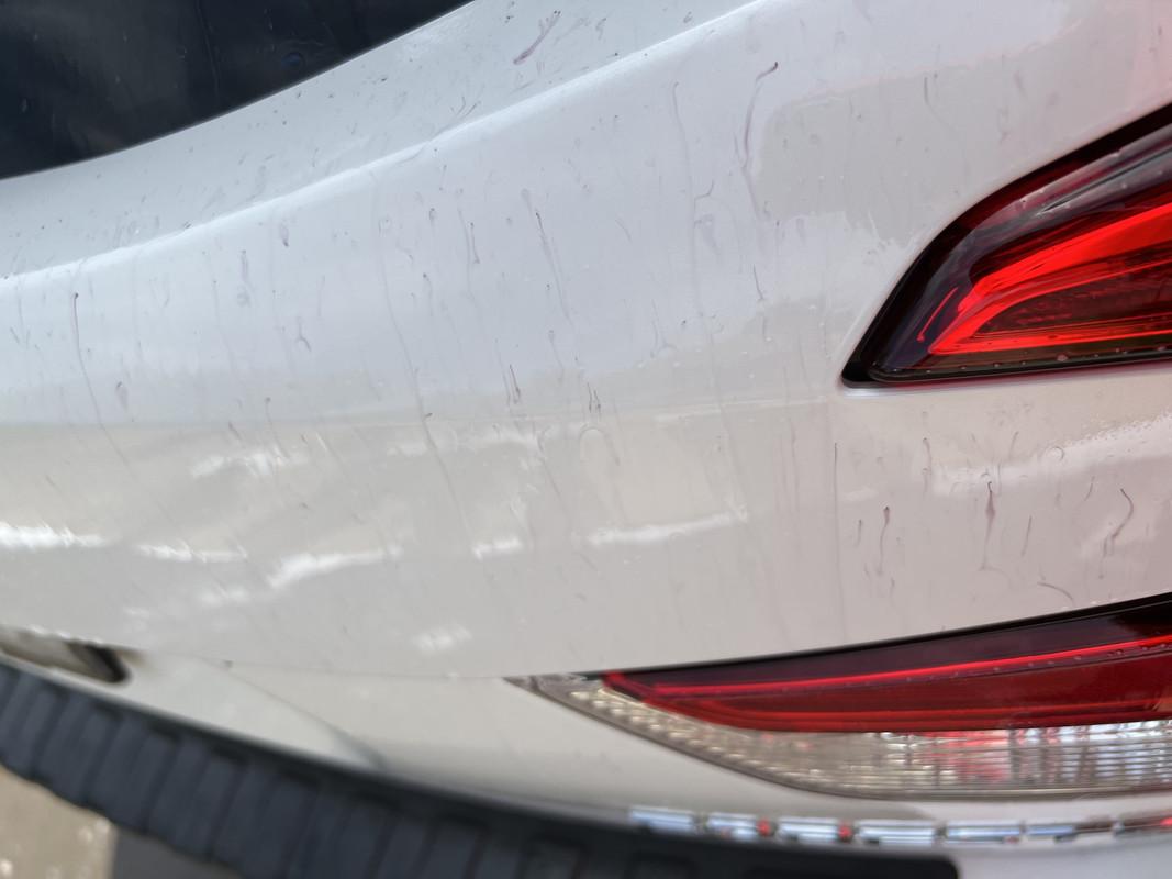

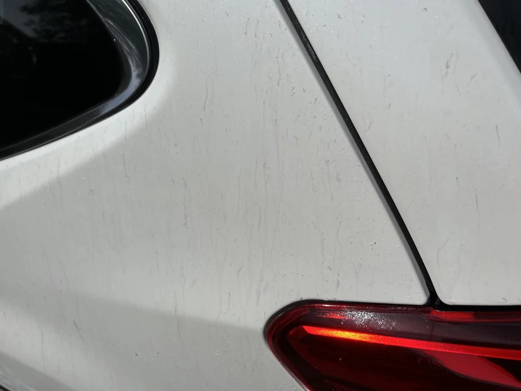

This is not actually a clay, rather a chemical that can dissolve and remove surface bonded contaminants, iron in particular. The active ingredient is Sodium Thioglycolic acid, which turns purple or red when it has reacted and dissolved the iron particles.
S650 Mustang DIY'ers Spray Clay IMG-0537
S650 Mustang DIY'ers Spray Clay IMG-0539
S650 Mustang DIY'ers Spray Clay IMG-0542

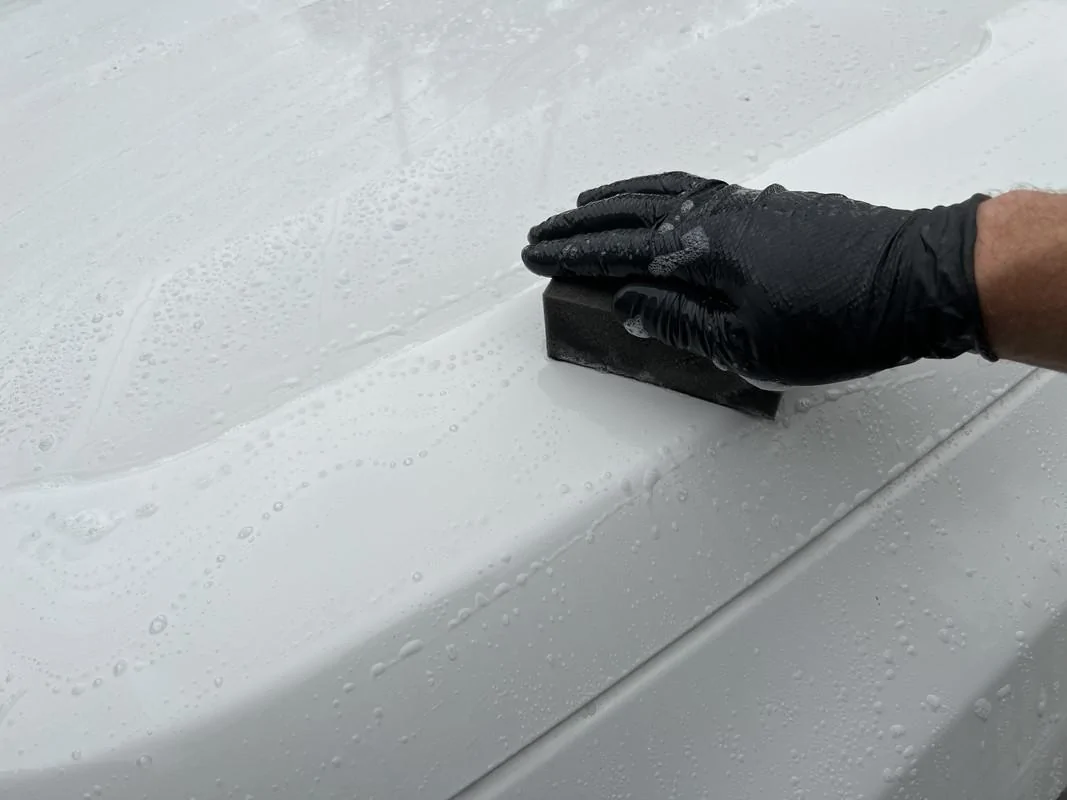

While these products are extremely effective, they only remove iron particles and won't remove all contamination. In other words, they are best used in tandem with a traditional or synthetic clay product. As in, apply the product, allow to react, rinse, then if the paint still feels rough, progress to using a clay bar or synthetic clay towel/sponge/mitt.
