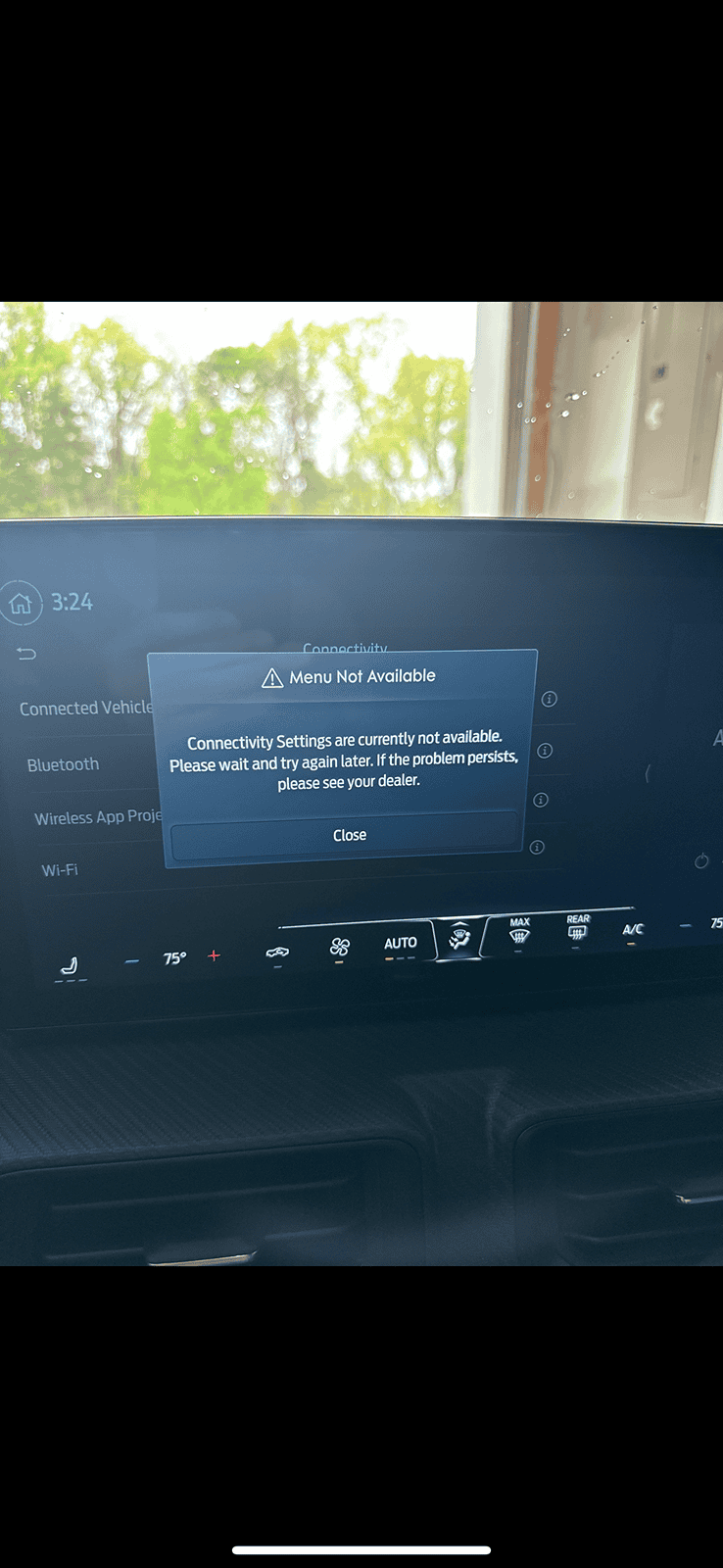

I’m reaching out due to persistent problems with my S650 infotainment system, which have been happening intermittently over the last few weeks. I am looking for advice or to hear if anyone has experienced similar issues.

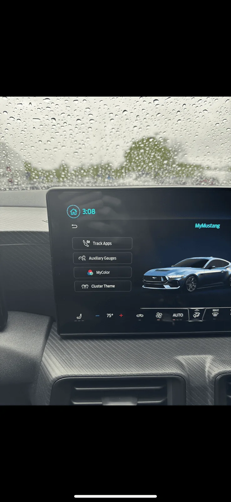

Initially, the issue manifested when I noticed the ‘MyMustang’ menu was missing the custom mode profile option, and I couldn’t access the WiFi menu or update settings. However, the Mustang app on my phone still worked for remote operations.
After these issues first appeared, I took the car to the dealership. They briefly checked it and claimed everything was fine, but the issue reoccurred right in their parking lot. A service advisor witnessed the problem, and as I was explaining the issue in depth, the connected services resumed, and everything started functioning again. He was as puzzled as I was, but said it should be working now, so I left. The next day, the problems returned.

A few days after these steps, the system updated itself, temporarily resolving the issues and adding the classic gauge cluster to the display options. However, today, the same problems have returned.

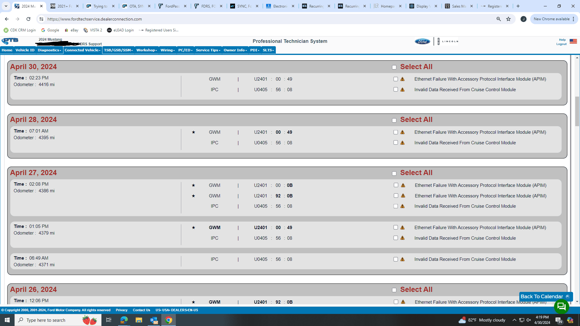

Open fuse box in passenger side interior …remove fuse #8 #31 for 10 minutes put them back ..start car should fix connectivity issues with WiFi,Myford etc..custom
Mode should come back up
Seemed to work to get things reset for a bit. Problem reoccurred during the next start.
