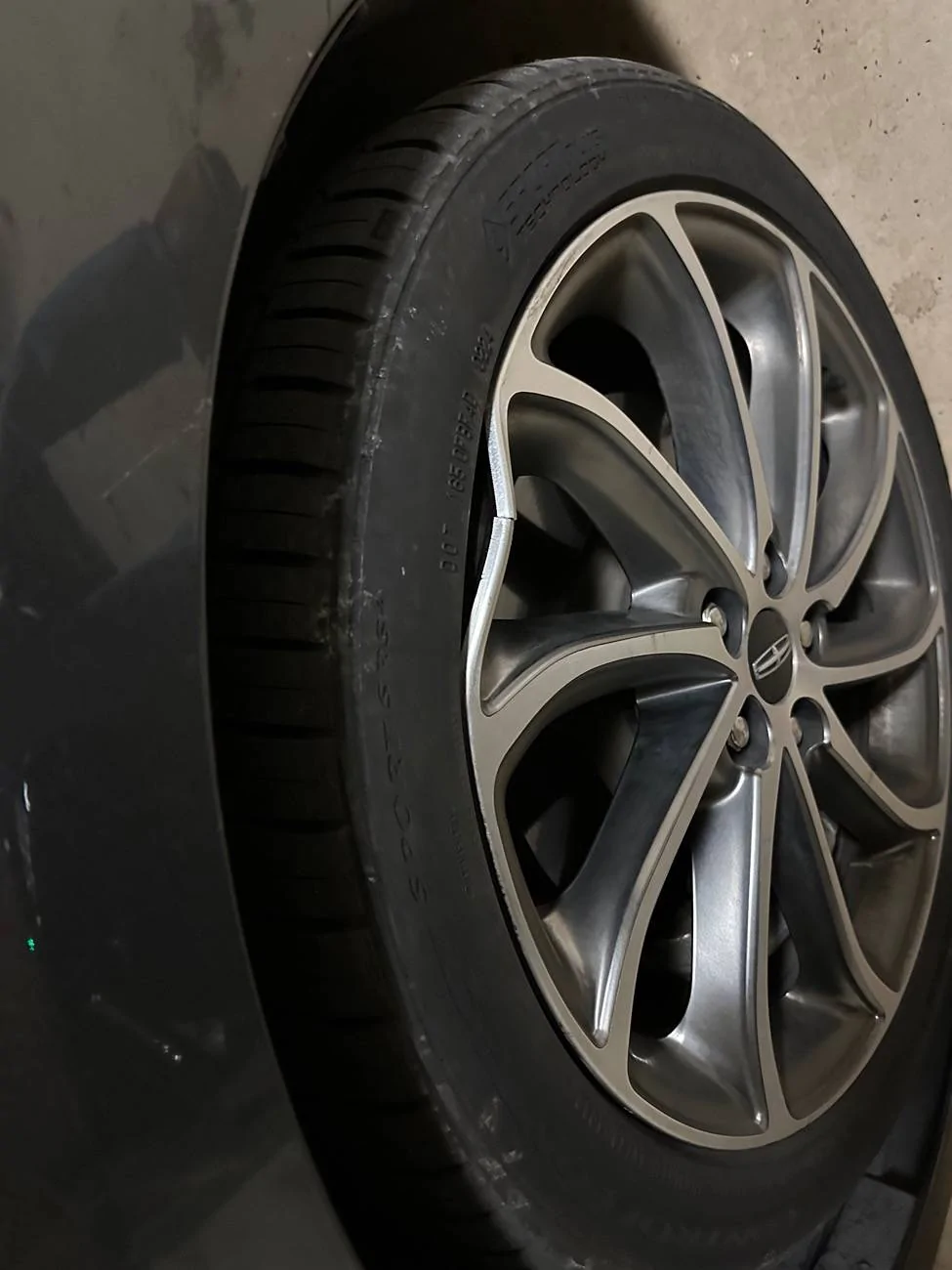

This is what happened to my wife’s Lincoln in a construction zone around San Antonio. A pot hole crater strike at 60mph. Tire pressure was around 36 psi. Despite how it looks, this held air.
It was a pretty penny to replace and the ride was compromised after this, you could feel the vibes in the steering wheel and throughout the car subtly. These are 21’s IIRC
Looks like a pretty tough wheel 🛞!
Even if it held there, I don’t think it’s serviceable.
I hope your insurance covers the cost of the Wheel? Of course , minus your deductible. I don’t know about Michigan roads, but I can tell you Colorado roads around the suburbs of Denver are horrible. .
