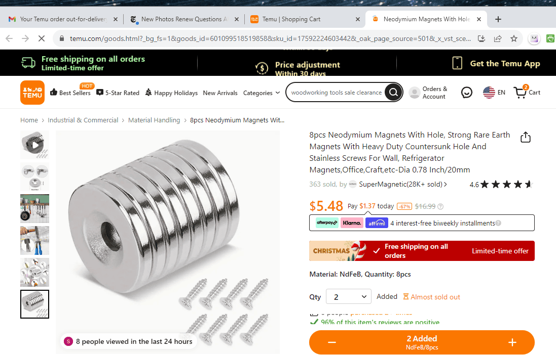

I’ve had an ongoing problem with the seatbelt retention strap (on the seat back) coming loose because the magnet is too weak.
I found that the attached inexpensive magnets are significantly stronger. I thought y’all might benefit from my experience.

Same boat here... Where is the attachment?

I posted this before, but it bears reposting. Home Depot sells rare earth magnets (very strong) about dime size in packs of 4. One kind is just a flat disc, another kind looks like a bolt washer. Get one pack of each. Figure out the polarity and use one of each, washer type towards the dimple. Problem solved.

I looked at your other post on the HD magnets.. a couple different sizes and strength of each. Can you confirm it is the 3/4 "washer" and 0.47 inch disc from HD? Appreciate the insight, the seat belt issue driving me crazy
The ones I bought are
- 5pack Magnet Source 07528 .75in x .06in disc
- 3pack Magnet Source 07091 .74in OD x .375in ID x .105in Thk "ring"
