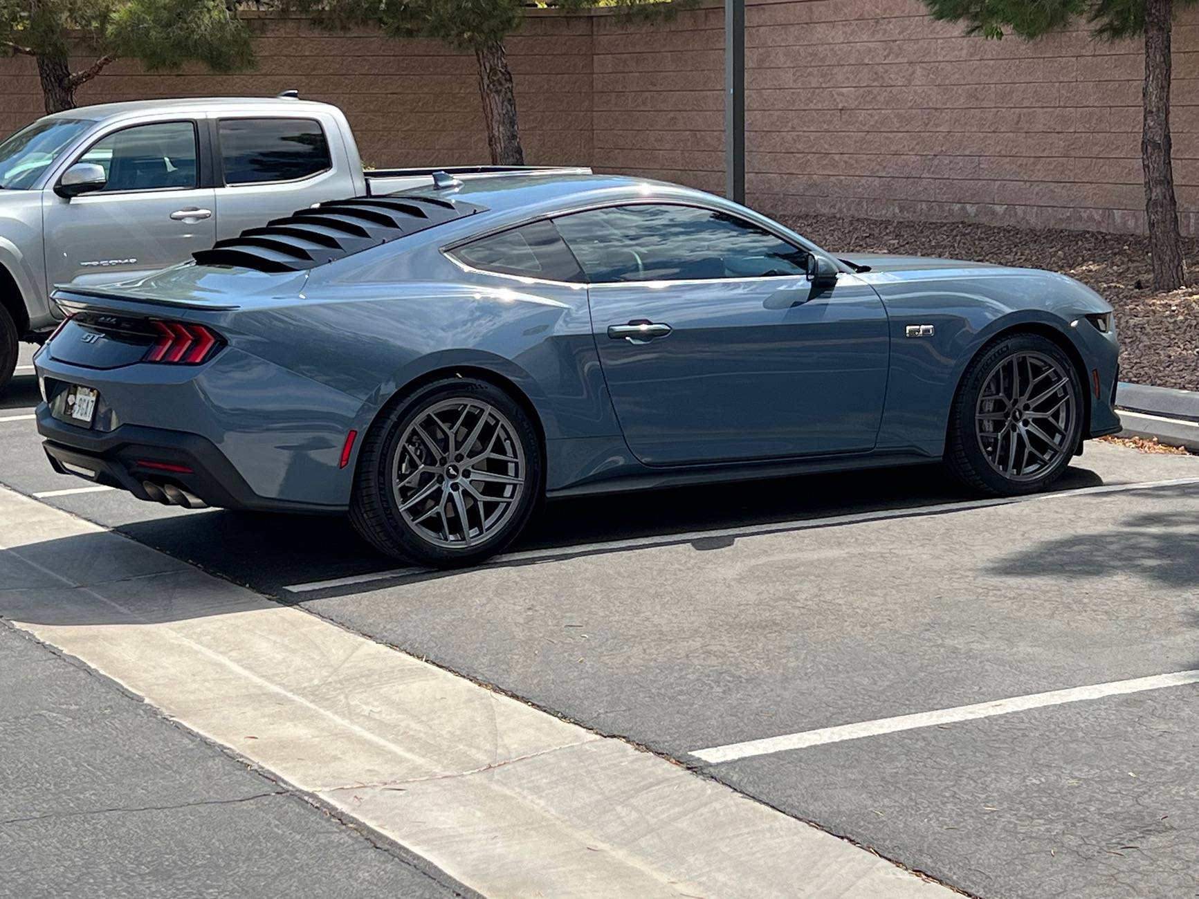

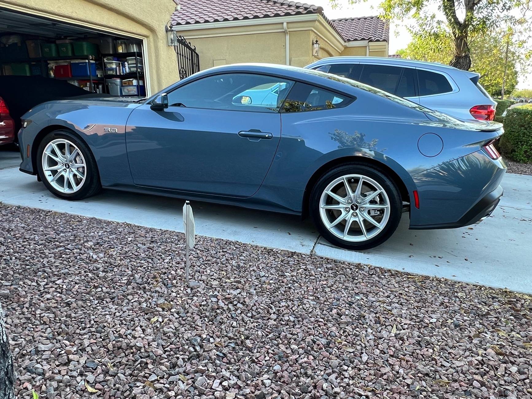

Before and after, Steeda Trident 20" 10/11 Michelin Pilots 275 and 305 no modifications.
S650 Mustang Upgrading wheels and tires for performance IMG_9119
S650 Mustang Upgrading wheels and tires for performance IMG_9047
