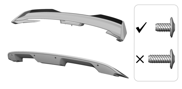

If you’re going to the track, then “buy once, cry once”. If you’re just buying it for looks:
Don’t.
Straight from the owner’s manual:
"The rear Gurney flap must be removed for on-road driving.
Your vehicle may include a removable Gurney flap in the luggage compartment. The Gurney flap greatly enhances high speed stability and performance on the track. It is recommended that you use the Gurney flap at all tracks featuring high speed corners and can be used at any track regardless of cornering speeds.
You could benefit from the removal Gurney flap to improve low speed balance on smaller tracks with maximum cornering speeds below 70 mph (112 km/h). We recommend that you attach the Gurney flap for all track events and carefully assess both the vehicle's condition and your capability before removal.
S650 Mustang Wing flap gurney ? {filename}
Note: The Gurney flap comes with longer size bolts to install it onto the rear spoiler. Do not use the longer size bolts without the Gurney flap attached or damage to the spoiler may occur."
Don’t.
Just out of curiosity does anyone know WHY Ford recommends the removal of the gurney flap for on road use? The way they word it almost makes it sound like it isn't street legal for some reason.
Outside of maybe eating at fuel economy a bit I can't see it making any changes to street driving and handling that would necessitate its removal for regular road use.
drag and mpg decrease other than that i drive with mine all the time no issues.
