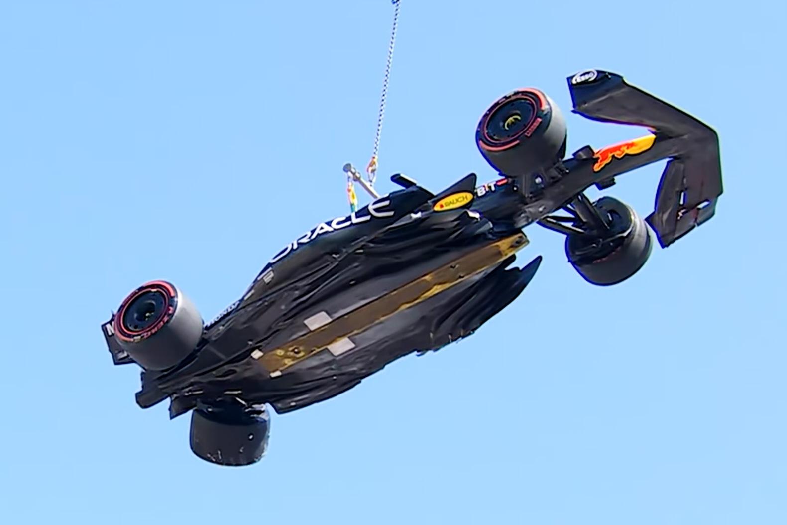

Underbody strakes are aero bits mounted to the floor to channel flow. Not sure how much of an effect on aero it will have here but in F1 for example the floor is responsible for most of the downforce. You can see an extreme example of the strakes on this floor shot below:

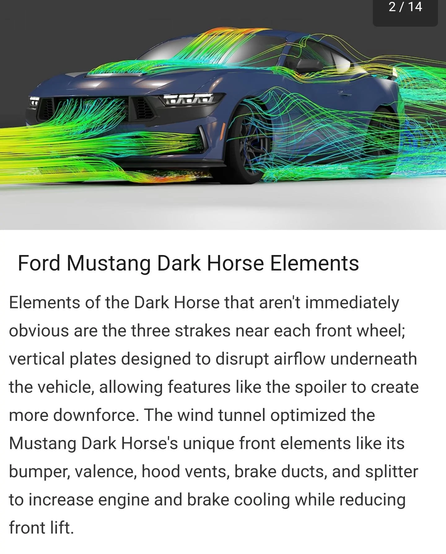

Found this in the wind tunnel article posted a while back:
S650 Mustang 2024 Mustang PDI (Pre-Delivery Inspection) Checklist Released Screenshot_2023-07-24-14-55-43-56_40deb401b9ffe8e1df2f1cc5ba480b12
So it looks like it'll be 6 stakes, 3 for each front wheel. Nothing in the article about anything further back.

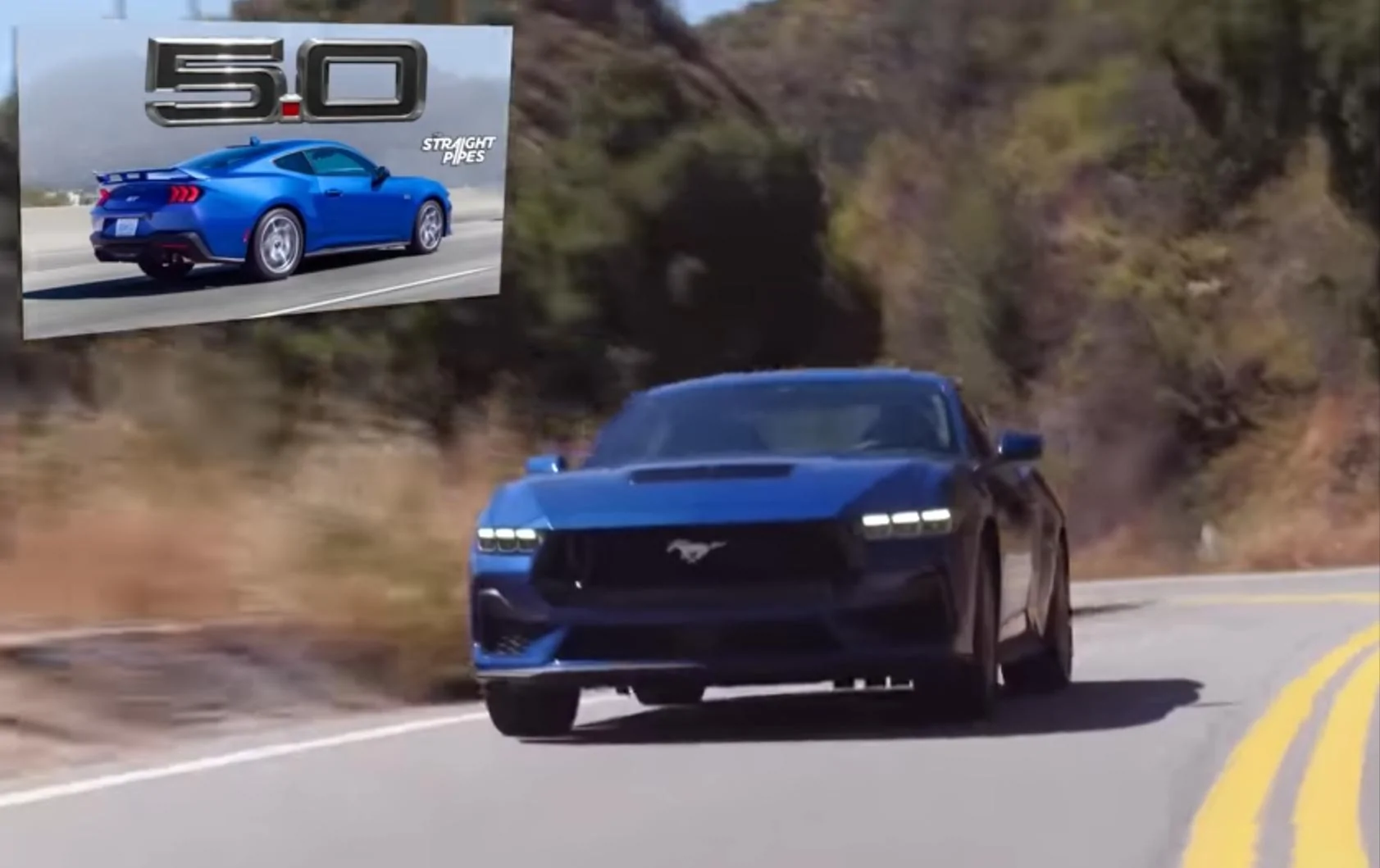

That's why I want to know what does it mean for the Performance Pack GT / Dark Horse. I saw them on a few of the reveal videos but there was not a clear picture so was not exactly clear what are they. Very curious to learn more.
Caught a pic of them in The Straight Pipes EB review. They showed a preview of the GT vid where you can kinda see them.

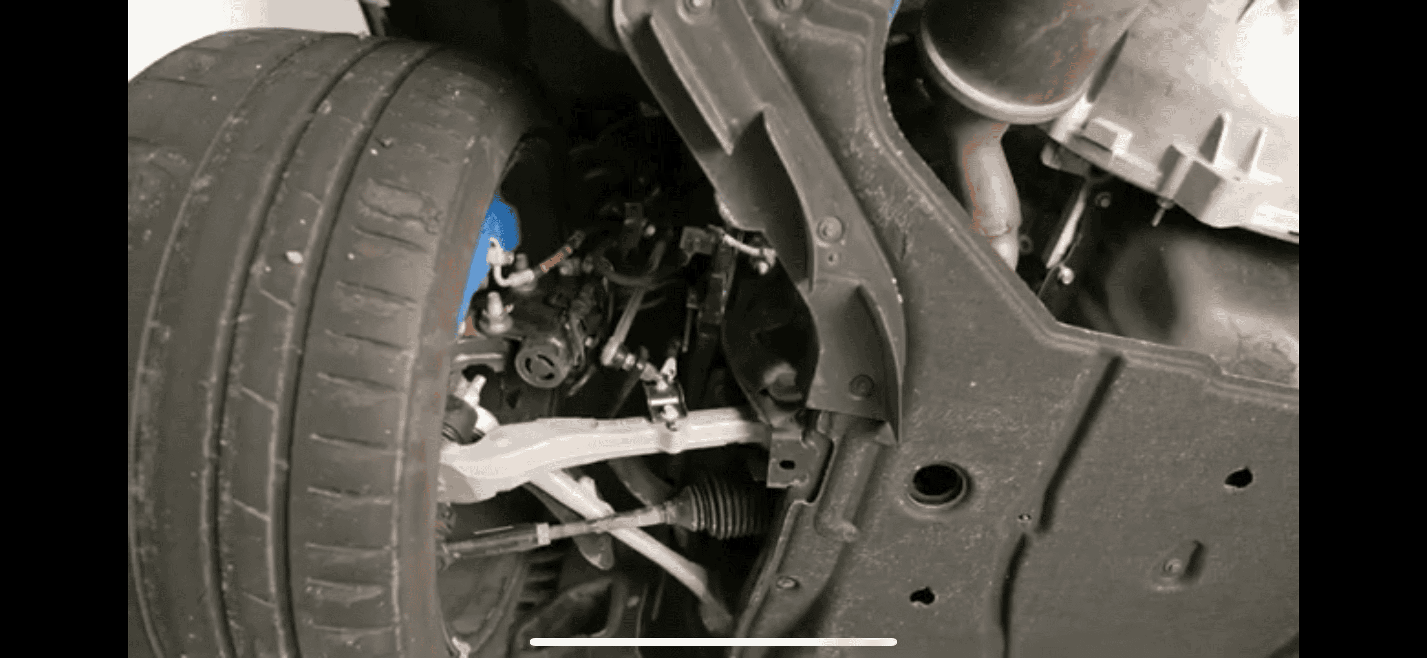

I grabbed this screenshot from the savage geese dark horse video.

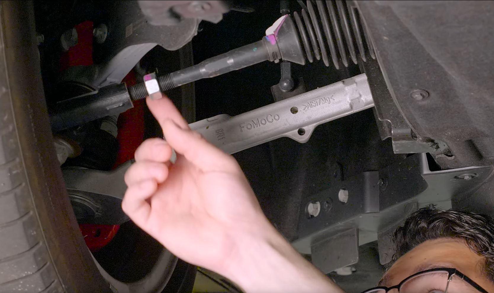

Things to check are worth adding to this topic, instead of information being fragmented all over the place in random topics.
From a Savage Geese video.
S650 Mustang 2024 Mustang PDI (Pre-Delivery Inspection) Checklist Released Tie Rod Ends.JPG
Check tie rod lock nuts, both sides.
How this slips through QC is unbelievable. :lipssealed:
