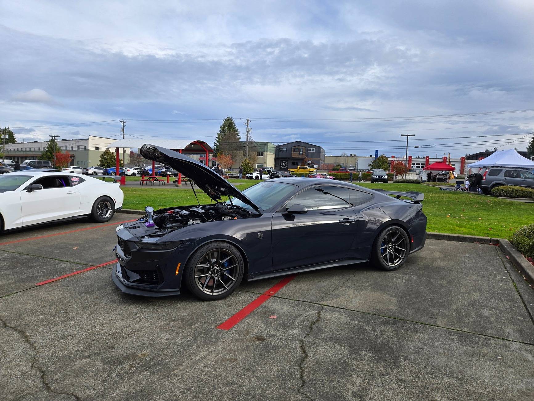

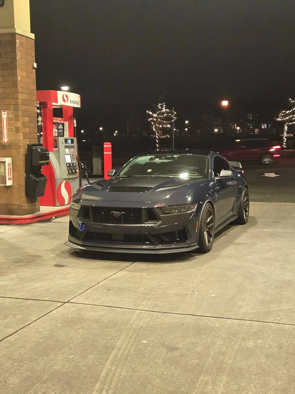

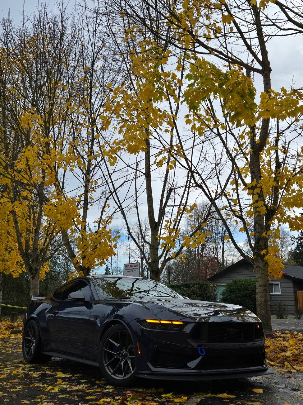

I have a DH with HP aswell, Here is what I went with and it fits great.
Stock rims are 19x10.5 and 19x11
Stock wheels 305/30R19 and 315/30R19
On the stock rims
285/30R19 and 325/30R19
MICHELIN PILOT SPORT ALL SEASON 4 ZP
Fits perfectly, Doesn't rub on fenders or inside the wheel well, doesn't poke out handles great in the rain and does great on track wet or dry.
Also has been handling great in current Seattle's icy weather.
This is the best option without buying a new set of rims.
