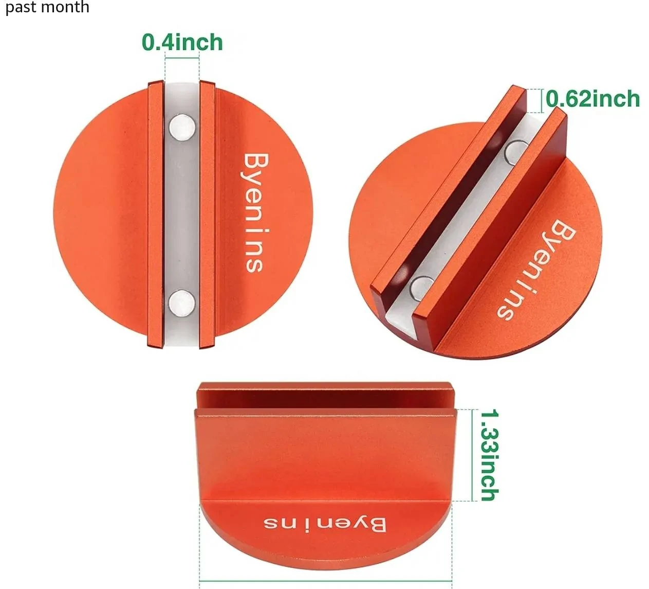

If you want to jack it under the pinch welds, there are quite a few options on Chinazon for jack pad pinch weld adapters.
IMHO, I know you want to save weight, but 11 pounds for the Steeda full length jacking rails will make life much easier and far less susceptible to damage.

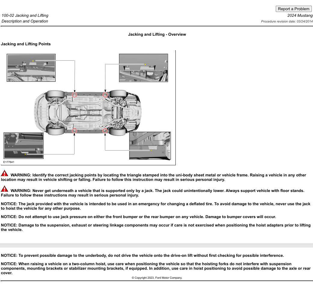

I am somewhat in the OP situation. So I have aluminum pinch weld gizmos installed and they work well for jacking the car up. My question is, ok once the car is jacked up, where do I place the jack stands?
3,119
3,373
I posted the pic of the manual with the jacking and lifting points identified.
"WARNING: Identify the correct jacking points by locating the triangle stamped into the uni-body sheet metal or vehicle frame. Raising a vehicle in any other location may result in vehicle shifting or falling. Failure to follow this instruction may result in serious personal injury."
If you don't want to use those, put them wherever you want. Your car.
