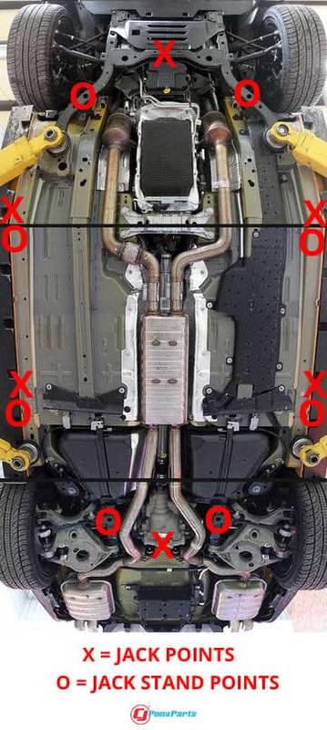

I posted the pic of the manual with the jacking and lifting points identified.
"WARNING: Identify the correct jacking points by locating the triangle stamped into the uni-body sheet metal or vehicle frame. Raising a vehicle in any other location may result in vehicle shifting or falling. Failure to follow this instruction may result in serious personal injury."
If you don't want to use those, put them wherever you want. Your car.

This picture may help. Good luck.
