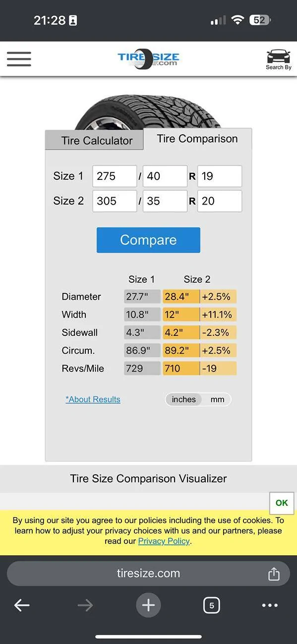

If I go from from my 275/40/19(27.7 inches tall) to a 305/35/20(28.4 inches tall), how much wheel gap would be removed without adding springs?

Go to tirerack.com and look at the diameter difference of the two tires.

It’ll mess with these settings, but not to the degree you are worried about. Plenty of people have gone from 19 inch to 20 inch and lived long lives. The magic number to aim for is 3% difference diameter and this change falls within that. Would barely notice a difference, and if you do want the computer to know, one can always take the car to the dealership and ask for them to reprogram the ECU

That size tire is very common on mustangs... will change speedometer a bit. At 0.7" bigger diameter will add 0.35" in the wheelwell, and 0.35" increase in ride height.
So with just your tire idea the delta in height is 0.7 inches.
That means you will close less than half an inch of wheel gap; 0.35 above the axle and 0.35 below the axle. That is not much of a difference in closure from an aesthtic standpoint.

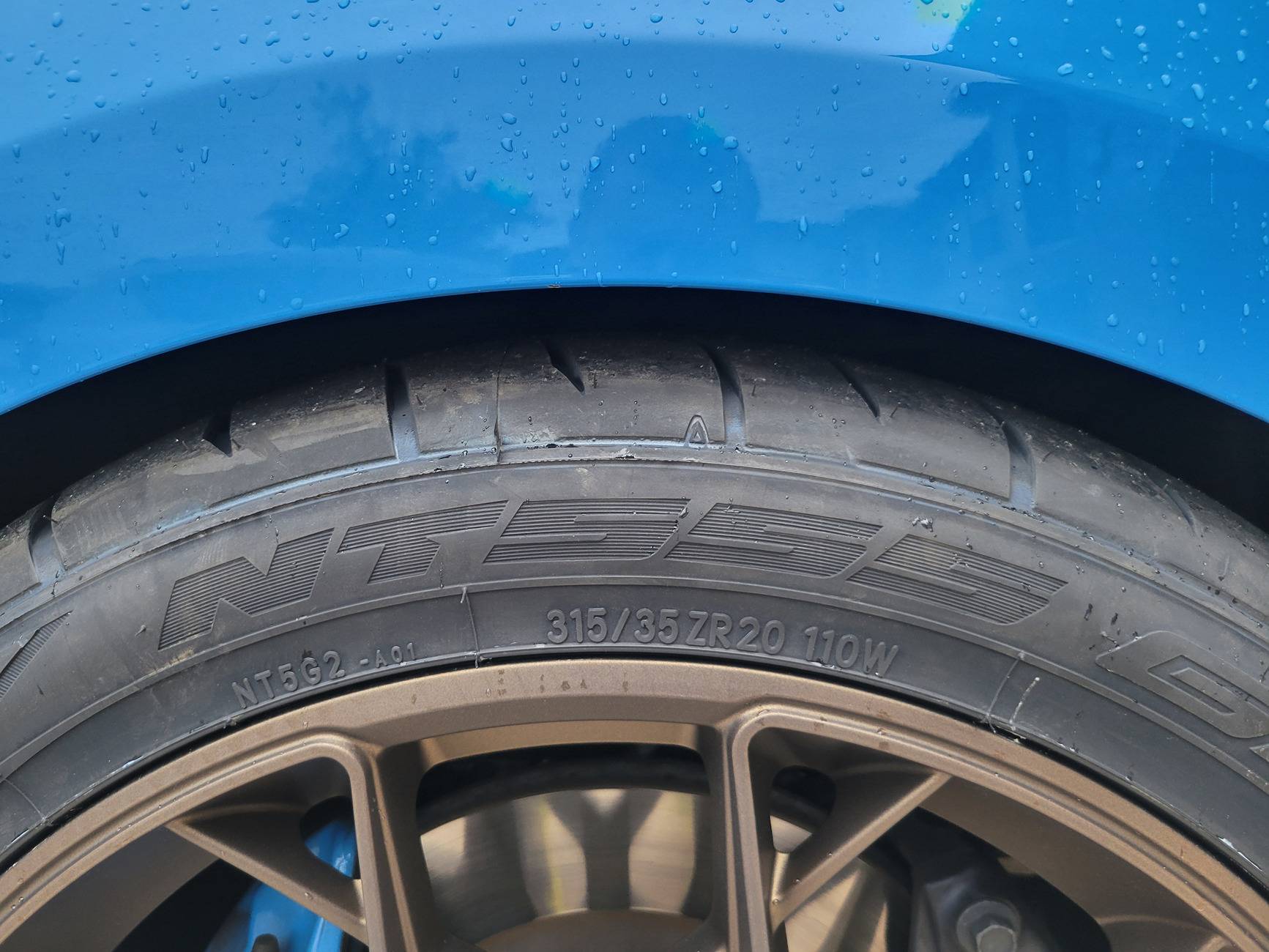

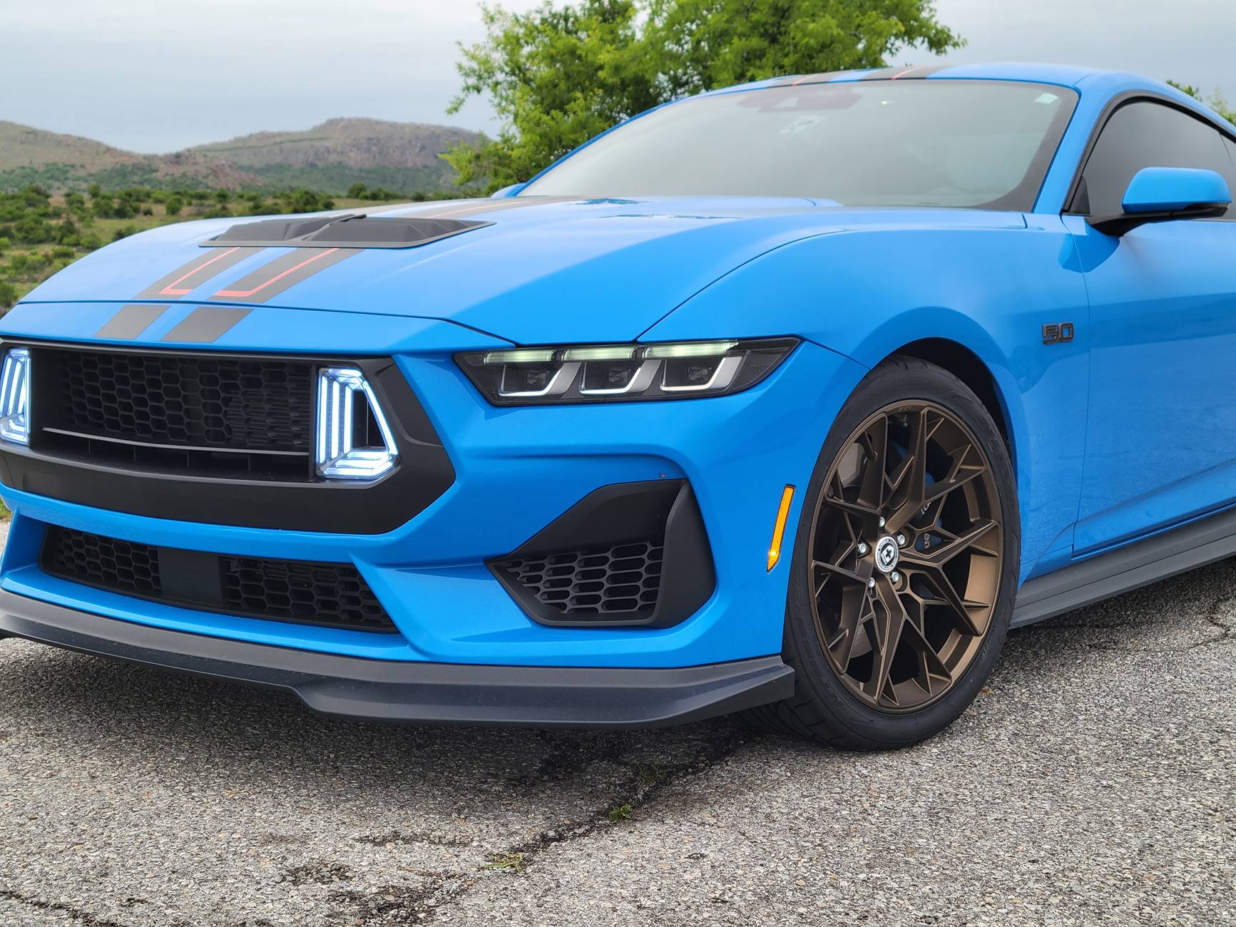

I've got a Dark Horse with handling pack and have done fairly annoying and exhausting research on this specific item on the mod list. I even exchanged emails with one of the Steeda suspension experts.
Long story short (and I'm paraphrasing here)
Doesn't matter whether you are a HP or a non HP your car will sit the same as a GT with the same spring/tire/wheel combo. Your front lip will be lower of course (cause the GT doesn't have that aggressive one the DH does) but the stance will be the same.
Joel (YouTuber) has a GT Premium and is running
285/35R20 FRONTS
315/35R20 REARS
AND he's using Steeda Magneride Sport Progressive springs.
His stance is pretty solid. Here; I'll timecode two fo the videos.
VIDEO #1 - Brandon is showing his dads car LOL
VIDEO #2 - Joel is explaining what his car has suspension wise
MUSTANG7G THREAD #1 (VELGEN WHEELS) - S650 YELLOW SPLASH | VELGEN LIGHT WEIGHT VF10
This is the setup that I am going with on my Dark Horse as I don't drag race or need something that allows me to get the hole shot in the 1/4 etc. The Sport Progressives are a nice street setup.
I believe it will only lower the front lip of the car by about 0.35" to max 0.4" which means I should still be able to get over the speed bumps in my neighborhood (we have a calmed neighborhood lol).
