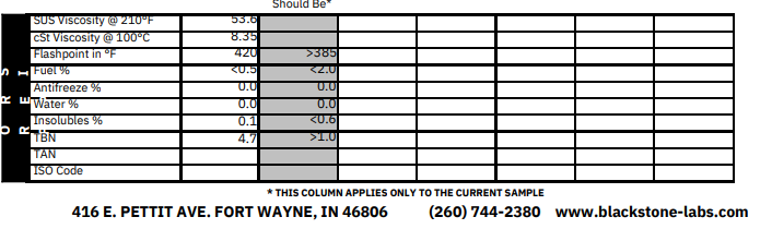

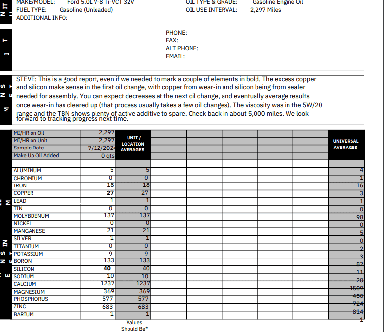

So i performed my first oil change today. Oil looked great. Odd looking black Ford Motorcraft filter was on from the factory. I did the work on my low profile Rhino ramps which made it tight under the car when trying to turn my body around. Electric ratchet made the 15 7mm screws easy. Push pins a PITA even with the correct removal tool but I have an Amazon kit that had the sizes I needed.
I used Pennzoil Ultra Platinum Plus and a Motorcraft filter.
No BBQ tick as far as I can tell.
I'm sending a sample to Blackstone. I changed at 2,223 miles which is longer than I would have liked but life got in the way.
Next time I'm going to install my jacking blocks and use them as it's too tight under the car when it's on ramps. It was so freaking hot and humid today I couldn't wait to finish up.

So here is the promised follow-up on my first oil change.
No BBQ tick.
Here is the report.
Comments?
