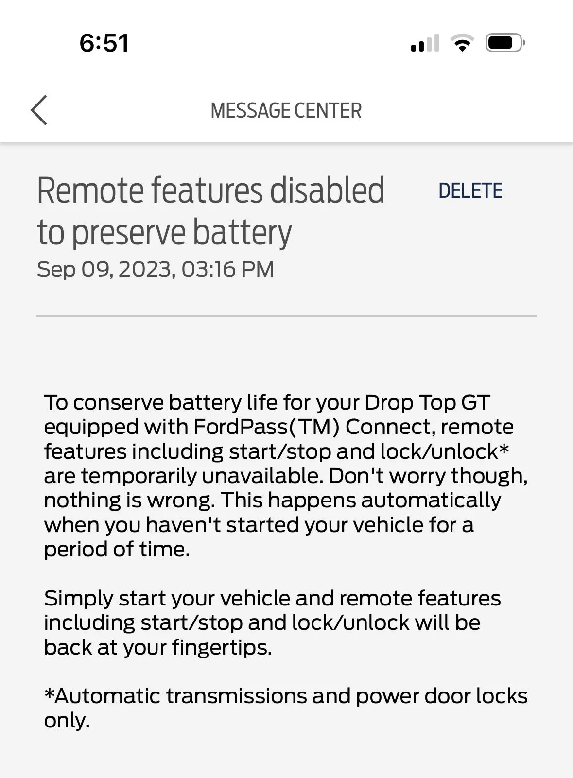

Has anyone else gotten this warning?

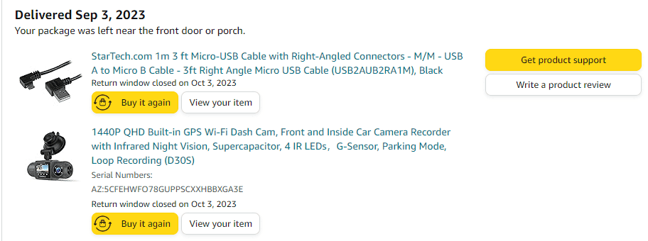

I installed a dash cam powering it off the USB. The only problem I ran into was it wouldn't turn off with the car all the time even after the car had been off for hours. I was going to return the camera even though it was more of a car issue after I tested the port with my phone charger but as a last ditch effort I eventually set the dash cam to use motion detection and it has been fine ever since. There is a warning that using the feature may cause the dash cam to stop recording but that has never happened and it still keeps recording for a while after I'm parked.

I have a dash cam installed to the USB port in the rear view mirror. I’m not sure if that port is on switched power or not. Wondering if I need to unplug the thing every time I get out of the car. This is the first time I’ve gotten the warning. I’ve had the dash cam about a week. I had a faraday pouch in my pocket next to the key when I got the warning if that matters. The spare is always in a faraday pouch. I’ve been driving the car almost every day.

Yes, it has been off every time I get in the car the next day since turning on motion detection. I also haven't gotten any battery warnings from the car since turning on motion detection. I'm not sure how long it stays on after parking now though. Probably just a couple minutes. This is the combination I'm running. I wanted a right angle cord being the USB port faces straight down but I couldn't find a shorter right angle cord at the time so I have excessive slack I still need to find a way to secure. 1 foot may be too short as well depending on where you want to mount. The only thing I don't like now that I have the settings adjusted is remotely putting the videos on my phone through the app. It usually just doesn't work. I would plan on removing the SD card from the camera to pull any videos off of it. Not the end of the world as I probably wouldn't pull any video unless I was in a wreck or something.

I didn't even care about cost honestly. I was trying to find the nicest thing I could that still used a regular USB port. All the higher end stuff I was able to find used Micro USB instead rendering it incompatible with the port in the car. For example, every 4K camera I looked at used Micro USB and I didn't feel like hard wiring. I did notice the other day it was still on when I left the car for about 30 minutes so it will cover you on a grocery store run or gas station stop in case anyone bumps into you or messes with the car while parked.

Dash Cams are meant to also record when parked, therefore the USB port is always powered.

I leave mine plugged into the mirror and leave radar detector in the 12 volt power point and don't unplug them ever. They power off when the car goes to sleep after about 30 minutes.
