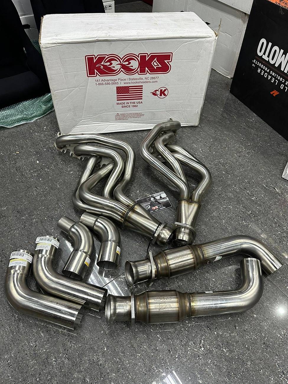

Purchased both of these thinking I would have 3” all the way back. No!!!
Shop just called and said from the Kooks LT with the high flow green cats that they do not connect seamlessly at the mid pipe. Said there is the factory pinch down to 2” I gotta deal with. Only solution is custom fab from a muffler shop.

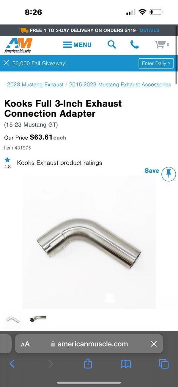

The kooks has 2 different options, connect to factory with the 2 1/4 neck down or 3”
You maybe just need a pair of these in the pic.
Thank you so much for sharing!! This looks promising. Already emailed shop. Will report back with results. Cheers!

$63 though? Better than having to pay to get it custom fabbed, for sure.

If you ordered the Kooks setup with the 3" connection there will be some modification needed for it to mate to the Corsa catback. The Corsa catback is designed to fit the stock connection point after the cats. It comes with adapters that will mate using the stock clamps. Really just depends on which headers you purchased.

Bought the 3” Kooks connection adapters and they worked great. Almost a little short but work. Crisis averted haha.
