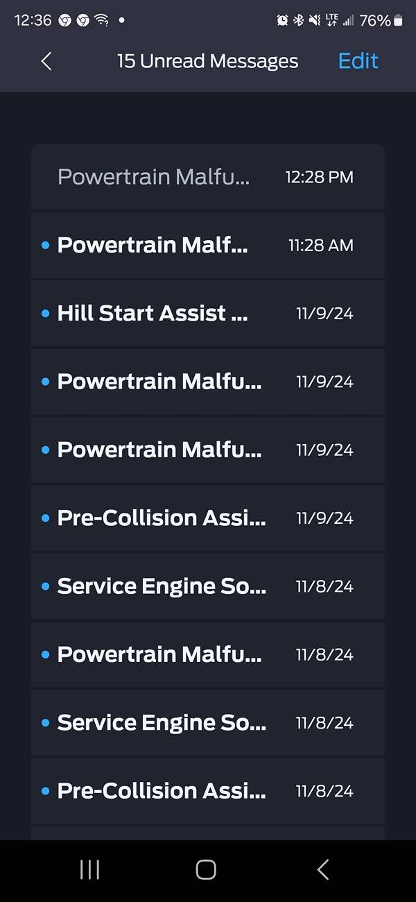

This is my exhaust system, 1 7/8 headers from kooks, x pipe and flowmaster outlaws. Dron 1800-2000 rpms. Cleared the cel with spacers. When I drive the least bit aggressively I get service engine and different types of failures from the ecu. Upon restart they all go away and no issues, any advice?

What's codes does it throw? Cat inefficiency?

Try a different set of ‘spacers’?

I think it might be the battery I'm going to hook to charger / maintainer and might put an optima dh6 in it.

I am also taking your advice and ordered the vibrant 19019 and 19999 parts, this one seems to have success in the forums
