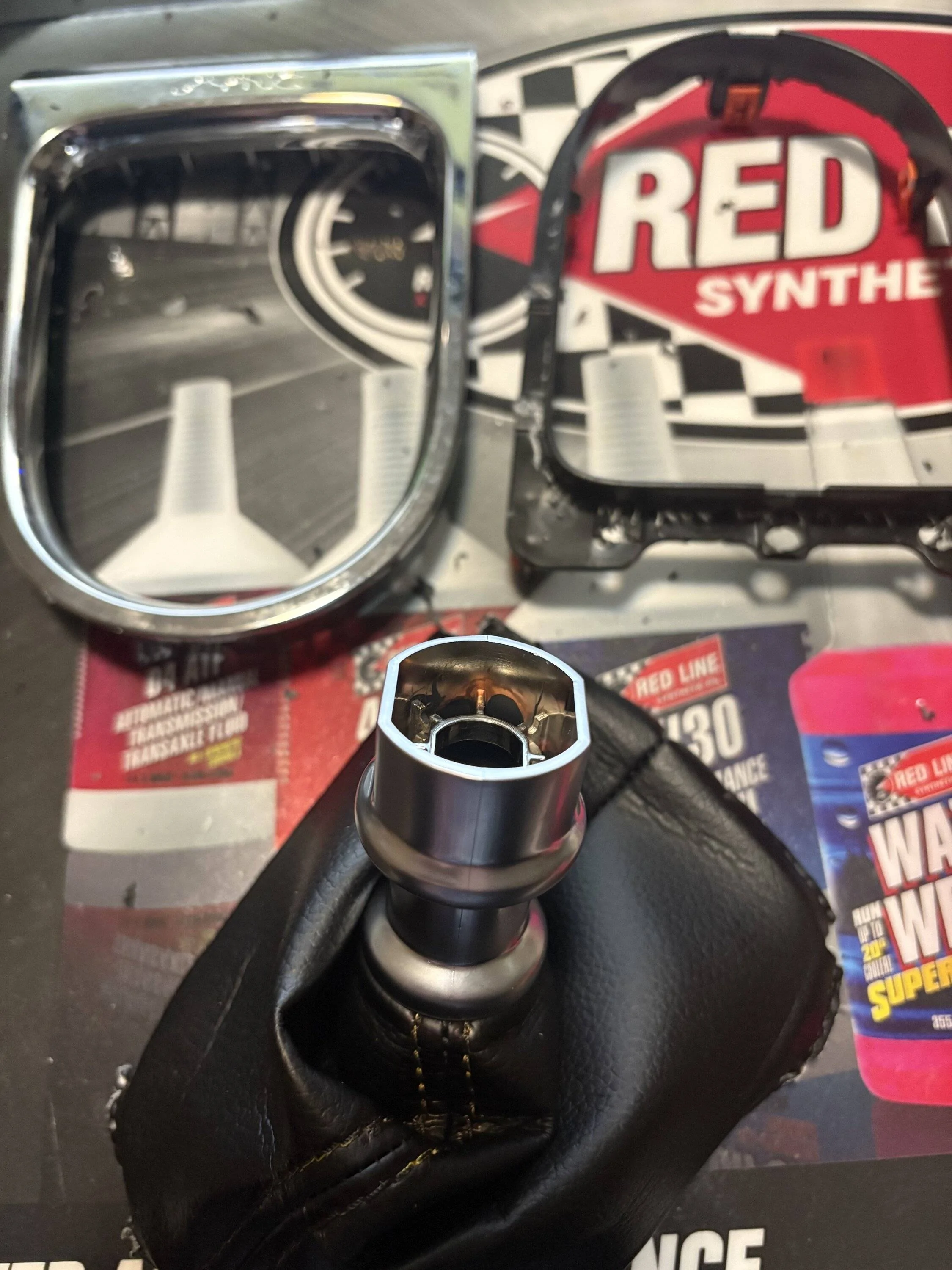

So I bought Billetworkz auto trans shifter balls for my Dark Horse and S550. To finish the look I also bought the manual transmission trim pieces and boots. I also bought real leather boots from Redline Goods. To install the boot, you have to separate the two pieces of plastic that it is sandwiched between. They plastic welded and glued. I used a spot weld cutter and a box cutter to get it apart. Here is what the S550 one looks like, but the process for the 2024 is the same just a different shape.
