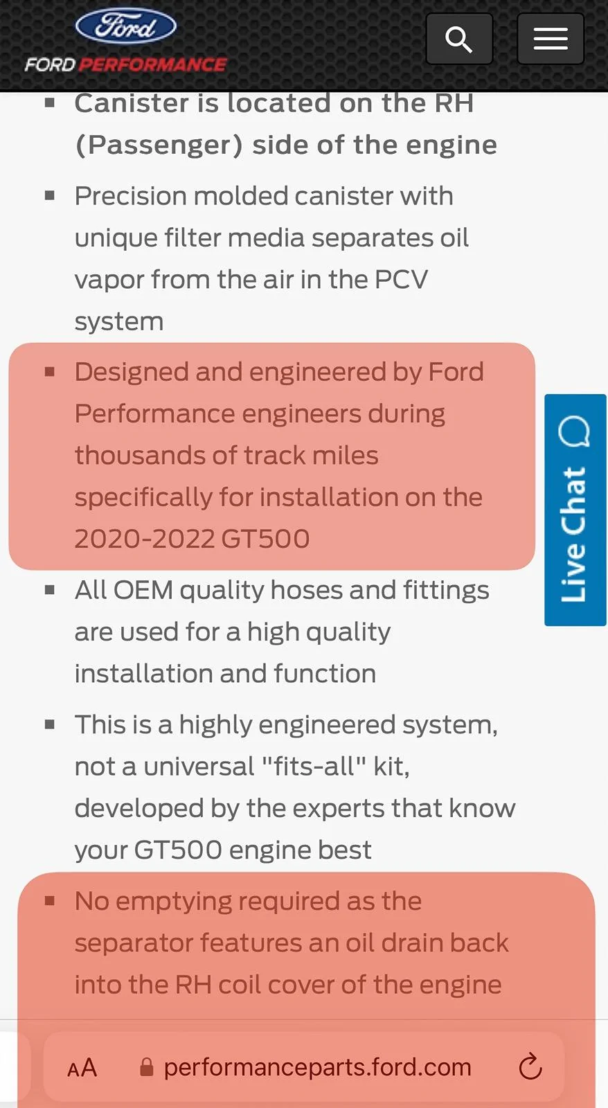

Although, there are some separators that drain back into the ‘system’.
https://performanceparts.ford.com/part/M-6766-A52

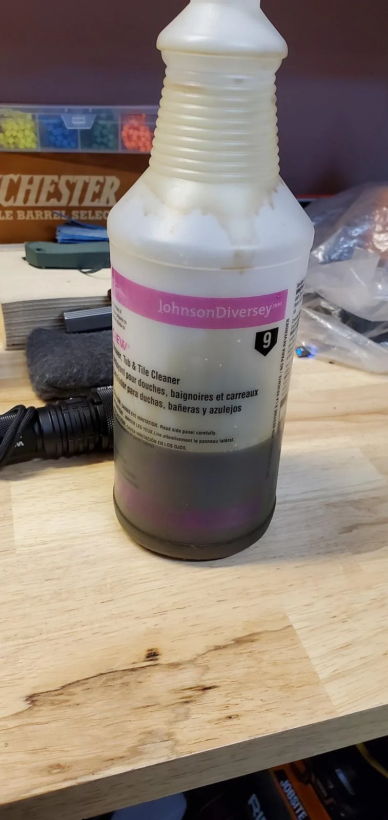

agreed, it shouldn’t be collecting alot, although driving methods may play a part, and completely agreed the intake is not the preferred place.
however,

I have had a catch can on my 2011GT since new and have kept any oil that was ever emptied from it. It has 25k miles. My 2024 will be getting one as soon as it comes from UPR.
S650 Mustang Oil Catch Cans 20240528_134951
