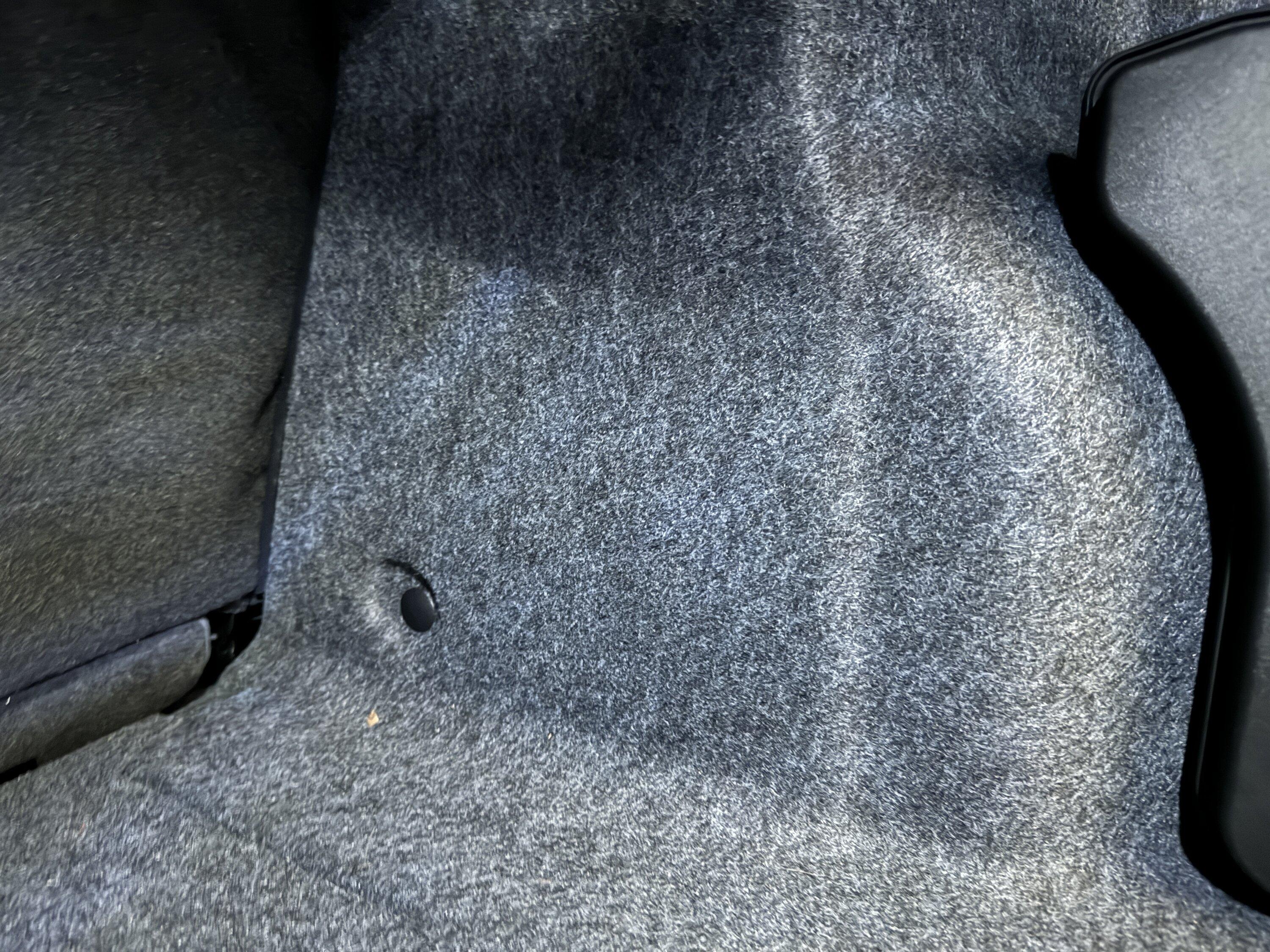

After riding in the back the noise is coming from this area. Sounds like a loose screw or someone left a tool. I’ve had this area apart before and nothing stood out but it’s definitely coming from here.

If you find a tool in there, it's almost certain to be a 10mm socket !

My particular issue isn’t the rear seat latch, I did try the tape on the latch. Mine is coming from the wheel well area. I haven’t had a chance to remove the tire and check behind the cover though.

That's exactly where the noise comes from in my car as well!

I did that too... I'd love if you found something, but I removed both rear wheels and looked at both sides of the car behind the wheels, and nothing looked/acted different. 🤷🏻‍♂️ It seems it's behind the cover you showed in the picture, but it sounds like you didn't find it there either. Totally baffled.
