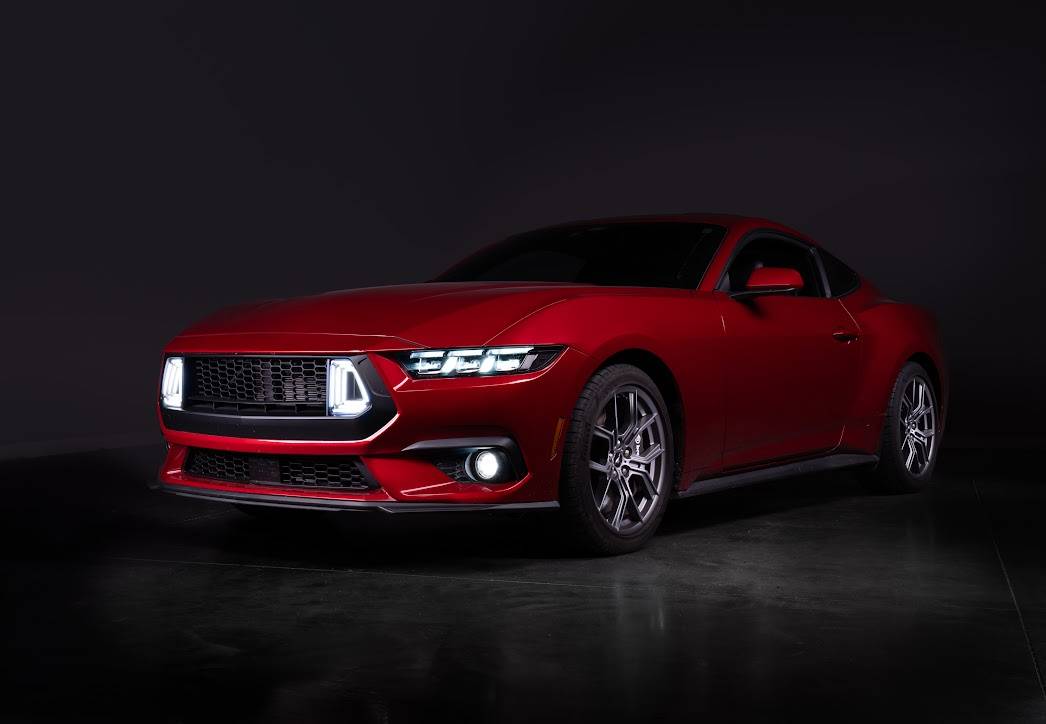

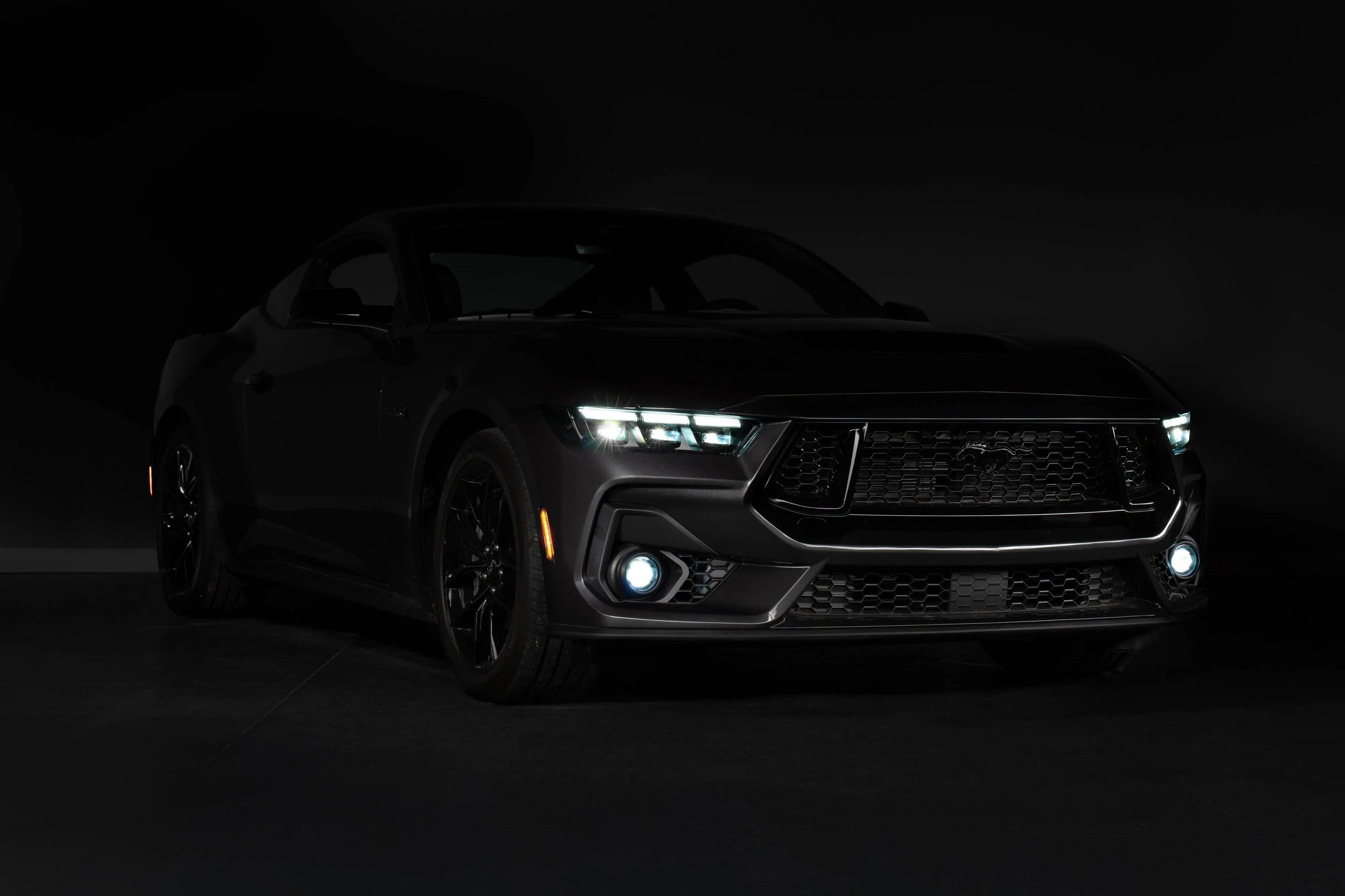

I saw the video on Social Media, and I like the idea of adding fogs. but I'm worried about blocking the oil cooler on the PP cars...
The PCM is located behind the passenger side closed vent is that going to cause issues?
Thank you for the question!
This fog light kit is designed and approved specifically for street driving, with integrated venting to maintain sufficient airflow to the oil cooler. During our testing, we haven’t observed any issues with overheating in regular or spirited driving conditions. While the fog lights retain around 28% of the original grille’s openings, there's still adequate positive pressure to cool the area effectively for typical street use.
For extreme conditions, such as dedicated track days or extended high-performance driving, it’s wise to keep an eye on oil temperatures. In those cases, temporarily removing the fog light unit would maximize airflow. However, for street driving, there’s absolutely no need for concern—this kit is fully optimized and reliable for everyday performance on the road.

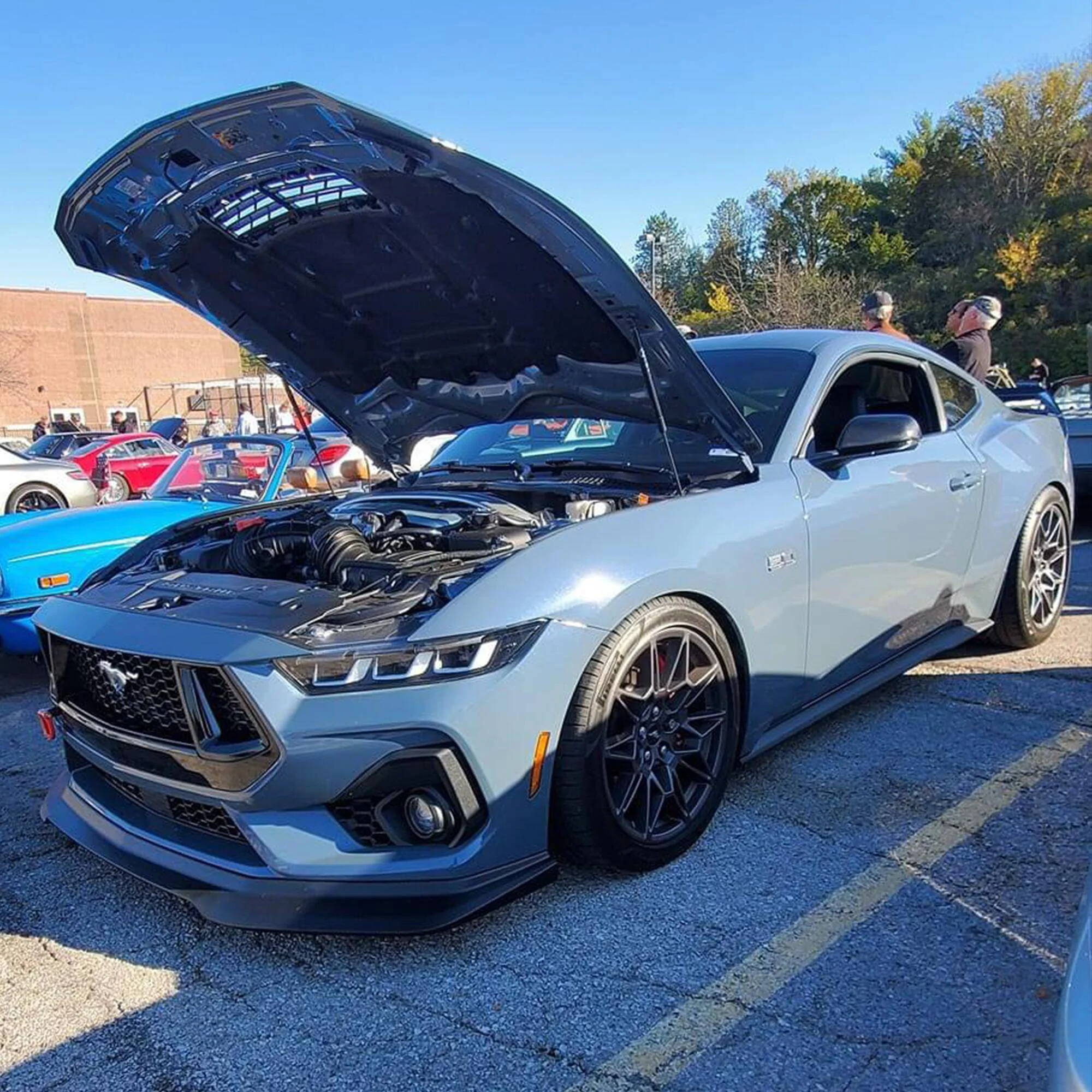

In fact, we've had a Performance Pack Mustang with this setup on the road for a month without any reported issues. So rest assured, these fog lights are ready for street use with no compromises on cooling.
Would like to see it on a stang first

Not to be an ass because its a nice product that solves the no fog light issue and i am really interested. Unless you are driving insanely hard on the street in most climates. You should really track the car properly before saying no issues. Yes i know most don't track their car but there are people who do and that is a large decrease in the opening for the cooler. There are those of us who live in hotter climates like the southern us. Just driving in traffic in Florida without the oil cooler I reach 230 to 238 degrees in oil temp, which is fine for modern synthetics for average use but I wont track the car until i get the factory or the mmr oil cooler installed.
