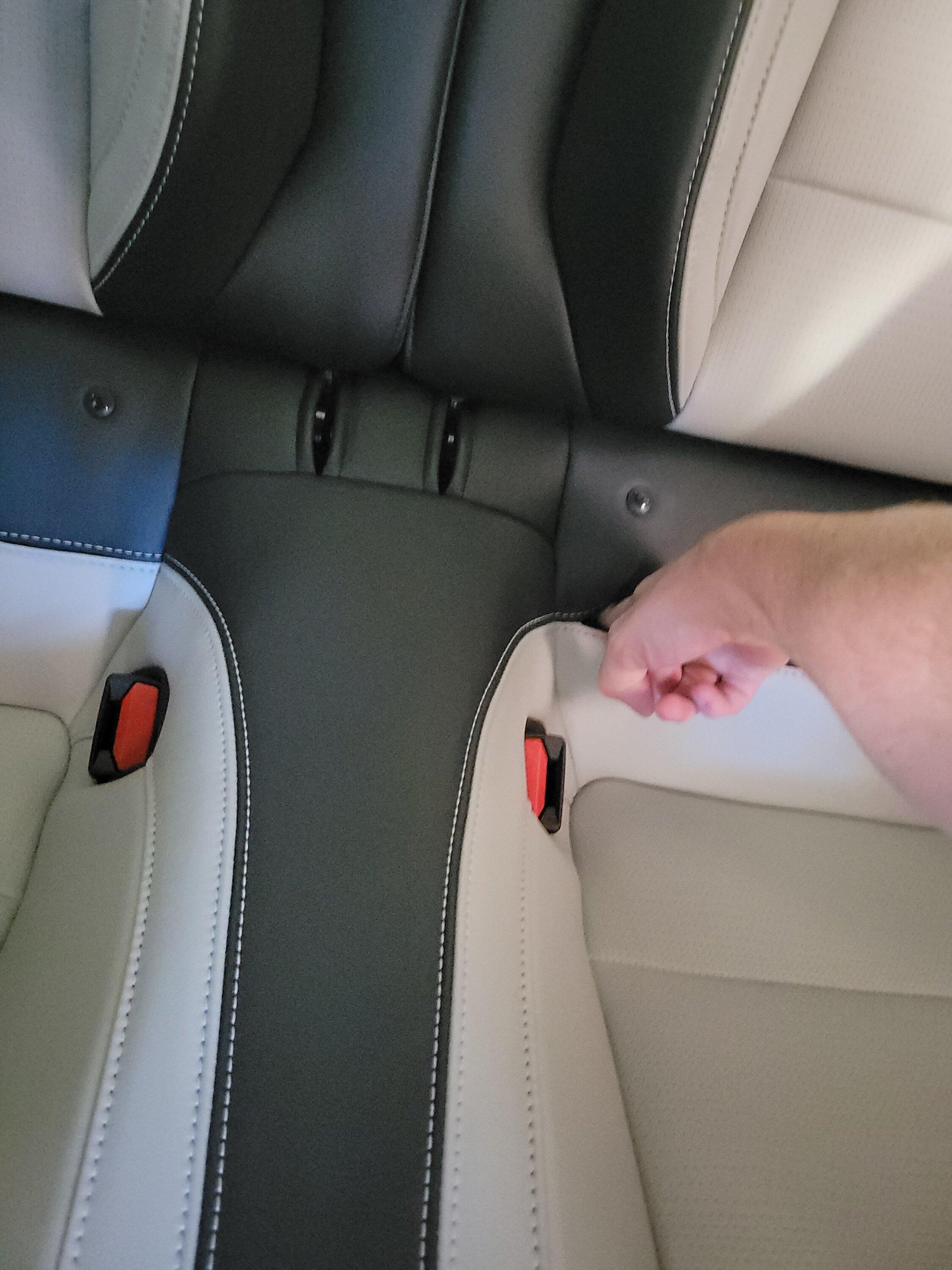

I give up. The manual is useless. Where are the back seat lower achors for a child car seat ? Do I need to ask the dealer for something?

this is for the rear?
They're on the floor?

No.. they're on the seat where his finger is i thought it was a tear in the seat then I realized the anchors are in it lol

Sorry: a little dense and confused today. He is pointing to the lower rear seat, right ? I don't have any slits/slots there ( convertible.) Looking for rear anchors for the car seat.

On The back of the seat you should see a little plastic button with a child seat on it, the slots are directly below those
I just went through looking for these to install a Love the Drive wind deflector. Checked their instructions, the Ford manual, and watched a couple of videos, and had given up until I found this thread. The Ford manual says that they are between the seat back and seat bottom - not in the convertible. The slits where the latch points are situated are impossible to see unless you open them up with up with your hands.
