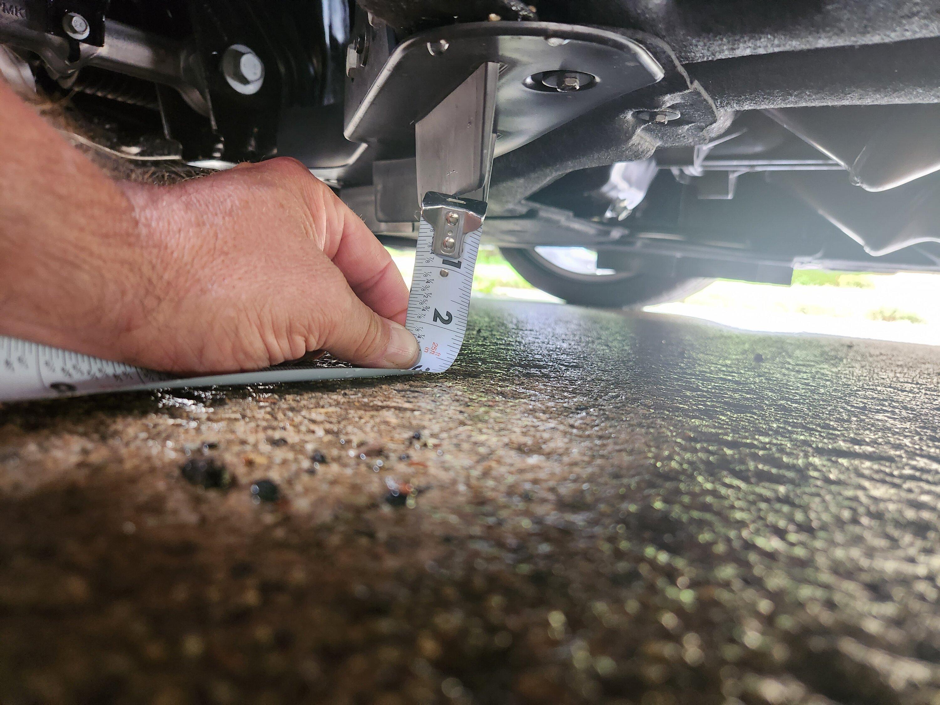

By the way...on my DH the clearance from ground to strakes. About 2 3/4", yikes

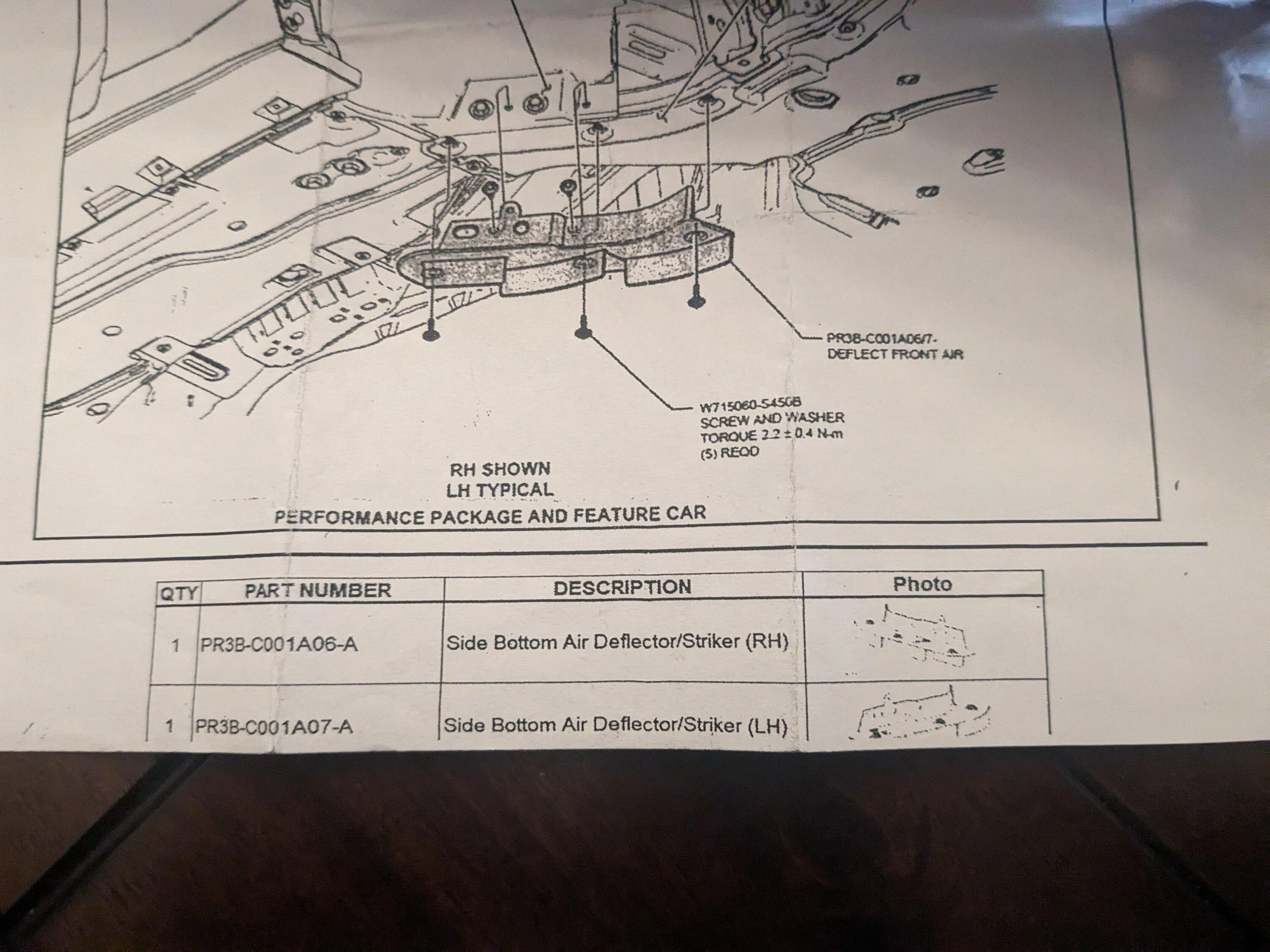

Mine were not installed... Also had over 50 miles on it. The instructions were printed opposite of paper orientation so the bottom was cut off and there is a lot of blank paper to the right.

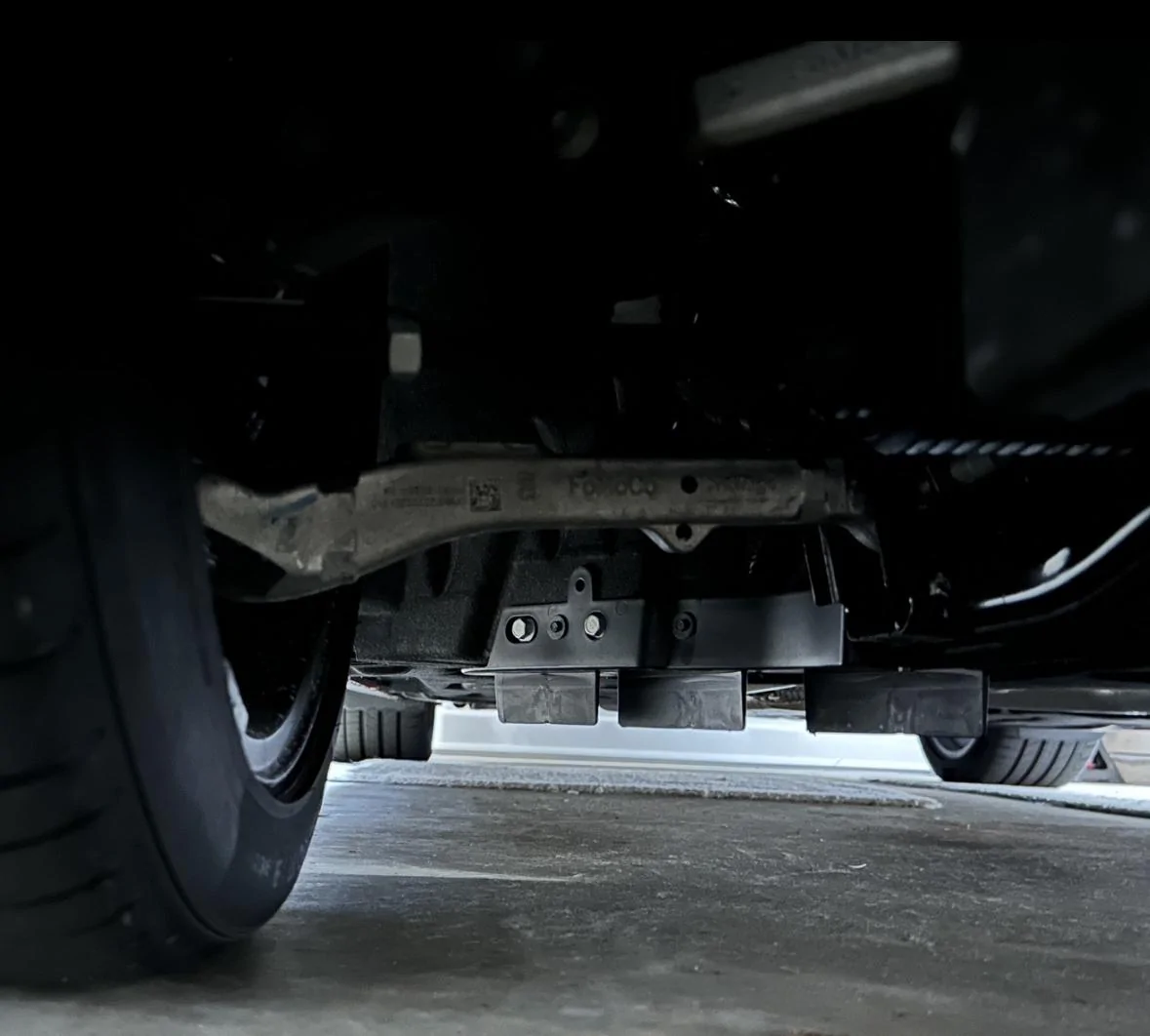

Picked up my GT with performance pack and they also were not installed. Here’s a pic, cut the wheel hard left or right, laid on the ground and took about 10 minutes per side.
Thanks for the picture. You didn’t lift it? Were able to put em on by cutting wheel all the way? Enough room to maneuver in there?
