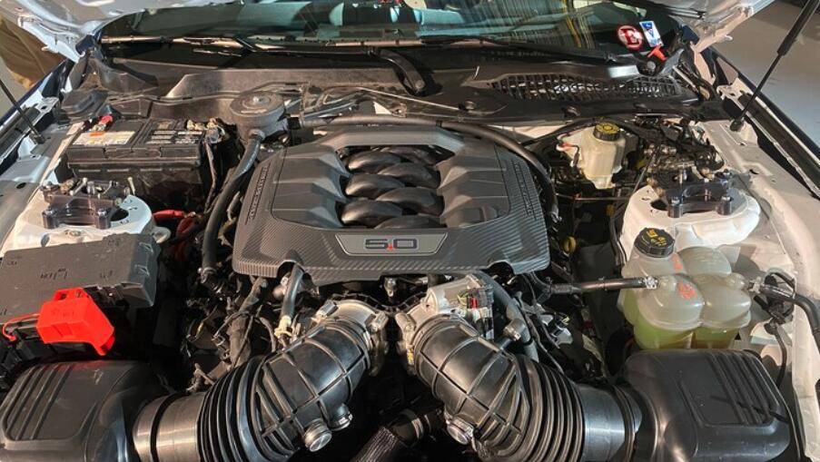

I’m pretty sure the Dark Horse does come from the factory with the Strut tower brace.

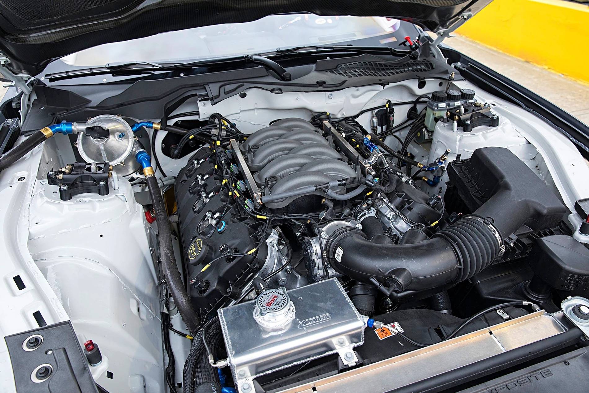

Nobody has still answered why there isn't one on the Dark Horse R.
And what about this Mustang GT4 $250k race car?
The reason why Dark Horse R, GT4 and hell maybe even a GT3 does not have a STB is because they come equipped with a roll cage that also ties to the front structure of the car. Adding a welded in roll cage significantly stiffens the chassis of the car more so than just tying in the two struts on the front top half of the car.
roll cage and a stiffer chassis all together, best I can do.
