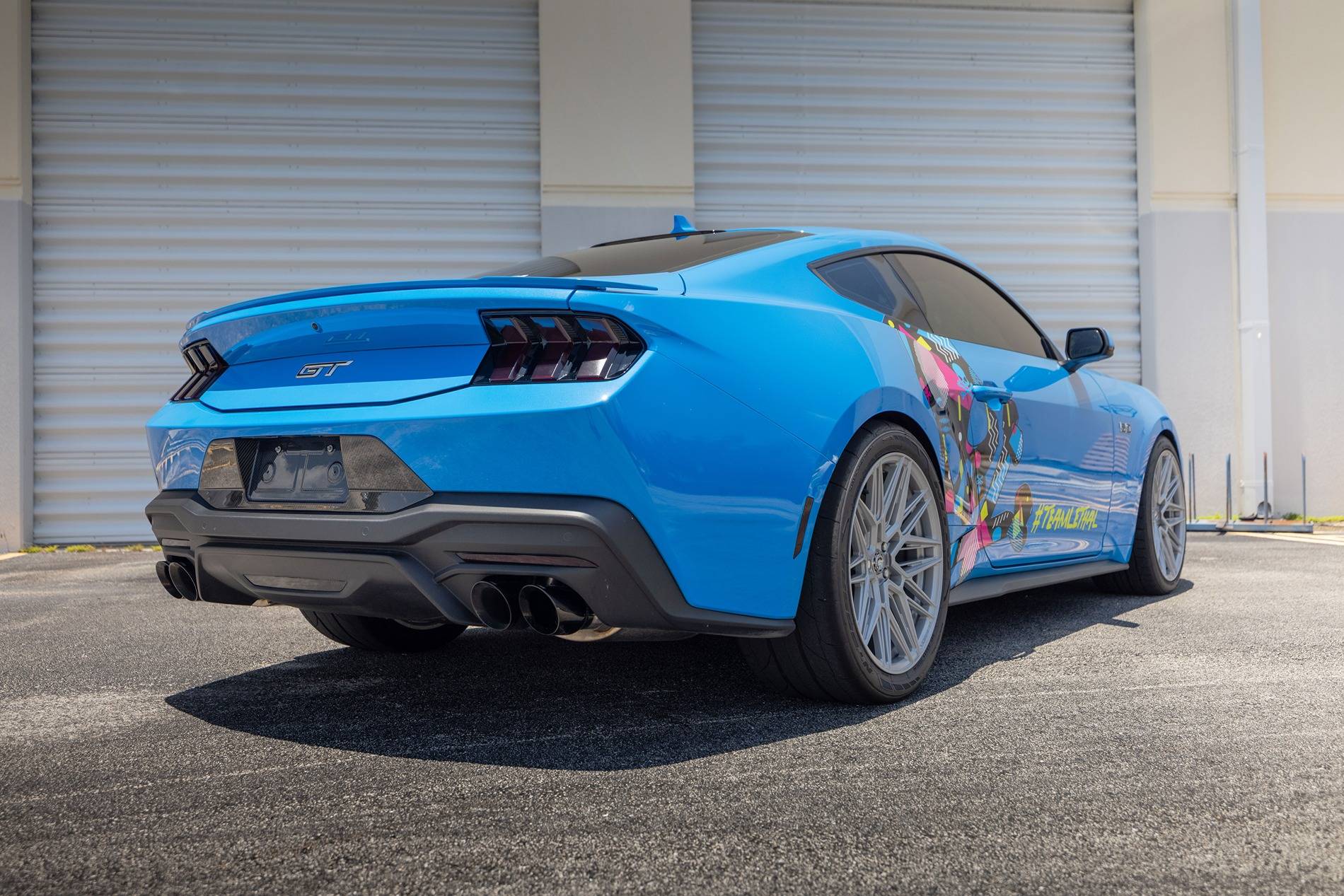

Hello guys!
I am planning to pull some triggers on some 20" wheels for my car and also lower it with Steeda magneride dual rate ultimate handling lowering spring at the same time. I did not find any one who has the same setup so I am wondering how the car would sit and look with 20" wheels when it is lowered. If anyone has pictures of the same setup, please share them with us! Greatly appreciated!
Here are the wheels and tires specs I am trying to get:
Wheels:
Front: 20" x 10" ET +35
Rear: 20" x 11" ET +50
Tires:
Front: 285/30/R20
Rear: 305/30/R20
Thanks again!!!
