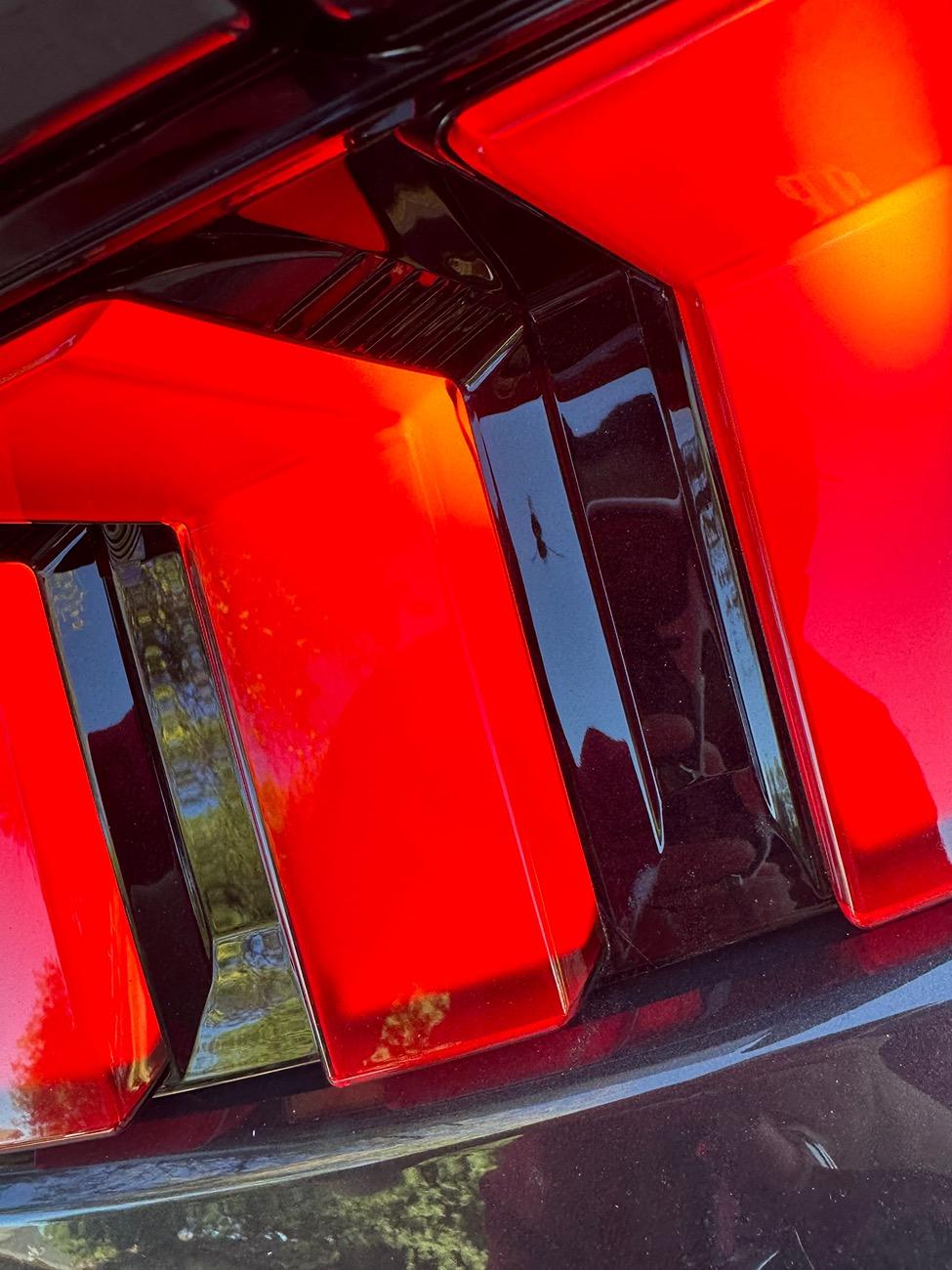

Has anyone had this issue on their tail lights getting random stress cracks? I noticed it Sunday night when I thought I had a leaf on the tail light and when I looked it turned out to be a crack. I checked the next morning to make sure nobody just hit me, and it was all good. My car had been sitting at home in my driveway all weekend long. Monday I didn’t drive my car and I called my local dealer to get it checked out, and when I got home that afternoon it developed a crack on the other side of the same tribar. I recorded it as best I could before I took it to the dealer on Tuesday. Even the service advisor said there’s no clear sign of someone hitting it when I had dropped it off, and I have seen some people mention it in the Steeda S650 FB group regarding moisture and stress cracks. Today I get a call back and was told it was denied for warranty replacement and they want me to pay just for them looking at the tail light. They also told me I had caused the damage myself and that’s why it was denied.
Just want to see who else has had this issue, and how to go about getting it fixed without paying out of pocket. Don’t want to pay over a grand for one tail light either..

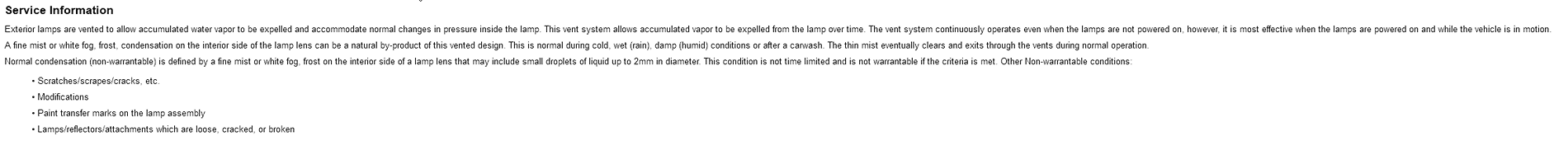

unfortunately, that cracking would not be covered under warranty, per Ford's GSB 24-7068 "Exterior Lighting Concern Analysis"
I think this may be taking the memo out of context. Surely Ford doesn’t mean to exclude cracks incidental to manufacturing defect as opposed to say, impact caused damage. OP doesn’t seem to show signs of impact - I don’t think... anyone else?

It looks like molding defects to me, but hard to be 100% sure in the images.
