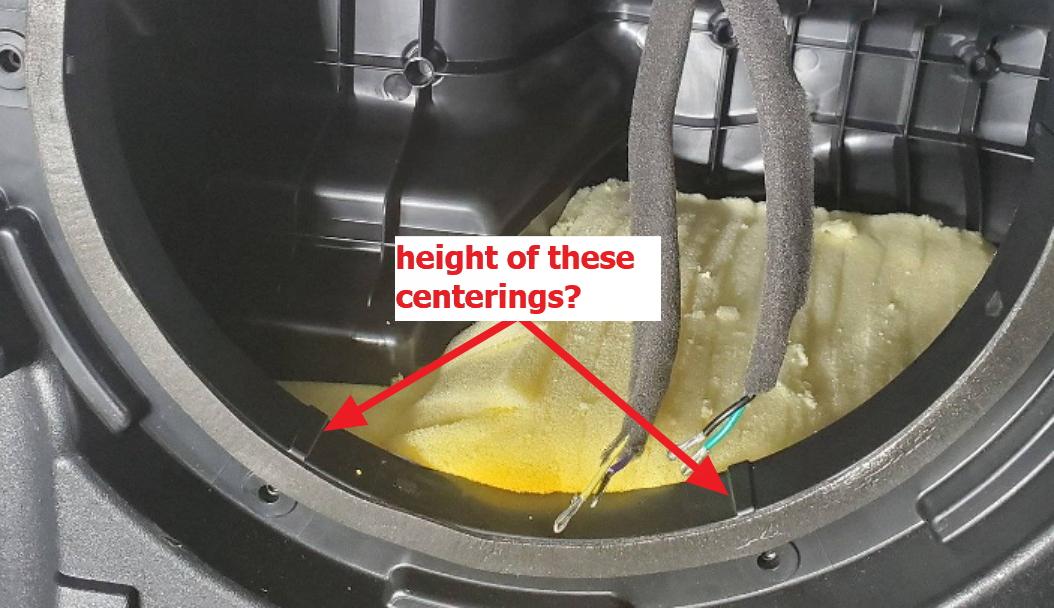

Does anyone know how thick or high these centering or screw reinforcement are?
I have an eye on a sub with 232 mm diameter and guess dremeling away these small protrusions wouldn't be a big deal:
