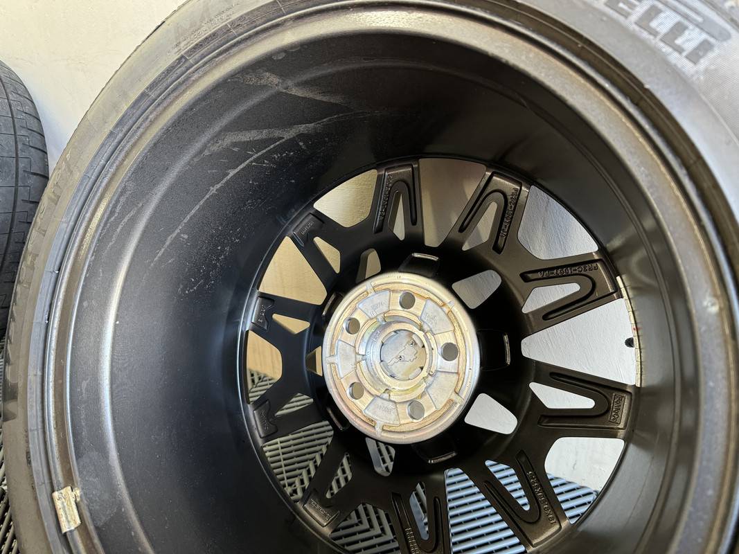

Having owned S550 and S650, both were smothering in that stuff. There is absolutely no preparation done prior to application, its just sprayed on without any care or skill. Check out the video below from 4 min 50 sec -

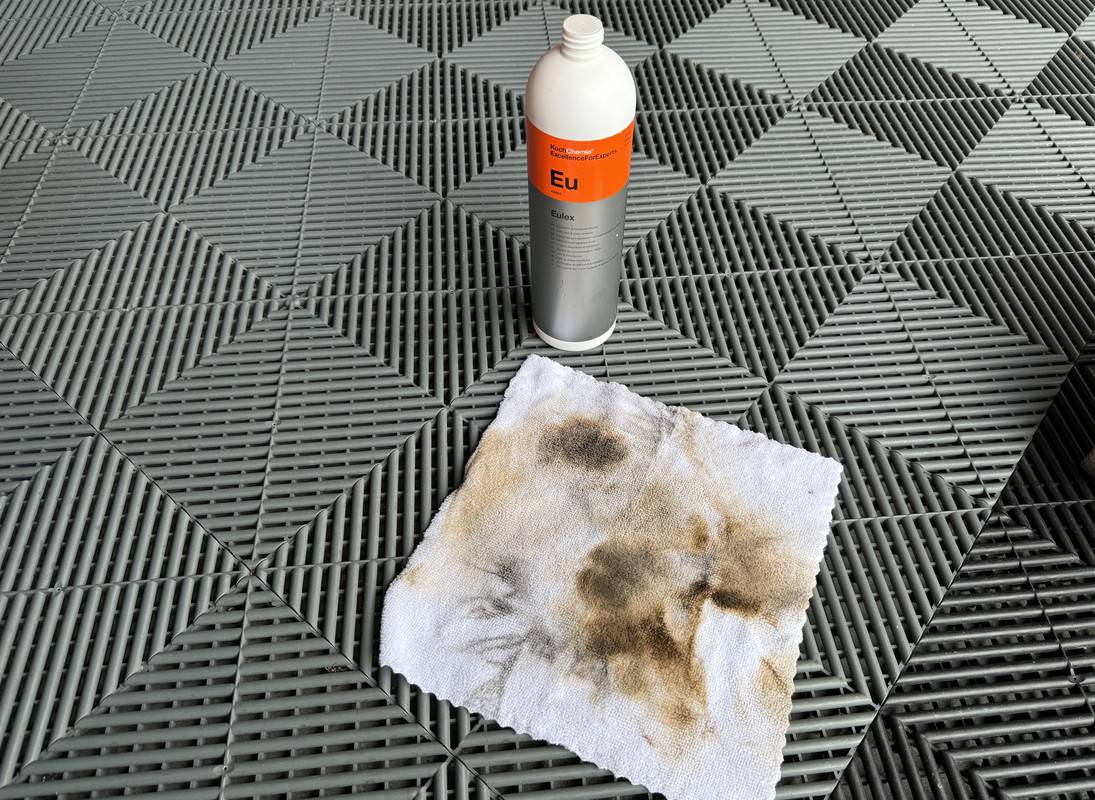

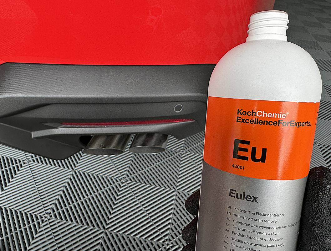

That paint ends up across the underbody, but also onto the visible exhaust tips, side skirts and even the rear wheels. I've also seen it misted across the lower painted sections of the doors. On my S650, I had to remove it from the exhaust tips, and it was slathered on my rear wheels too.
The paint doesn't seem very durable, its somewhat like bitumastic paint. With some effort, I managed to dissolve and remove it using Eulex.
S650 Mustang Anti Rust Protection under carriage IMG_2014
S650 Mustang Anti Rust Protection under carriage IMG_2016

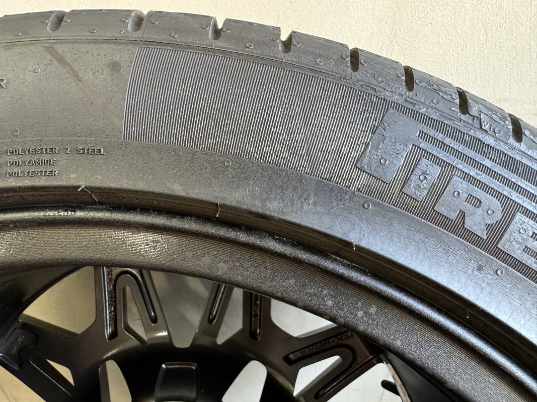

On the wheels, it was also on the sidewalls...........................

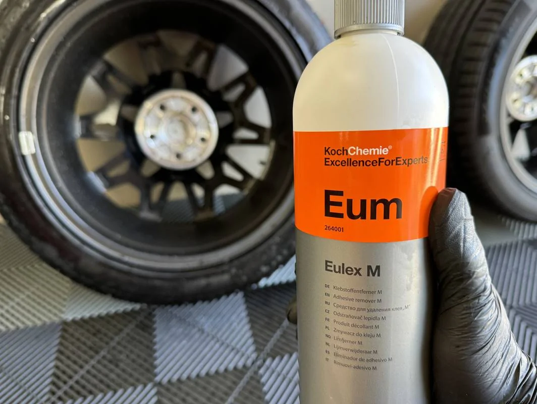

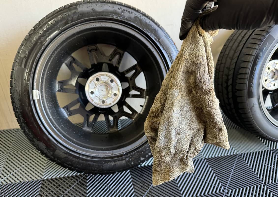

I had to use Eulex M because of the matte finish of these wheels.

But its not consistent. In my case, the visible part of the exhaust tips were peppered with the black paint, so it looked terrible. Made it look like I had driven over fresh tar.
