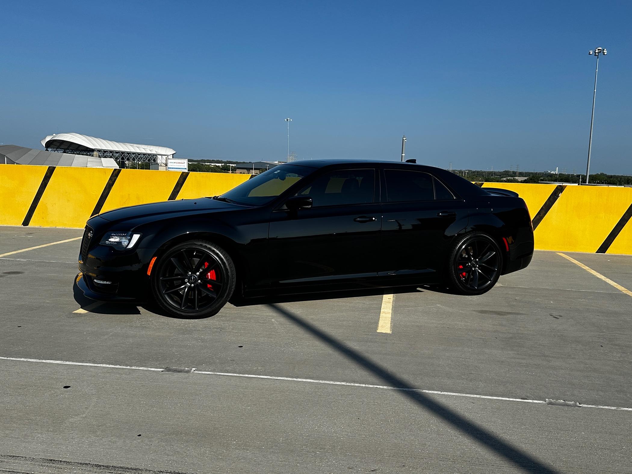

I did end up getting rid of mine as well. My dealer told me there are lots of issues with these cars. From electrical gremlins to motor issues (mine had both). I may try again in a year or so once the issues are resolved in the updated platform.
Until then I'm enjoying the 300C

Is that the SRT with the 6.4L or just the 5.7L Hemi?
Either way, nice looking ride.
