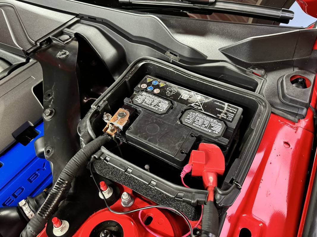

Has anyone connected a battery tender to their car yet? To make it easier on the battery, I like to keep it on a tender if its not going to be used for a week or so.

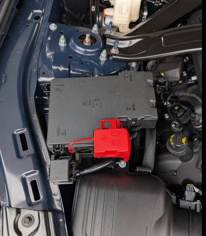

One option is to connect the positive (red) lead to the connection point under the red cover at the fusebox which is easily accessible but this is on the driver side of the car. I'm not sure if its recommended or safe to use that. My leads wont reach either because it would be too far from the negative negative stud.
S650 Mustang Connecting CTEK/Battery Tender 1739853158011-7z

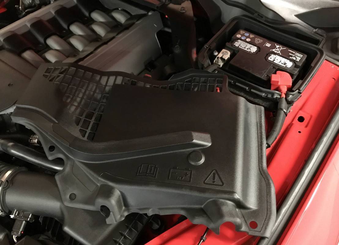

The other option for the positive (red) lead is to connect it to the battery directly which is under the battery cover. Downside is you need to remove that cover every time if you dont want a permanent install with a lead with the O-connecters at the end.

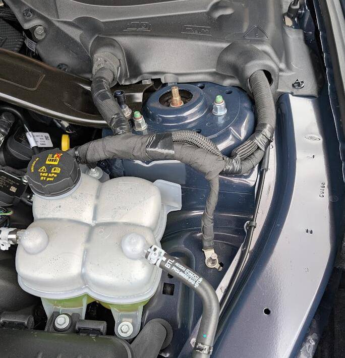

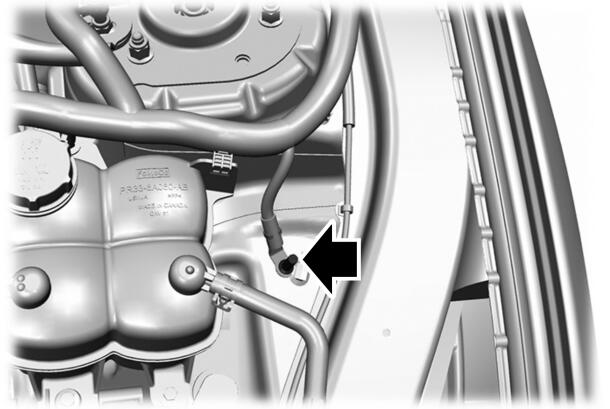

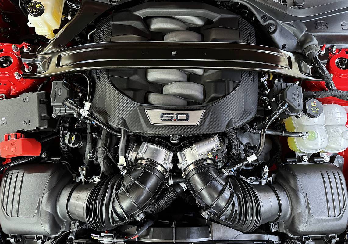

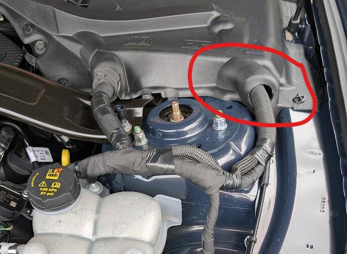

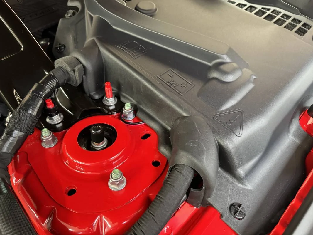

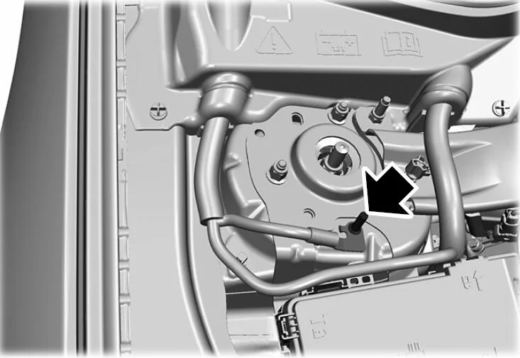

And then the negative (black) lead to the jump start stud which is on the passenger side shock tower close to the coolant reservoir:
S650 Mustang Connecting CTEK/Battery Tender 1739852058704-k7
S650 Mustang Connecting CTEK/Battery Tender 1739853104869-jl
I think I might just install that more permanent pigtail lead with the O-connectors for a cleaner install and so I don't have to mess with the battery cover every time.

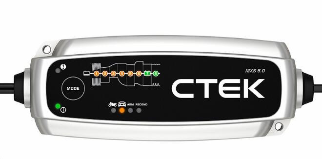

So good to see my charger is made for a Mustang. It says 5.0 on it! 😜

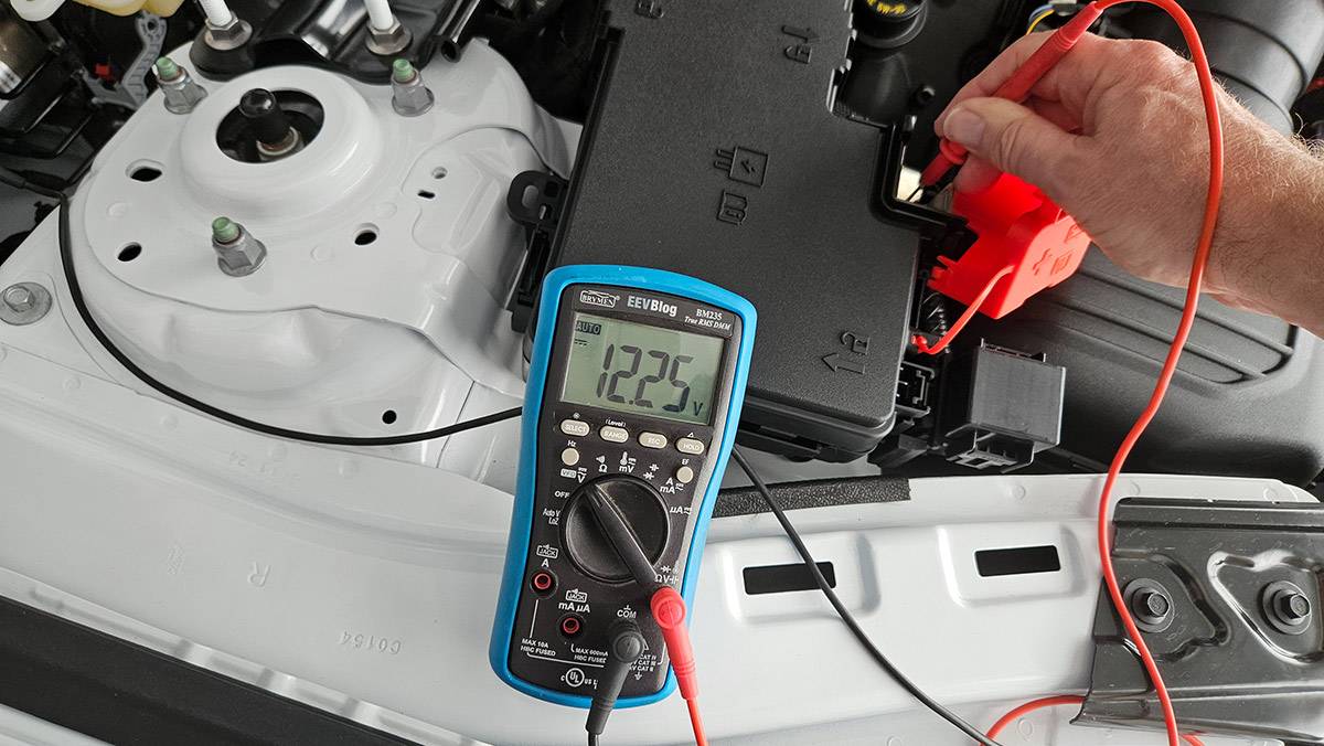

I've been away with work for 17 days, and before I started my GT up yesterday, I measured the battery volts at the fuse box.
Before I could snap a photo, it measured 12.15V.
Then it went into preservation mode.
S650 Mustang Connecting CTEK/Battery Tender 20250218_145714_FordPass_1200
I expect having done it's welcome light show, a door open, and the interior lights coming on, it was on the edge of the low-volts threshold.
After the remote features were disabled, battery volts went up to 12.25V, again measured at the fuse box on the battery +VE bus.

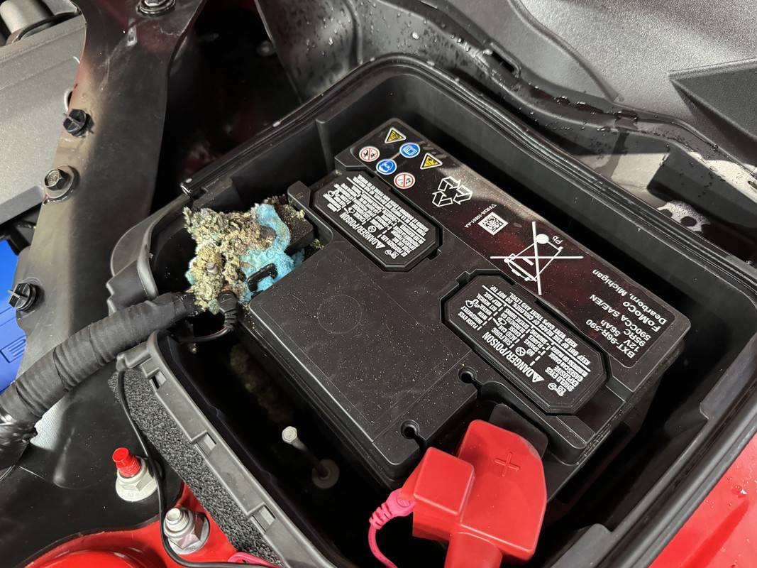

I'm sure many will remember this, but late into my ownership of the S550, I had a little hiccup with the battery. The cause and result were both my own and the dealers doing. Because these batteries are covered and hidden from view, an owner is less inclined to inspect for condition.............out of sight, out of mind. On the dealer's behalf, the car had been serviced a week prior to me discovering this problem. They supposed to inspect battery condition during scheduled services.............they even note it on the invoice and emailed condition report. If both of us had done our jobs, then perhaps the following wouldn't have happened.
S650 Mustang Connecting CTEK/Battery Tender img_0390-
As I said at the time, batteries have a lifespan, this one being the OEM fit and 8-years old. What pis.ed me off the most was that it wasn't picked up and sorted while I had the car in for service.................despite noting it was in fact inspected. It clearly wasn't! Not only had the battery failed here, even if it still started the car fine, it also ruined the negative terminal and my CTEK pig tail. I cleaned it up best I could, then slathered it with Vaseline until I could have the battery replaced.
S650 Mustang Connecting CTEK/Battery Tender img_0488-
I sent an expertly worded email with supporting images and highlighting of the service report to the service department. The service tech was scolded for his negligence, and I was profusely apologized to. In the end, they offered to replace the battery free of charge as a goodwill gesture, fitting a new negative terminal and pig tail in the process.
Except, that wasn't the end of it. When I got the car back, I noticed instead of washing the battery tray out, they used compressed air and showered the engine bay in potassium hydroxide. Which then involved a lot of work to remove and neutralize. Then throw in the oil they spilled down onto the exhaust manifolds during the service, they completely ruined my pristine car. That was the final straw with the dealer, I won't be going back unless I need warranty work on the S650.
As you can imagine, I don't want a repeat performance. I've since gone around and applied battery terminal protector to all my cars, as such it was the S650's turn today.

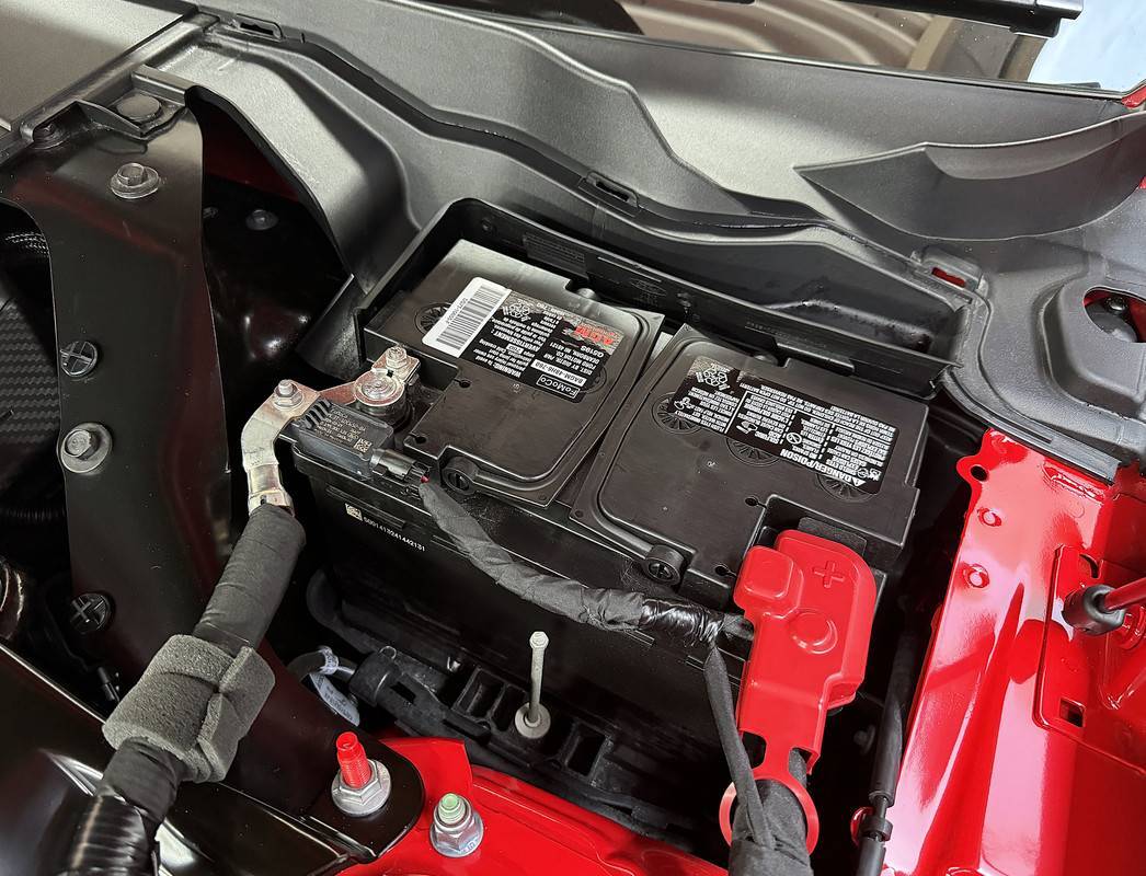

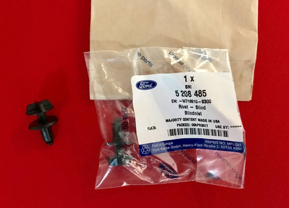

To gain access to the battery, you need to CAREFULLY remove the plastic fasteners that hold the rubber cover in place. These fasteners are fiddly and prone to being dropped into the abbis, ask me how I know this! If you do lose them, these are what you need....................
FORD MUSTANG F150 CLIP W716510S300 BATTERY COVER COMPARTMENT HOLD DOWN – GlobalTrim
S650 Mustang Connecting CTEK/Battery Tender img_2488-
(S550 shown, but they are virtually the same)
S650 Mustang Connecting CTEK/Battery Tender img-e2024-

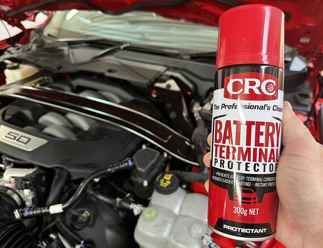

From here, you have direct access to the battery. There are many terminal protectors on the market, I'm using the CRC version, which you spray directly onto the negative terminal. If you end up with overspray, a little mineral spirit on a rag will easily remove it.

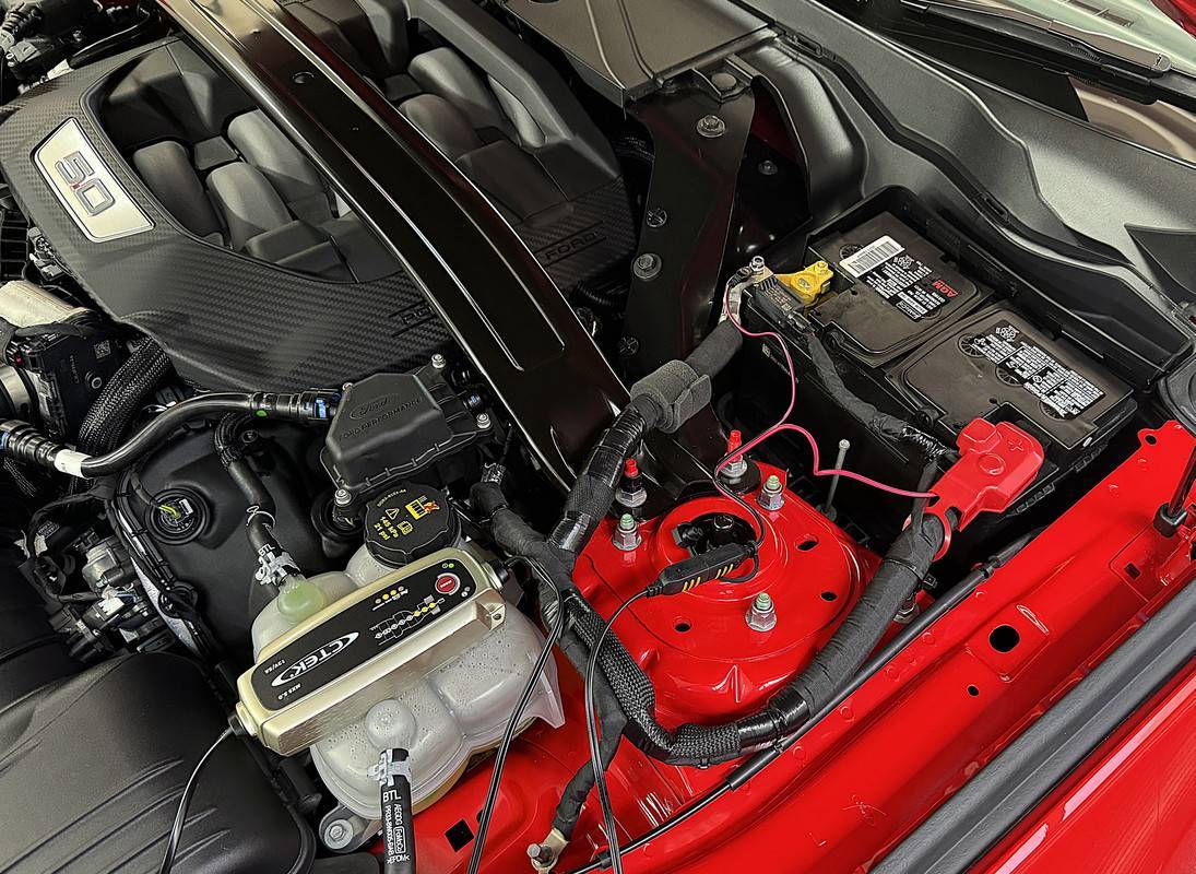

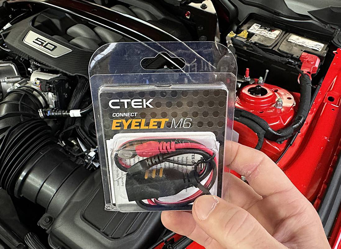

While I had it uncovered, I decided now was a good time to fit a pig tail for my CTEK chargers. This is probably redundant now that Ford include a remote positive terminal next to the fuse box, but that would require using the fiddly alligator clips. The pig tail allows charging access to the battery without removal of the cover, negating the need for those alligators and can then be tucked back under the cover when finished.
In the past, I found the terminal nuts were captive, so I had to secure the eyelets with a second nut. CTEK have a version with open eyelets to account for this, but they weren't in stock for me today.
CTEK Battery Charger Eye Terminals - 56-260 - CTEK | Repco Australia
CTEK CS One Connector Terminal - CTEK | Repco Australia
S650 Mustang Connecting CTEK/Battery Tender img_2803-
S650 Mustang Connecting CTEK/Battery Tender img_2810-
S650 Mustang Connecting CTEK/Battery Tender img_2814-
There are a few different ways to rig up a trickle charger line, some even do it via the fuse box. On all my cars, I just fit them to the terminals and have done so for a decade now.

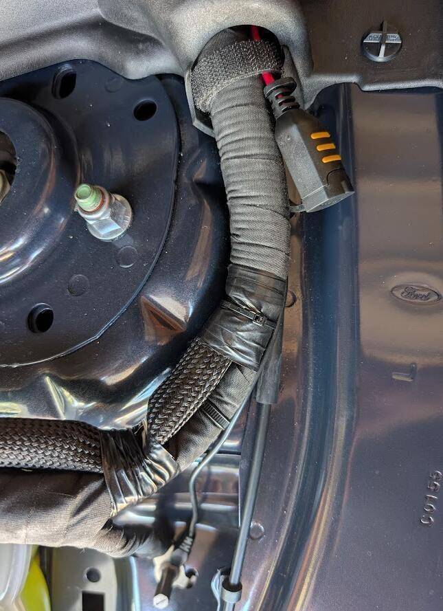

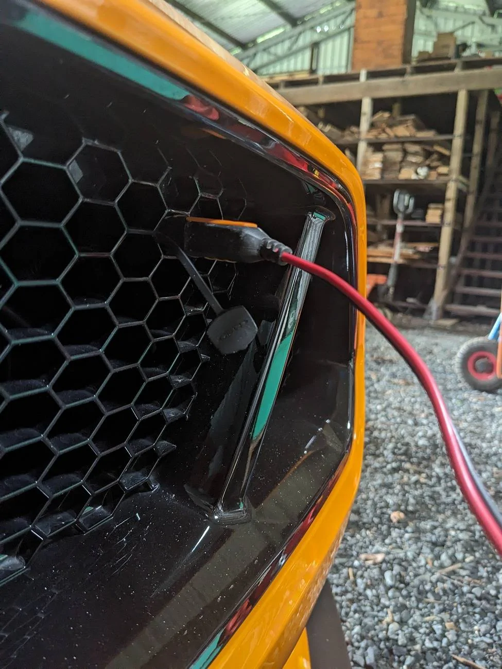

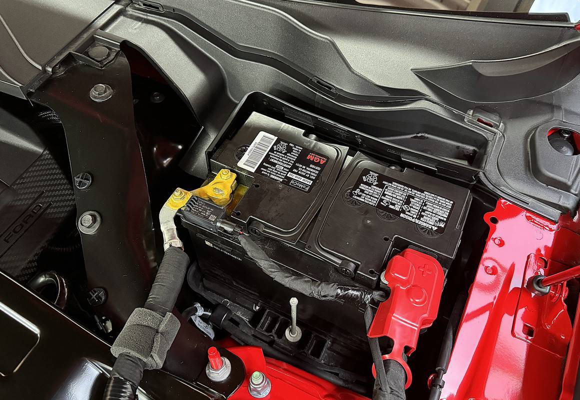

I ended up installing the pigtail positive directly to the battery positive, and the negative to the negative charging stud. The connector is poking out from under the battery cover so I don't need to remove that every time I charge.

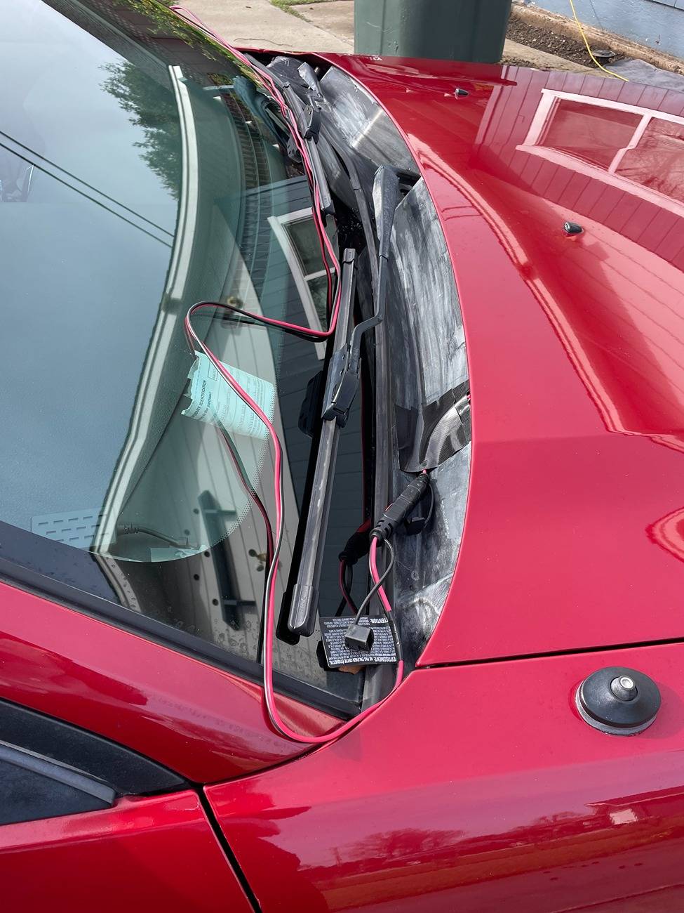

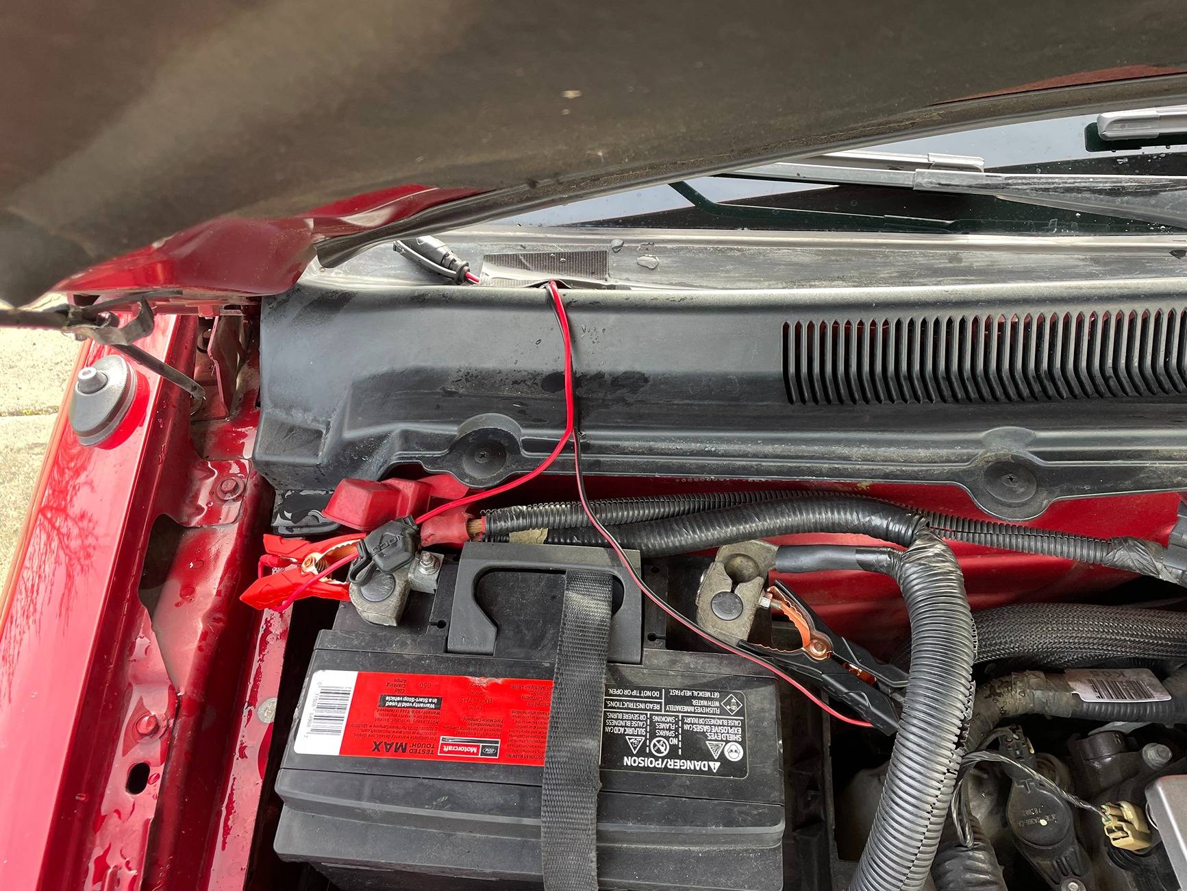

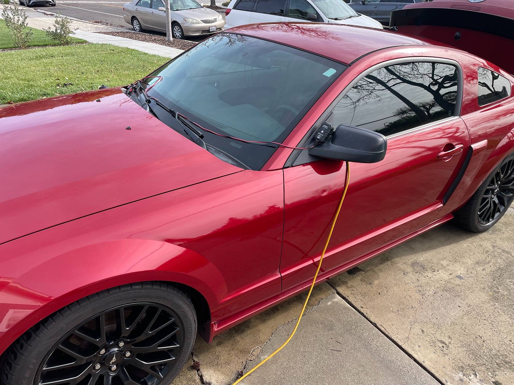

Not sure if helpful, but below is the setup for our 2008 Mustang GT (S197). We are using a NOCO Genius 1 (1 amp) charger (LINK) -- and yes, we need it, as car won't start if not driven at least once a week. This setup works perfectly as a trickle charge, but if you need to recharge a completely dead battery plan on 5 to 7 days to full charge!. Getting a model with higher amp output (at least 3 amp or more) will solve that problem (divide the 5 - 7 days by the amp output of the charger you are considering to get your estimated charge time in days). We use the original clamps to attach to the pos and neg battery leads and then feed the cable through the space between the hood and windshield, then connect/disconnect at bottom of windshield (duct taped the plug to the plastic area at base of windshield). Easy to connect/disconnect without need to open the hood. Hang the charger unit on the driver side mirror to ensure that my son does not forget and drive off with it attached! Pictures are below, and working perfectly so far . . .
S650 Mustang Connecting CTEK/Battery Tender IMG_4188
S650 Mustang Connecting CTEK/Battery Tender IMG_4189
S650 Mustang Connecting CTEK/Battery Tender IMG_4190
