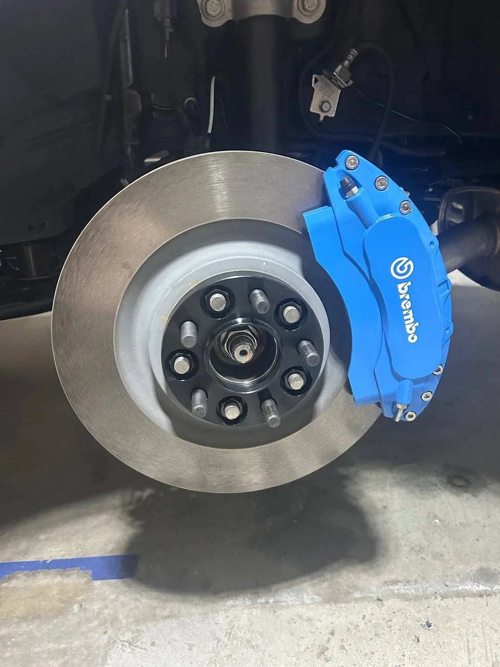

I mean, 5mm isn't very much in terms of wheel spacing. I went with a 25mm spacers and didn't cut anything. Got the look I was after also with the wheels for the application.

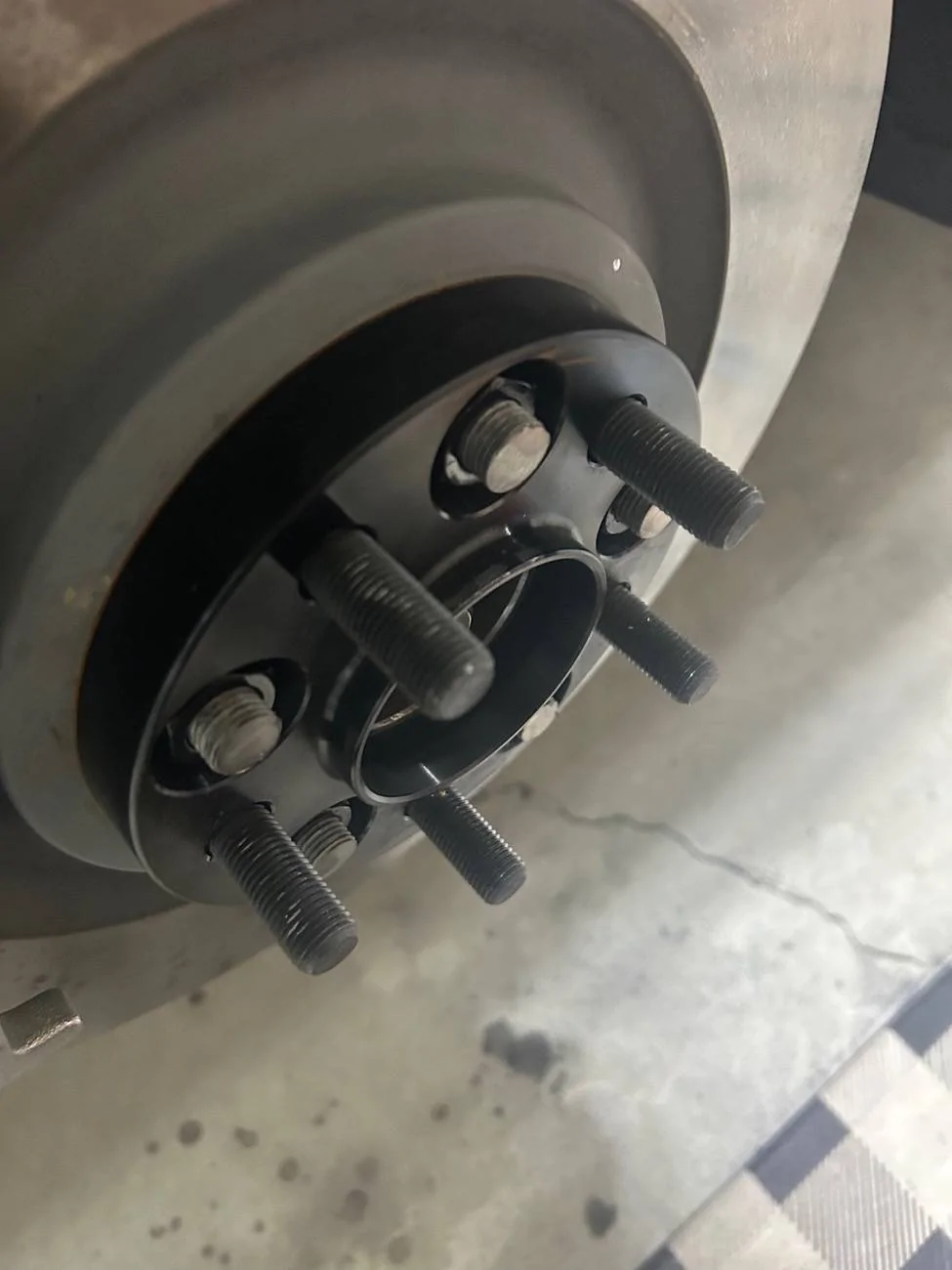

Yep, with 25mm I was fine. Need to take off 3mm to use 20mm, though. It’s not much, but I can tell the difference!
No problem trimming them. Grinding was easier than cutting. Never got hot enough to cause any uses with losing strength.
I cut an old lug nut down to use as a guide. Then that cleaned up the threads when I took it off. The lugs holding the spacers screwed on no problem!
