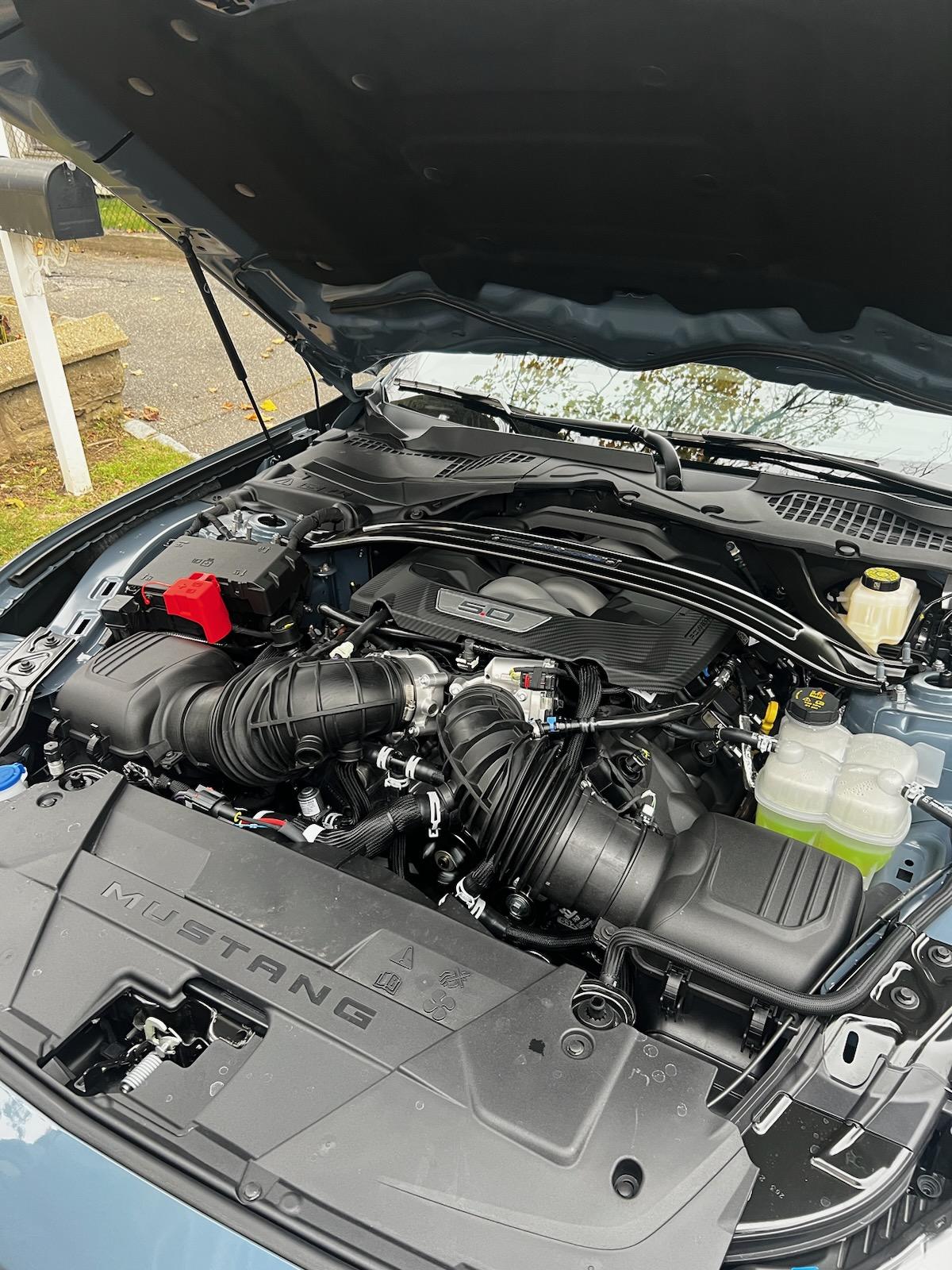

Hi, I purchased my DH in August and got it a week before Thanksgiving, I got every package except carbon rims and the painted hood, how do I know if I truly have the adjustable strut tops, as looking at aftermarket the adjustment is on the top of the strut tower no jacking up required, I don't have that ability to do that, can you send me pics of your tops to see if it's the same. Thanks so muck

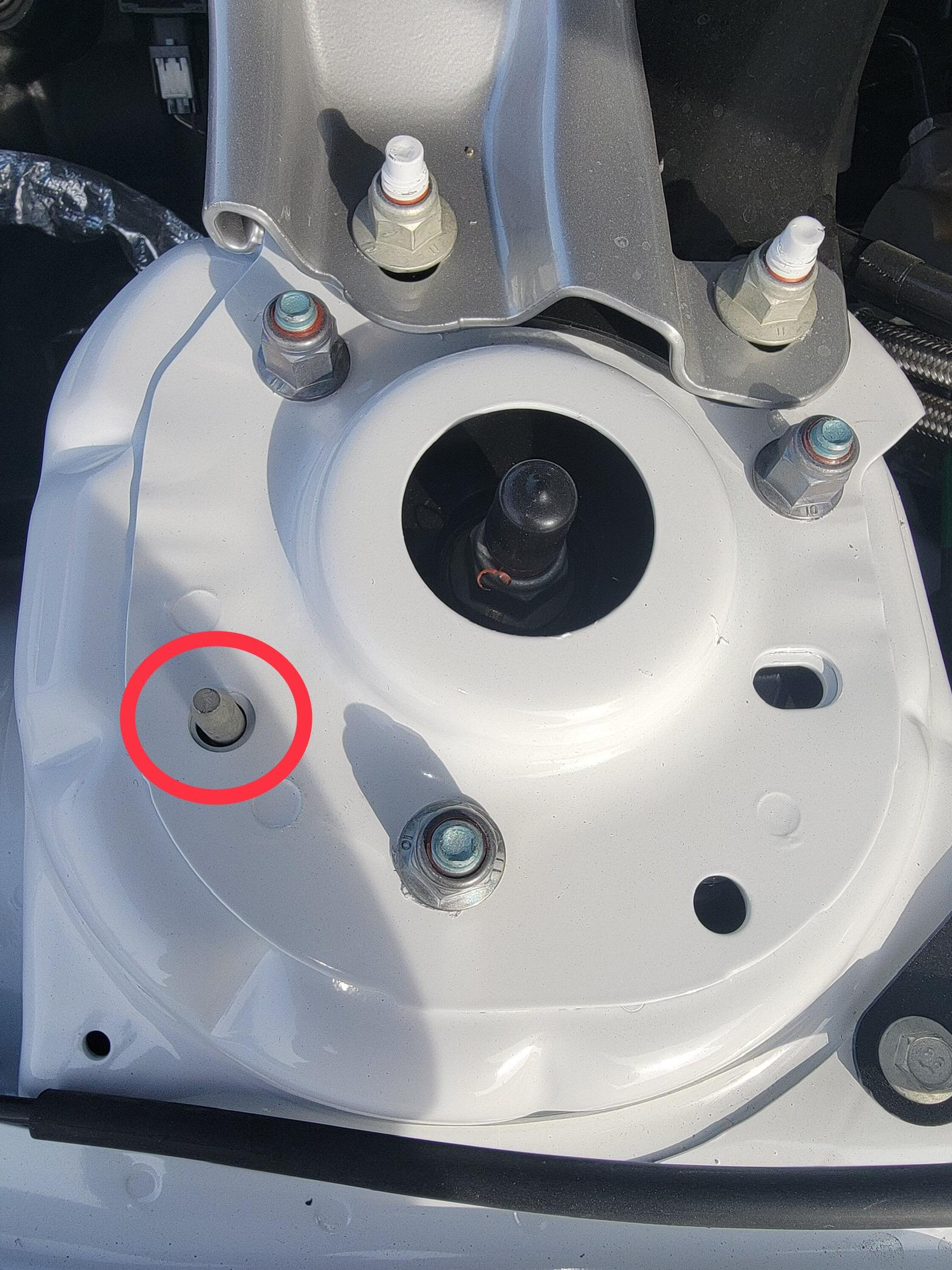

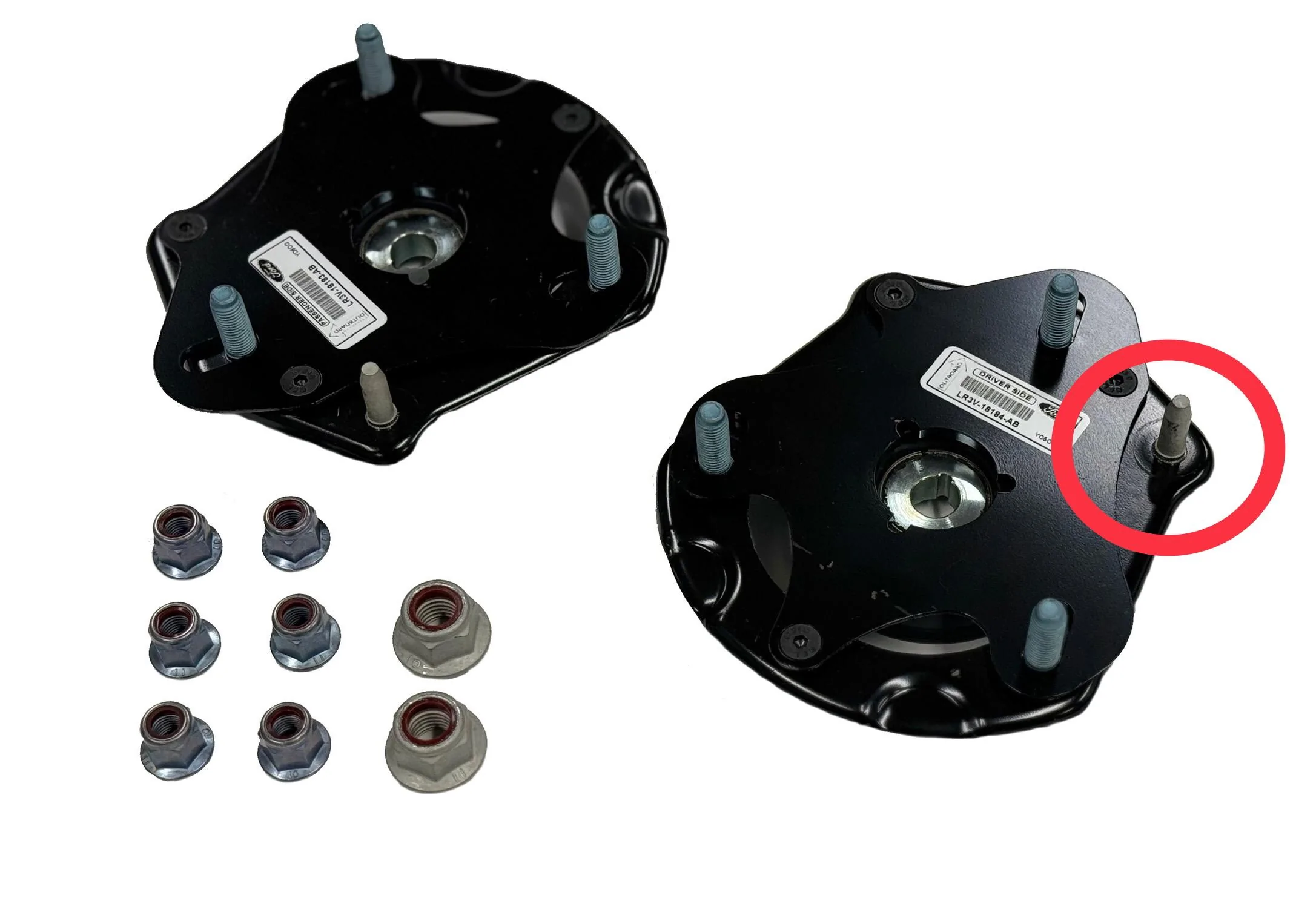

Attached are photos of the plates for prior years.
Notice the pin in the plate. HP cars (adjustable) have the pin. Non-HP do not.
