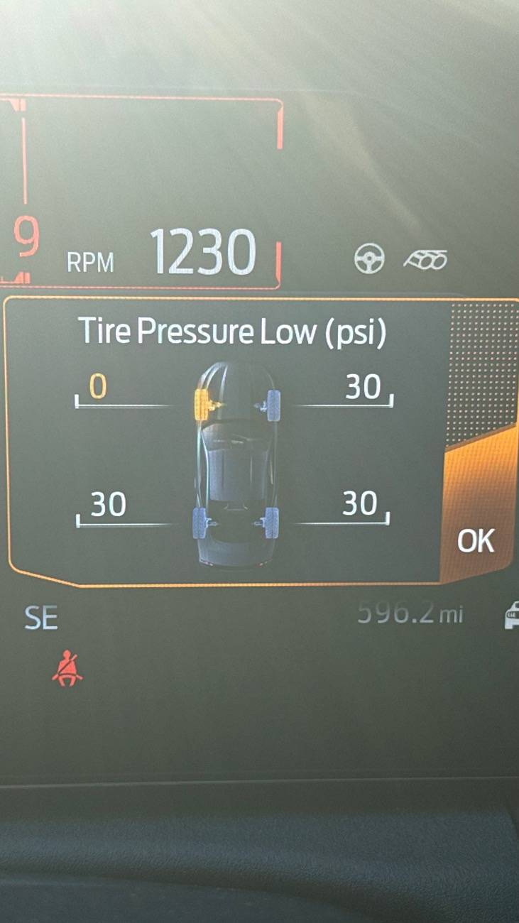

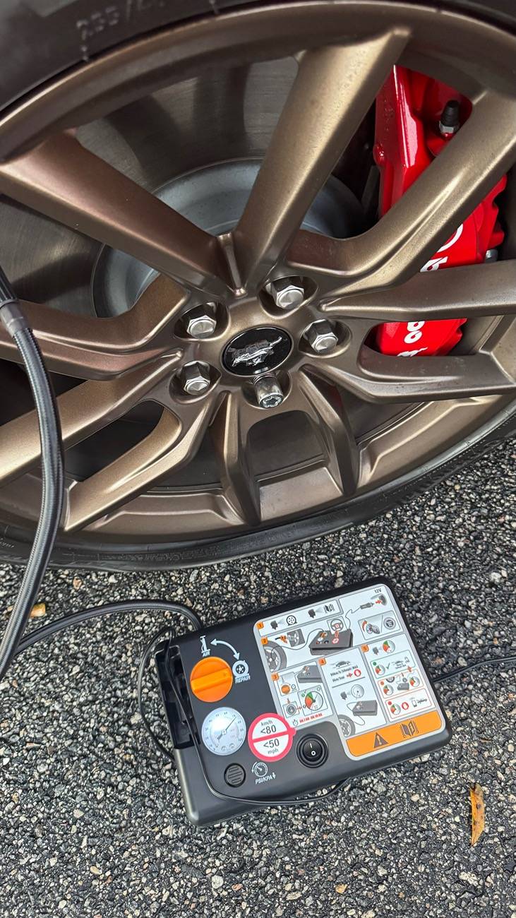

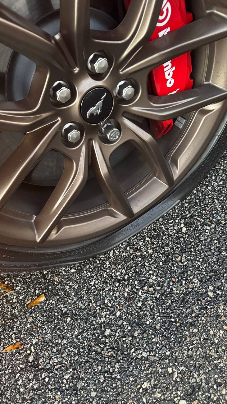

It turned on and everything, just didn’t “patch” the hole and didn’t inflate.
This is one of the pitfalls of most modern cars and Mustangs. Small leaks and holes might not be an issue. Anything significant, forget about it.

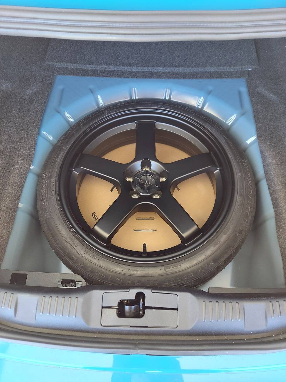

This season, I purchased a spare from Automotive Authority.
https://www.automotiveauthorityllc....-2015-2017-ford-mustang-gt-with-brembo-brakes
Chat them up about options for the S650. In the S550, the spare will clear the cover, so it appears all stock, with the space saver underneath.
An alternative, drivers taking long-distance trips, might want to fab up a full-sized spare.

I've got 19s and Brembos. The AA spare works fine. The rim and tire are also within 3% of the tires' diameter I'm using now. Before they shipped anything, they e-mailed me to confirm rim and tire size, to ensure I was going to get something that would work.

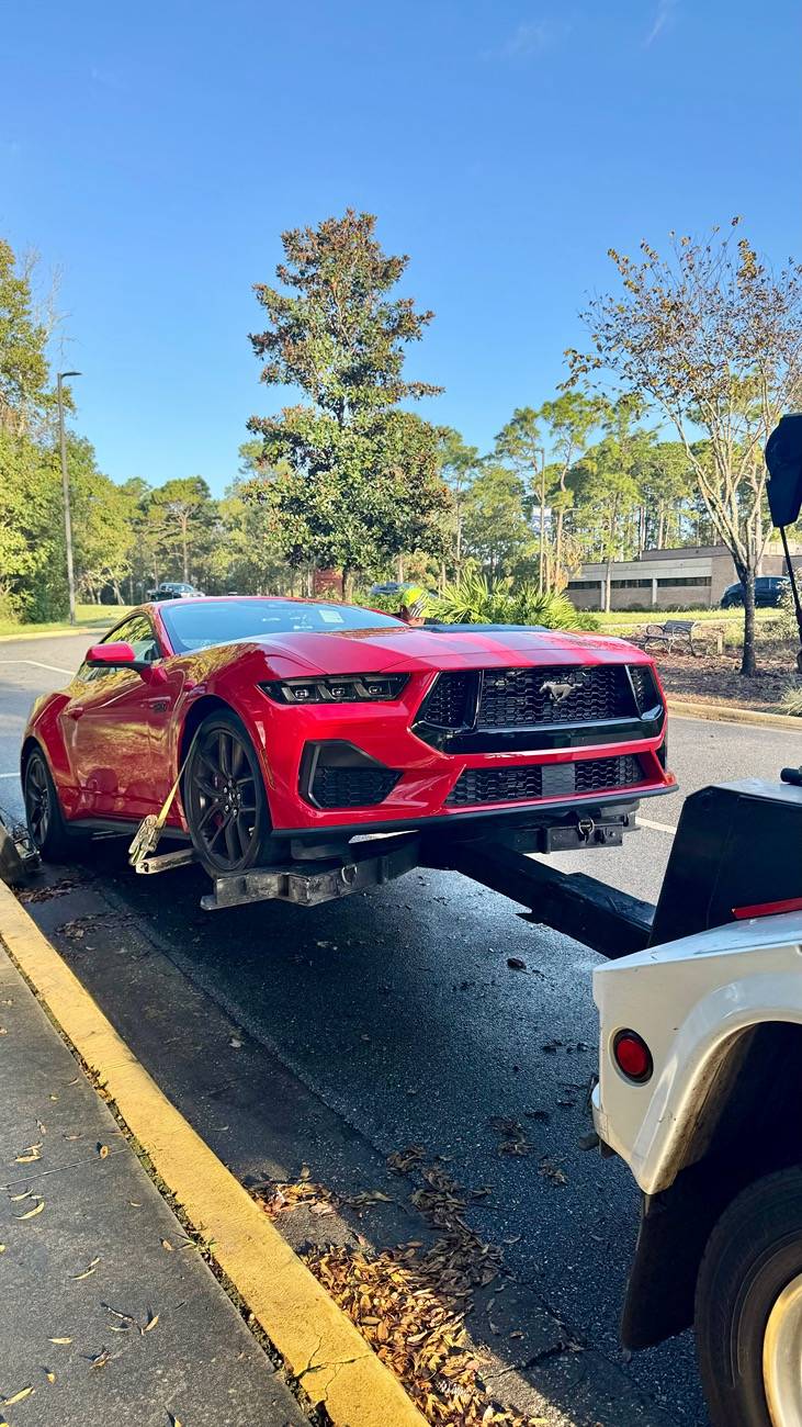

When you ordered the Tow, did you ask a special one for Mustangs? or any tow will work?
When my Vette exploded and needed to be towed a handful of times around TX, when I called dispatch I just always told them it will need to be a flatbed. Maybe not possible if you’re really in a pickle but even at 10PM on a Friday in BFE, I’ve still had them show up.
If my Mustang ever needs a tow it’s only going on a flatbed

Thanks for this post. Question, will this Rim/Tire clear the brembos?
1,304
1,839
≈39N
The kit I was sent does. And the diameter is within 3% of the wheel/tire combination I'm using.
When I placed my order, I selected what I thought would be the correct package. Before it was shipped, one of their team reached out to me via e-mail. I confirmed the car ('22 M1 with HP) the existing rim (19") and tire (285/35). They confirmed what they'd send. A few days later, everything showed up.
At their web site, they have several Mustang options.
I ordered the kit, which is a tire/rim and small scissor jack.
If considering a purchase, you'll make one mod to your car: the felt, attached to the underside of the wheel well trunk cover. With the clearances and all, you'll need to cut a circle big enough to clear the spare, removing that felt padding. The cover itself is not effected. I got mine just right. Sits flush. Looks like from the factory.
The air inflator, I saved that. It's stowed in the house. After two to three years, the car will alarm/alert about the inflator kit, telling you it's time to change the slime canister. You can simply ack the alarm.
Before placing an order, reach out to them, explain the car/rim/tire. If you're happy with their response, place an order.
If doing long-range touring, I'd research a full-sized option.
Edit,
Residing in the wheel well of Skye is the AA spare, secured. The cover on top. I have their small jack, torque wrench, and other bits sitting in the trunk, wrapped in microfiber towels to prevent scratching. I could have put their jack in the well. I simply elected to leave it handy.
For anyone doing anything regarding a spare, make note of the lugs in use. For example, the AA spare uses the factory lugs. The rims I'm using use Gorillas. Not a big deal. Just something to remember when stocking the trunk.
Set your trunk how you like. Maybe do a dry run or practice once you have it all sorted.
