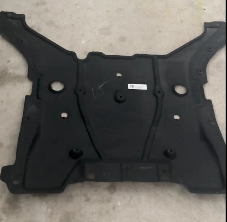

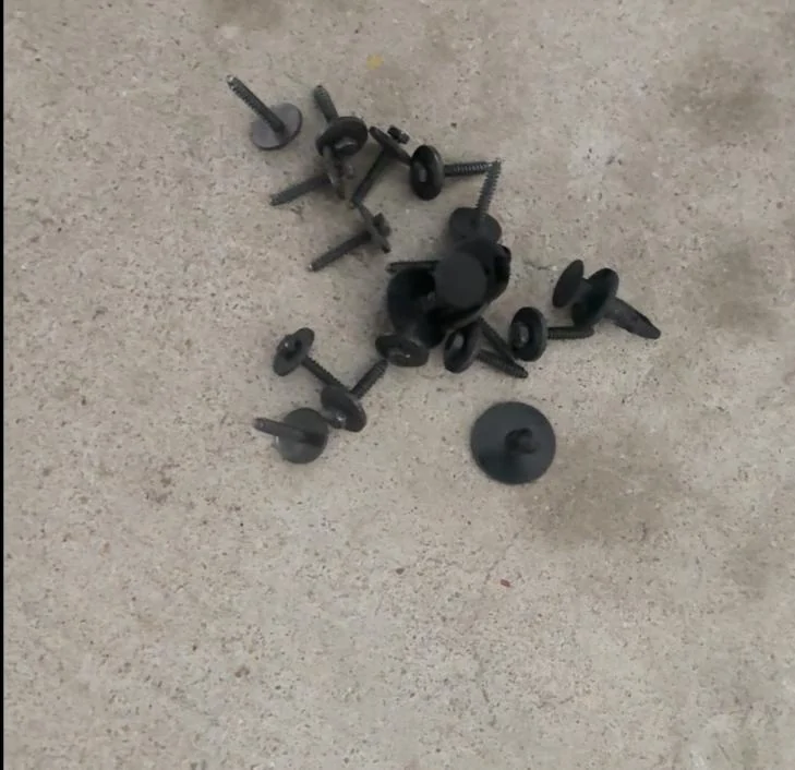

Are you serious, 21 screws??? WTH do we have to remove the whole bottom of the car?? Lol
front undertray is held on with 21 7mm bolts and 3 clips, that makes it actually possible to get to the oil filter

I just got done with the first oil change on my Dark Horse. 1300 miles. What a huge pain in the ass. Ford did not make it easy! The whole under pan has to come off to get to the oil filter. And the strakes have to come half way off to get the pan off. 17 7mm screws and 5 plastic retainers. The 2 big ones in the middle will brake, so be prepared with replacements. Once it's off, then it's pretty easy, but then it all has to go back on.
Oil plug was not that tight.
The pan that I had to remove was full of rocks. And I have been very careful keeping it out of gravel. The rails behind the front tires were full of rocks. And the hard plastic pan under the radiator toward the front was full of rocks. I think I spent more time getting stones out than changing the oil. It drove me nuts.
Another observation...there were some tiny stones stuck in the soft tires. I haven't drove it in 2 weeks. I picked them out and they left disturbingly deep divots.

Yep a lot of 7mm screws and cheap plastic clips
Are these push pins that can be purchased at the auto parts store, Amazon or my local harbor freight has a tray with 6-8 different kinds of push pins/connectors for $11 and I think there are 100 of them.

Either HF or Amazon. I purchased a kit on Amazon that has 100's of these little devils... The kit even came with a removal tool. Haven't used on s650, but every other car I needed a pushpin on I've found a replacement in the kit. Do a search. They are all basically the same so pick the one with most variety. Best wishes!

only 2 of the pins won’t be reusable and they aren’t even needed with all the screws and other 2 pins. I didn’t replace them. I wouldn’t worry about it. 2 pins are the ones you pull the middle to loosen which are reusable and then two are those ribbed ones that usually are a PIA to get out and can’t be used again.
