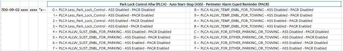

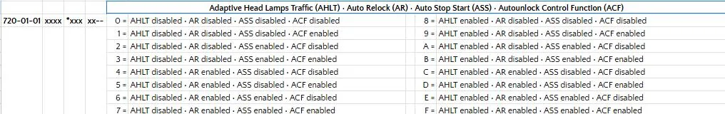

As far as auto start/stop goes: You can try playing with these settings. Just document whatever is there before you change anything in case you need to revert back. Unfortunately, these things require brave souls willing to try things out to see if they work.
ABS:
APIM:
IPC:

What kind of other functions? Like, what else past forscan does it enable? I can’t imagine what else someone would need.
update: disregard. Did some research on my end.

There's also a change you can make so that, if you unlock the vehicle with the remote but never open the door, it automatically relocks it after a specified period of time, which I believe is adjustable. This would be nice in the event that you (or your child playing with your keys) inadvertently unlocks it. Unless that's what you were trying to describe in bullet #3.

Yes I enabled that (point 3) I think I used the values in the sheet under auto-lock, haven’t tested that though.
