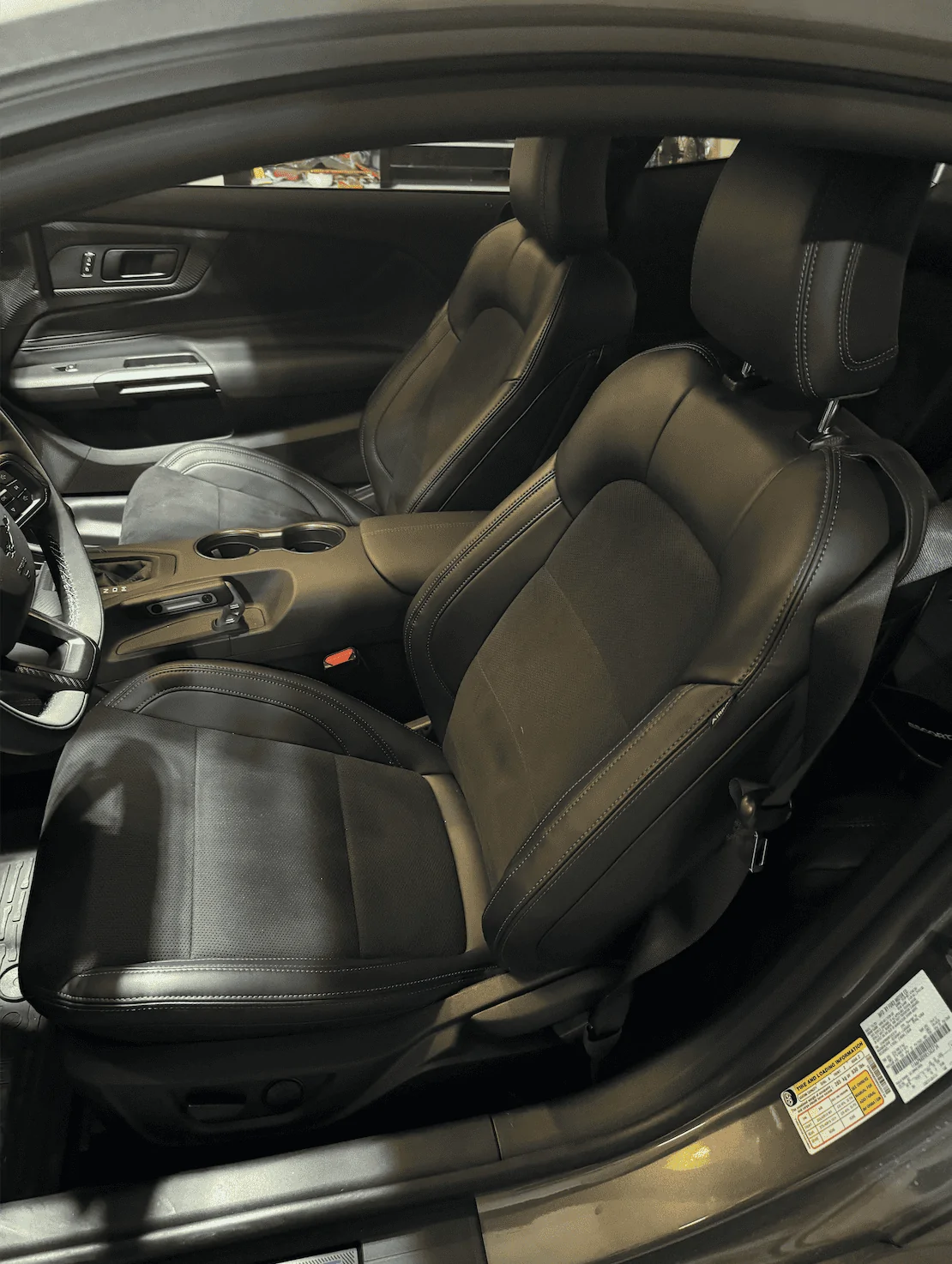

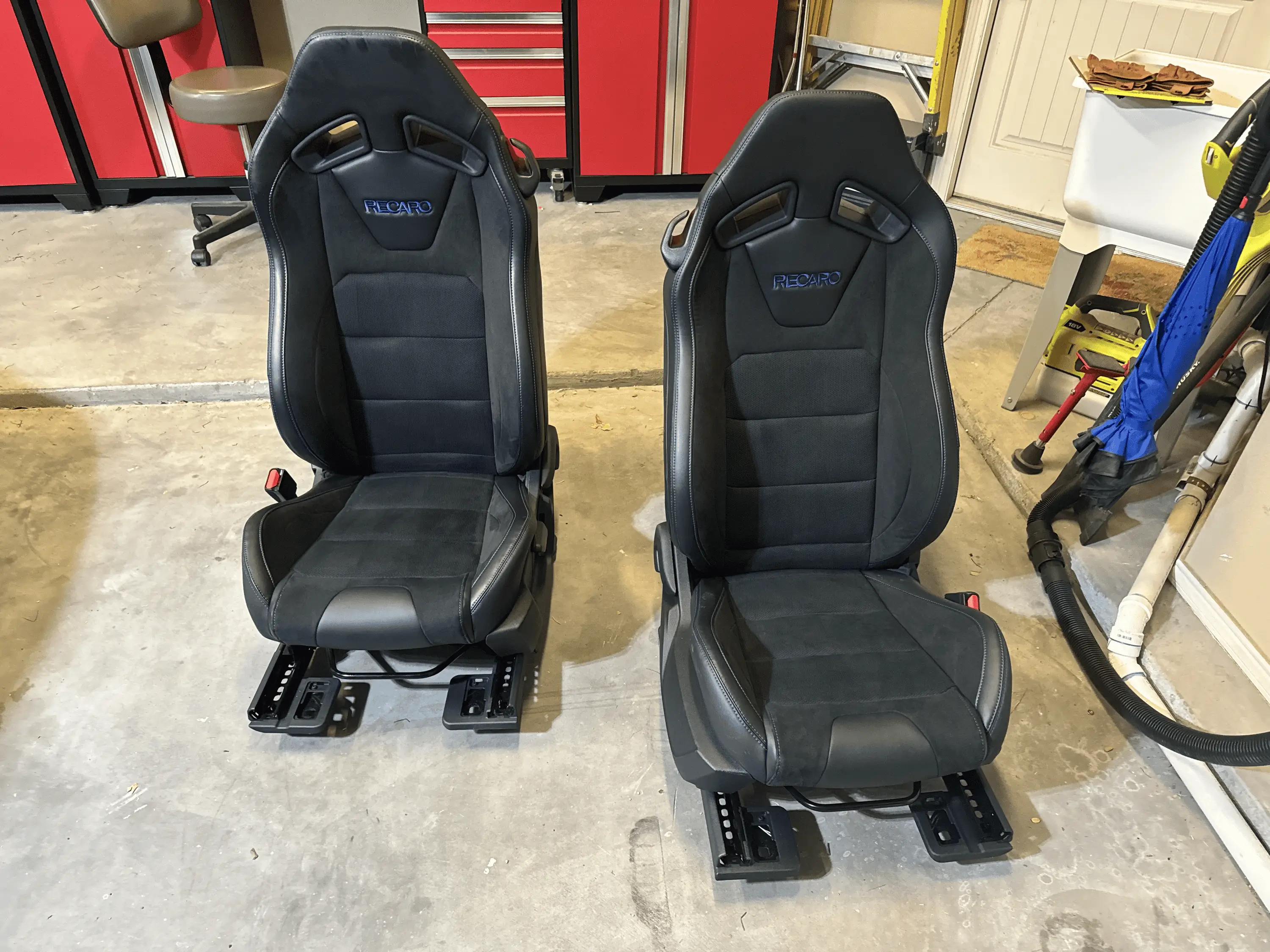

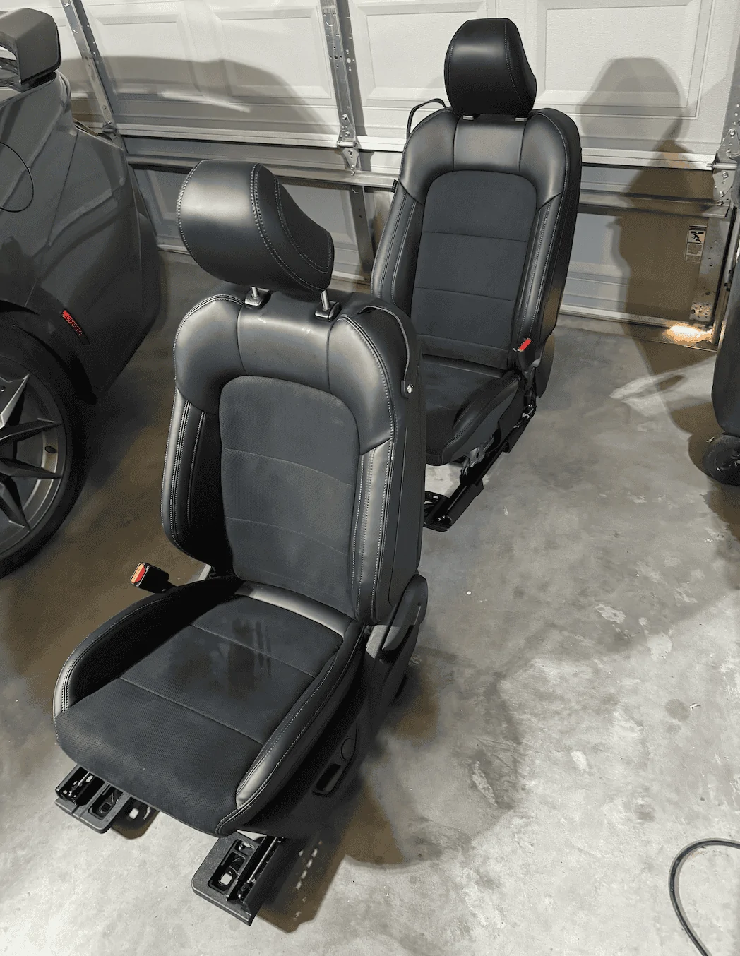

So I really can't believe that someone living right near me had the exact seats I wanted and wanted the exact seats I had. An 18 year old (with an 18 year old back) traded me his power DH seats in matching color for my Recaro HD seats.

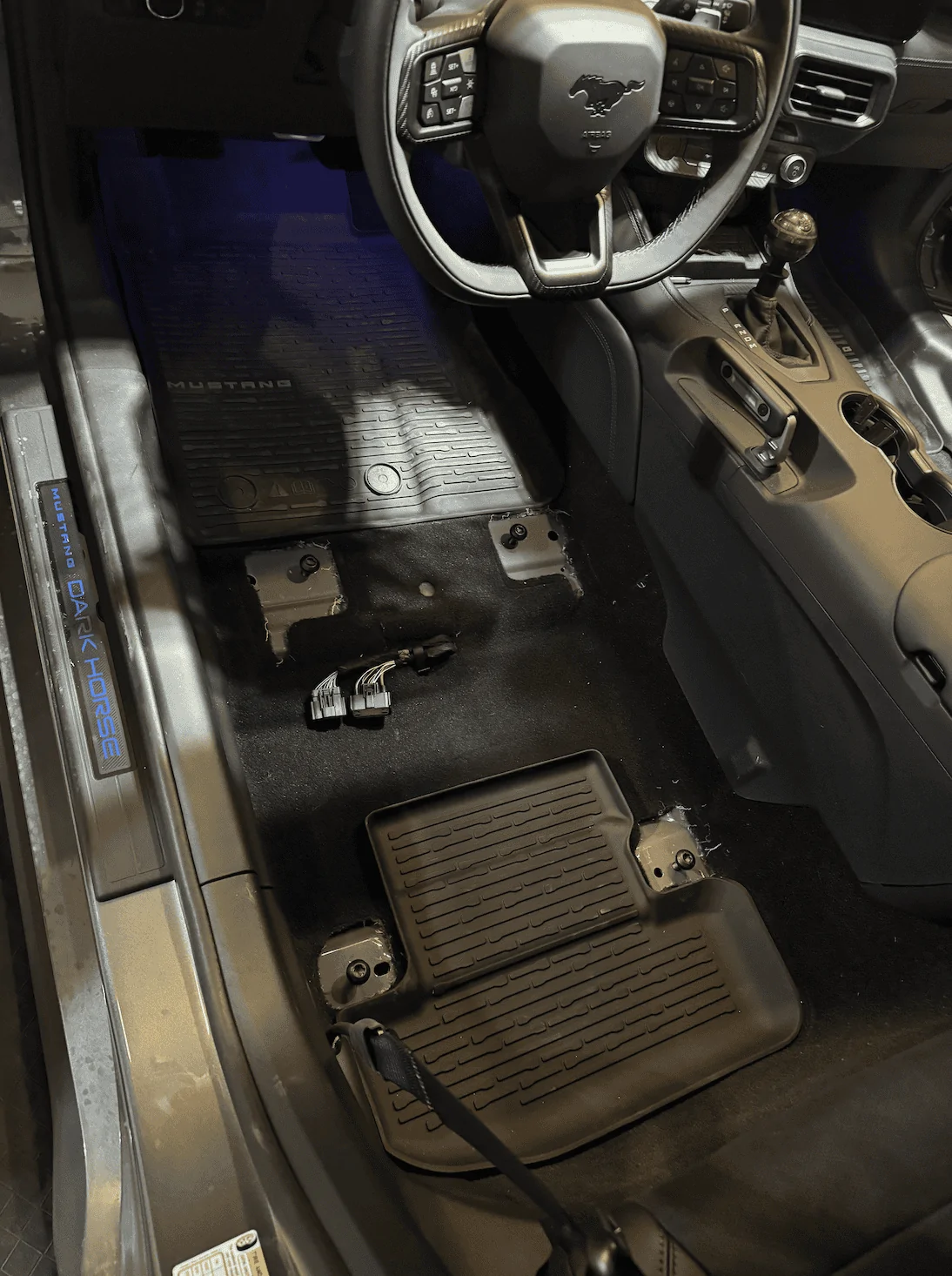

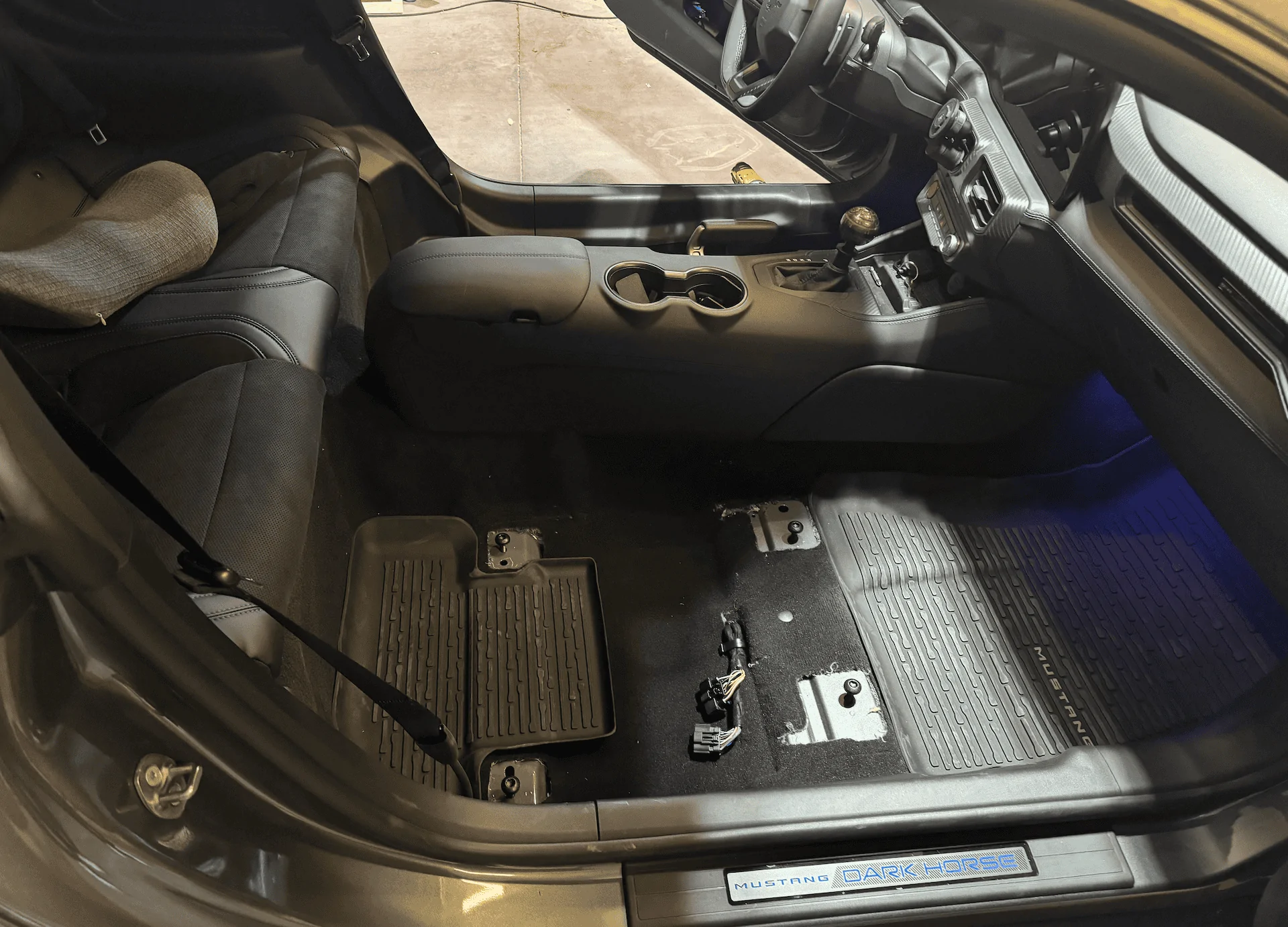

I simply bolted old out and removed Recaros. Disconnected battery, bolted in new seats, in and re-connected the 2 connectors under eat seat.
Reconnected battery and electric immediately works. Ahhhhhh, lumbar support. However, I was hoping that the connection would automatically cue the dash to display the heat / cool controls for the seat. It does not. So I guess I'll have to either do the Forscan hack and / or get the MU5Z-14C708-J part Rocket researched (thank you SO much). Ugh. I'm not going to worry about the seat memory function unless dealer says relatively easy (prolly is easy but another thousand bucks).
Looks like that is an easy way to access the Back Seats.
Just remove the Front Seats.
