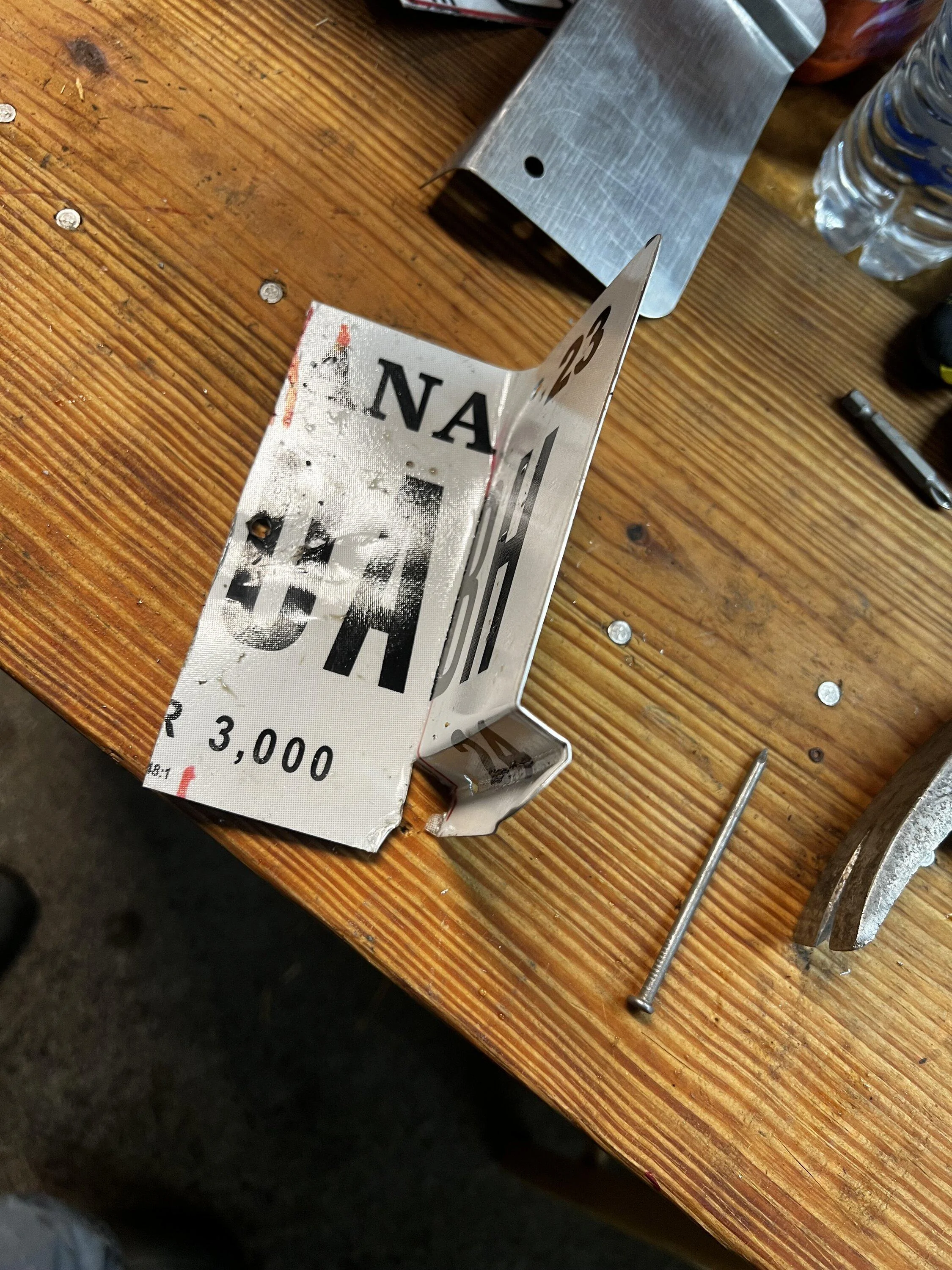

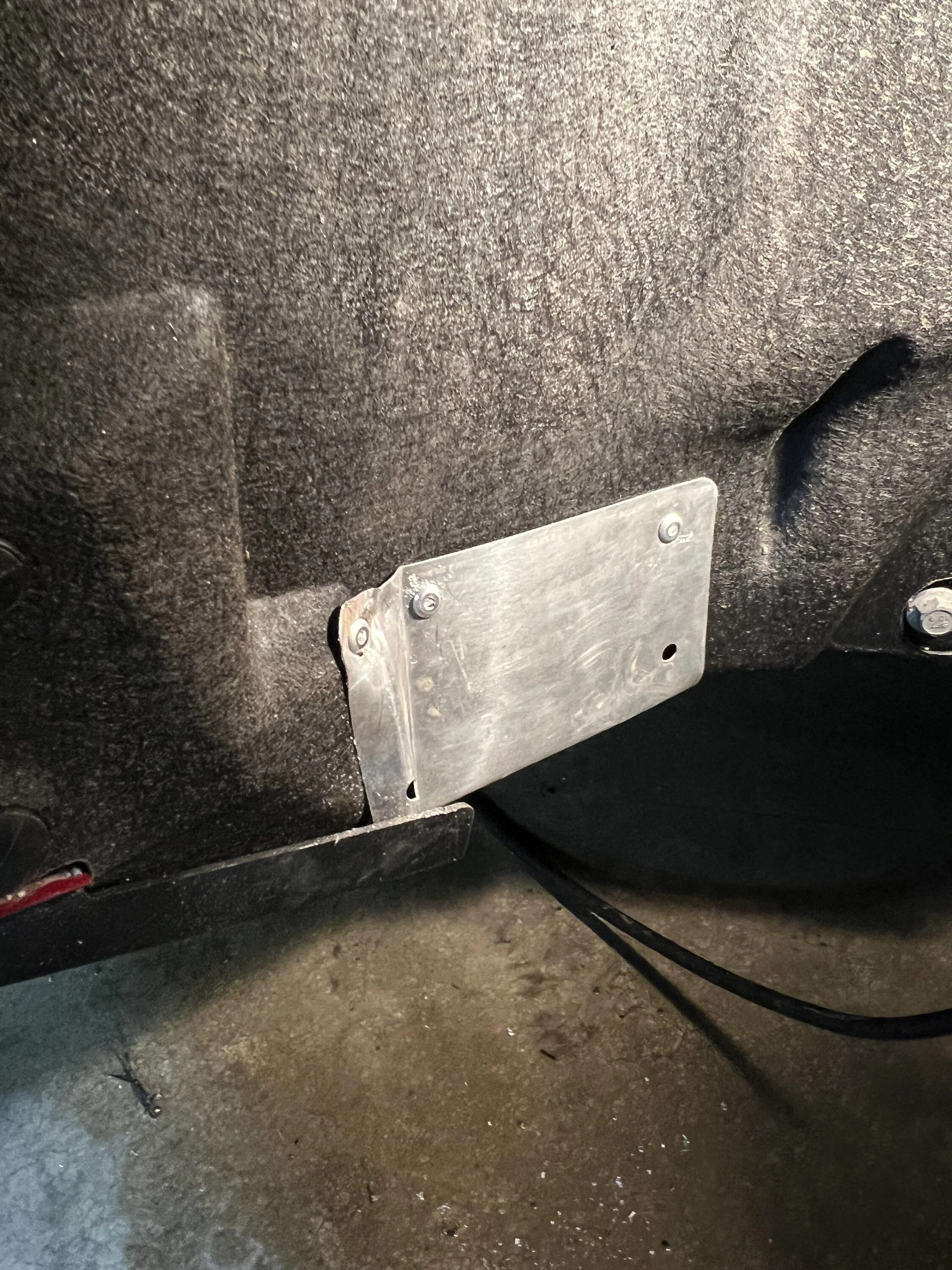

Some of you may call it something else, but I redneck engineered a cover out of an old license plate. Going to add flex seal tape to seal and color it black.
Shape it like a ‘v’ at the bottom pocket, maybe simulate the perceived intent.

Not bad, after the install I would drill couple holes and rivet them in for good!
