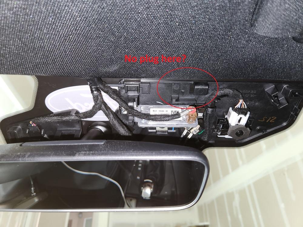

Hey all, my rearview mirror housing does not have the 5-pin adapter all the tutorials show. It's a base Ecoboost (also no USB plug behind the mirror). However, it DOES have rain-sensing wipers (all 2024 Mustangs) so it can be tapped, I just don't know which connector or where? How can I go about finding out? Are there wiring diagrams for these connectors somewhere?
