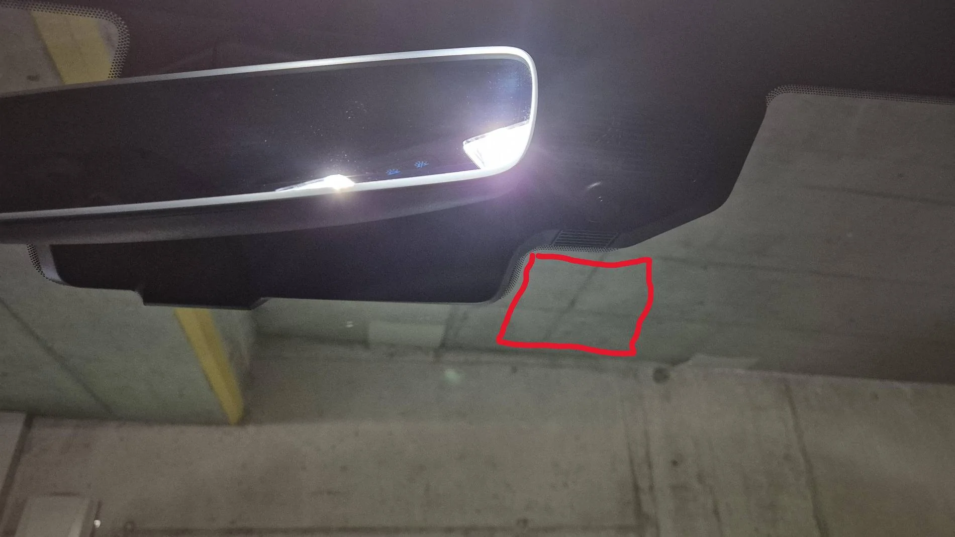

Ah thanks have exactly the same model but with the hardwire kit in addition, this will help me a lot! Didn't know the mirror USB was powered for at least an hour (thought it was like 30 min after turning the car off, but more than an hour is not bad), I might skip the hardwire install completely.
I was thinking placing the camera in the little notch where the sensors' housing does an L shape.
