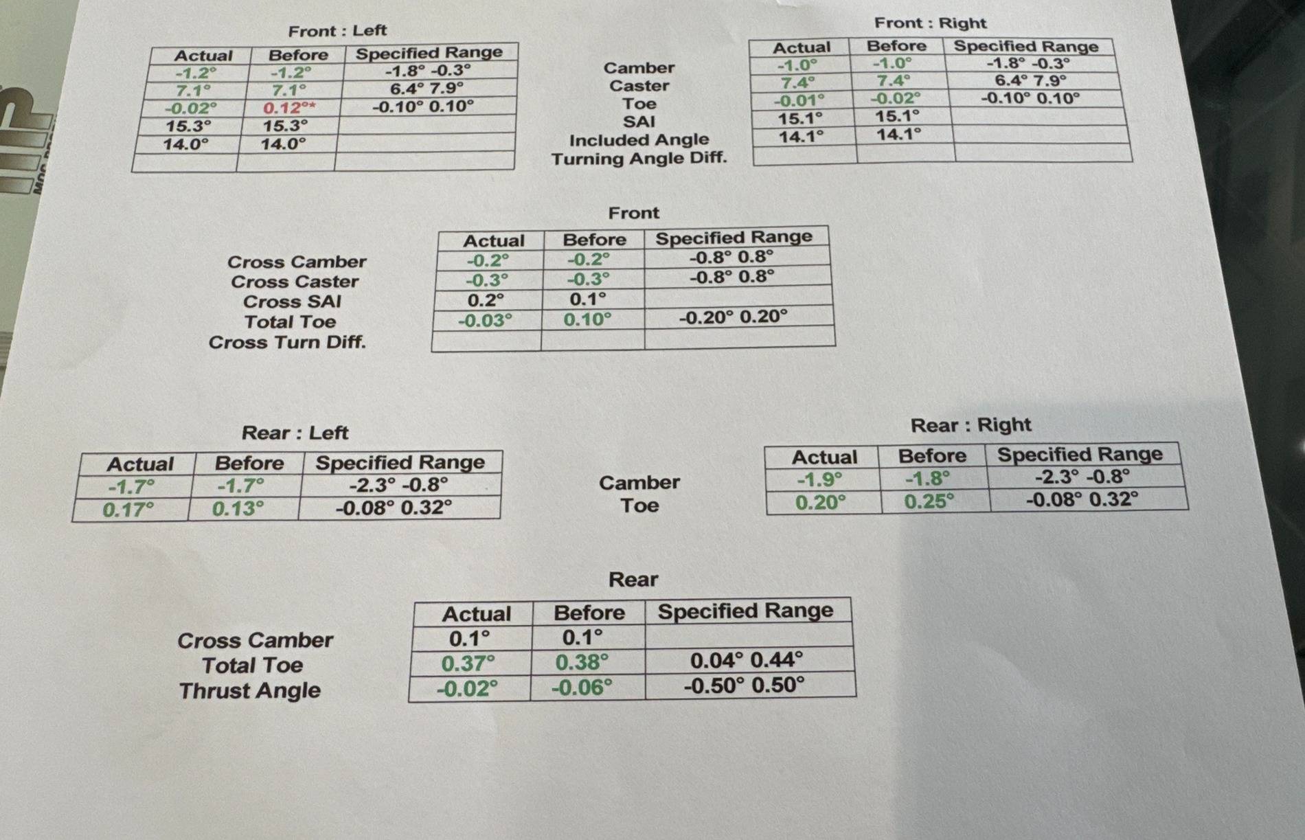

I'm taking it back to the dealership next week so that the serviceman can sit in the car with me and see what I am experiencing. I will post a pic of the alignment they did below.

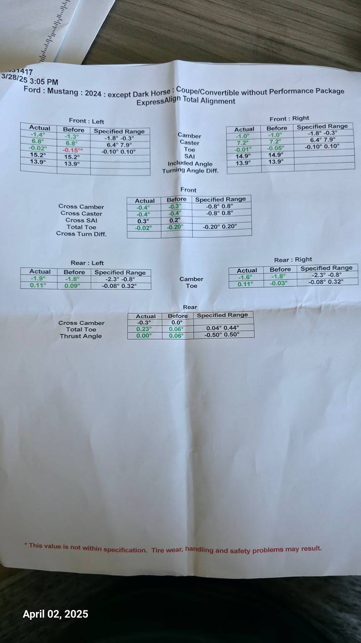

Here's my alignment paperwork....just noticed the top says "without performance package" but my car has performance package! Can that be the issue?
That's not a great alignment IMO. Too much variance in camber from side to side. Just because it's green, doesn't mean it's good. Dealerships are notorious for sucking at alignments.
Looks like you originally had a good amount of toe on the left side. If you drove like that for a few months, it's possible your tire wore uneven and that could be the source of the pull. Especially on those soft garbage Perelli tires.
If you have the PP option your front and rear tires are staggered and can't be rotated. You can however switch sides. If you swap front tires from side to side and the car starts pulling the opposite way, then you have your answer.

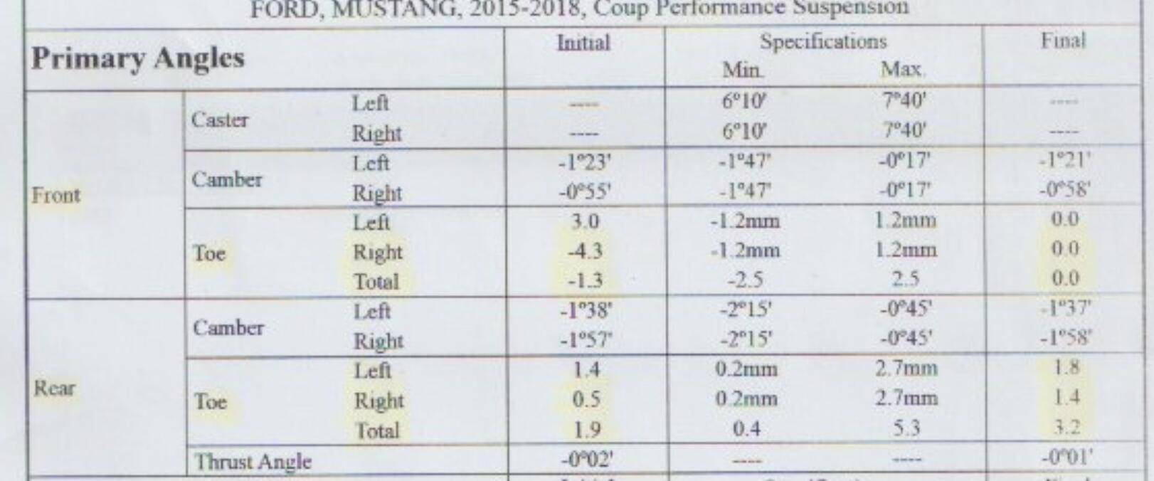

I had my alignment done the other day after 2 weeks of owning it.
Glad I did as the toe was out both side, which I had corrected & steering is great, was great before but won't have the tyre issues I would have had if left it. (ignore the 2015-2018 model noted)
