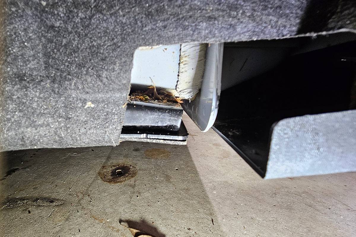

This might help you understand that drainage behind the patch is not a problem.
Passenger side, out of the factory:
S650 Mustang Patching Fender Holes on S650 this will be a real issue for Australian Owners 20241116_105522_0

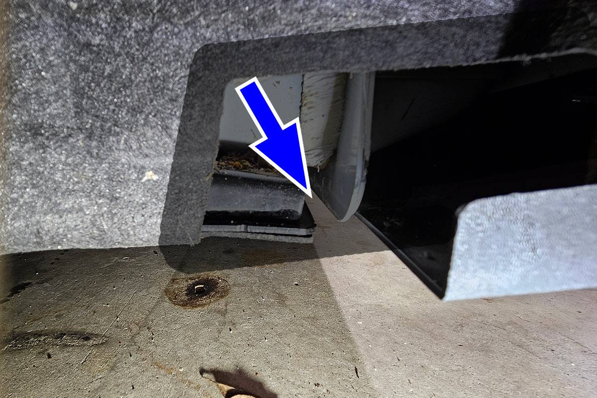

Representation with the patch across front face.
S650 Mustang Patching Fender Holes on S650 this will be a real issue for Australian Owners 20241116_105522_1

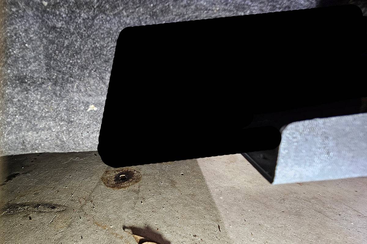

See the opportunity to drain behind where the patch is fitted:
S650 Mustang Patching Fender Holes on S650 this will be a real issue for Australian Owners 20241116_105522_2
If you watched the video, you'd also see that along the bottom edge of the patch, it isn't glued to anything in the middle section - see the liner gap in the photos above!
There are many places for water to run out, and these patches are to stop debris being flung off the tyres and directly into the void.
