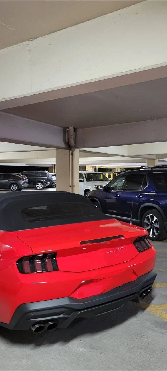

looks like the convertible has it's spoilers mount differently than the coupe, so unless you want to do a 3rd brake light delete or wait for aftermarket support, you're out of luck
How would you go about doing a third brake light delete?

Agree, its cosmetic and IMO the small blade spoiler makes the back end not so blah. I'm just not understanding why some vert models you're not forced into spoiler delete. Apparently, it has something to do with whether you get the PP or NIte Pony Pkg.
I got my s650 vert with the performance package and it was an automatic spoiler delete, it wouldn't even let me add back the low lip spoiler the non-performance pack convertibles have, more money for less...

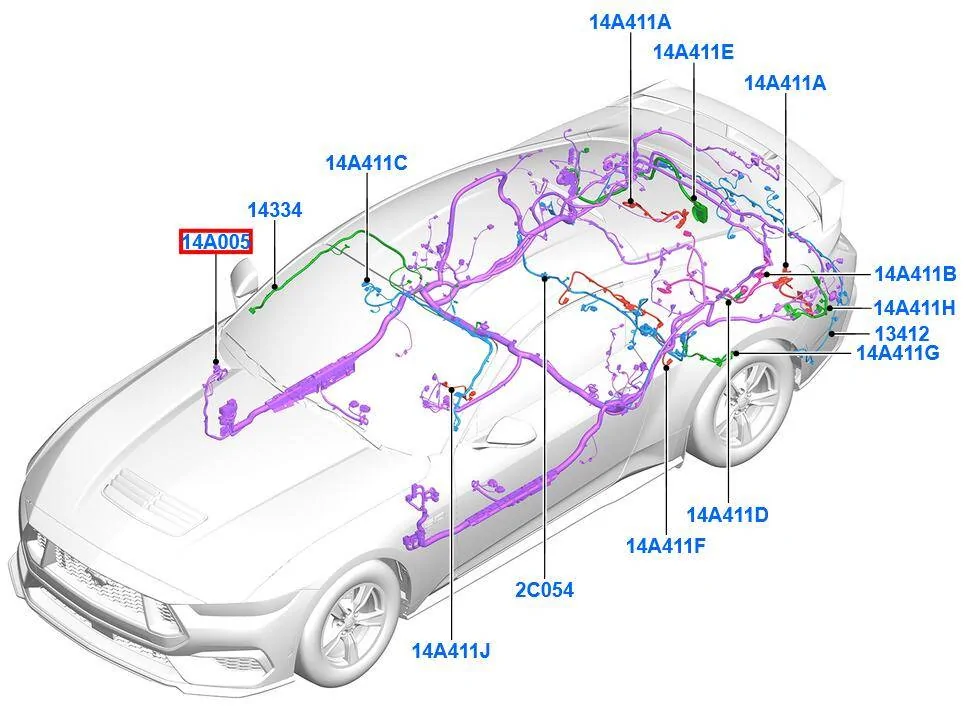

if you want to delete it cleanly, the first step and the one that makes it not worth while is to change the body wiring harness. in the image below, it's the pink wiring
this harness also controls the convertible top, so its even more unrealistic to change it. also, deleting the third brake light is kinda dangerous because if you for any reason have your hazards on and apply the brakes, people behind you now have no idea that you are slowing, increasing the risk of being rear-ended. if you are willing to ignore this risk, the process to just delete the third brake light becomes much easier. really, the only thing that would need to be changed is the end of the trunk to one without the third brake light. if you want to keep the spoiler delete, here is the new part PR3Z-6344210-AEPTM. it is paint to match. if you want to put a spoiler or wing on it, here is the part PR3Z-6344210-BDPTM and the weatherstripping for it PR3Z-6343720-B. if you want to add the lip spoiler some convertibles have, you need the spoiler itself, mounting hardware, the trunk end, and weatherstripping. PR3Z-7644210-AA is the spoiler, it's paint to match. W722355-S442 is the bolt you will need to secure the spoiler (2 needed). PR3Z-7643720-C is the weatherstripping. end of the trunk on the convertible with the lip spoiler PR3Z-7644210-BBPTM. for more details, contact your local Ford parts department

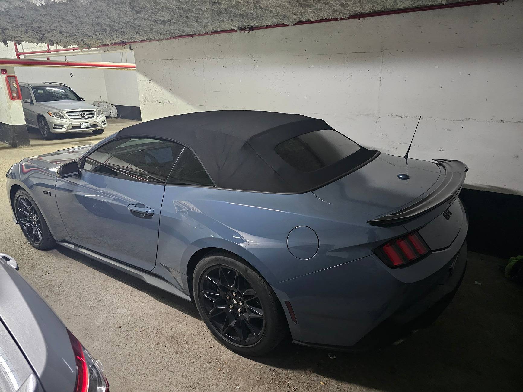

I finally found an aftermarket performance pack rear spoiler that matches the convertible. What do you think? I've read that it (not this particular one but rear spoilers on verts in general - not including the low lip one that comes on non PP - throw dirt and dust into the back of the car so do you think it's worth it and what do you think of the look of it? My s650 is race red with the Night pony package so I would be getting this in gloss black. There are aftermarket front grille and Hood heat vents in carbon fiber but I like the look of the gloss black right now and might as well use it until it starts to look old and faded anyway. Just curious your opinion on whether it's worth pursuing, I would be doing the one with 3M tape no drilling, or if the vert looks cleaner without the spoiler. Thanks for that detailed info by the way, definitely screenshotted that for the future.
https://www.darspoilers.com/collect...rtible-performance-style-wing-no-light2024-up

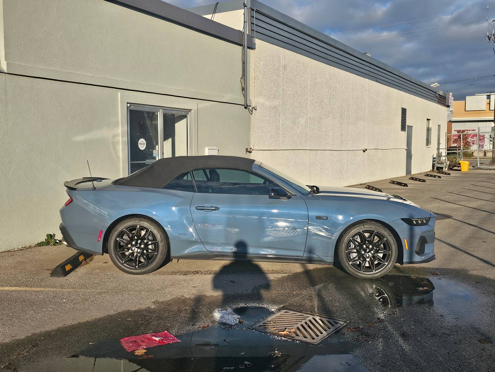

I just installed the DAR no- drill decklid spoiler..
Pro-tip: when installing, align the spoiler with the trunk cracked open.. the edges of the back trunk lid provide a sharper guide to align by than eyeballing the curves.
That looks great, I might have to pick one up.
Is it just black or have the carbon print on it?
24 vert

Does the right corner of the spoiler hit the antenna when you open the trunk all the way or does it clear the factory antenna?
darkpuppet
May 3, 2024
Toronto, ON, Canada
GT Premium Convertible
Yup, it clears the factory antenna just fine.
Can't comment on clearance if you install an aftermarket tennis ball on it tho..
