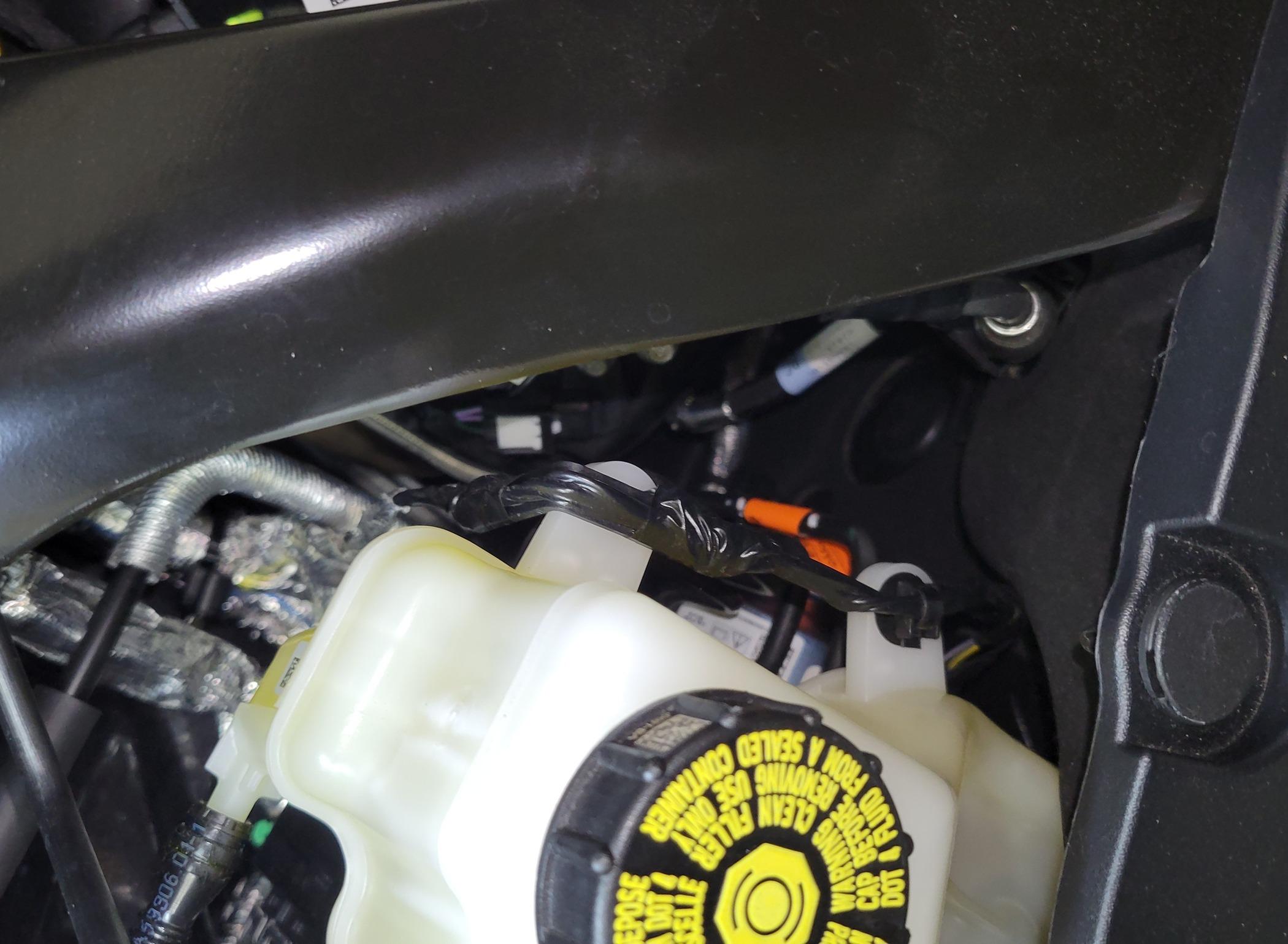

My DH M6 is going to be inspected next Monday so hopefully everything is fine. I looked under the hood and ran it up on some ramps and I don't see anything touching the exhaust anywhere. Does anyone have pictures of the part to show exactly what we are supposed to be looking at ?
id assume its this clip here not being installed on the line
Did you take that picture looking under the hood or underneath the car? I seen something similar to this when I looked in the engine bay on my DH. The one I saw was on the firewall of the car. Thank you for the picture.

1972 f100
Its on the fire wall the recall states a dash post if you follow the hydraulic line thats the only clip that will keep it off of the drivers side manifold
That's what I was thinking as well when I looked at my car.

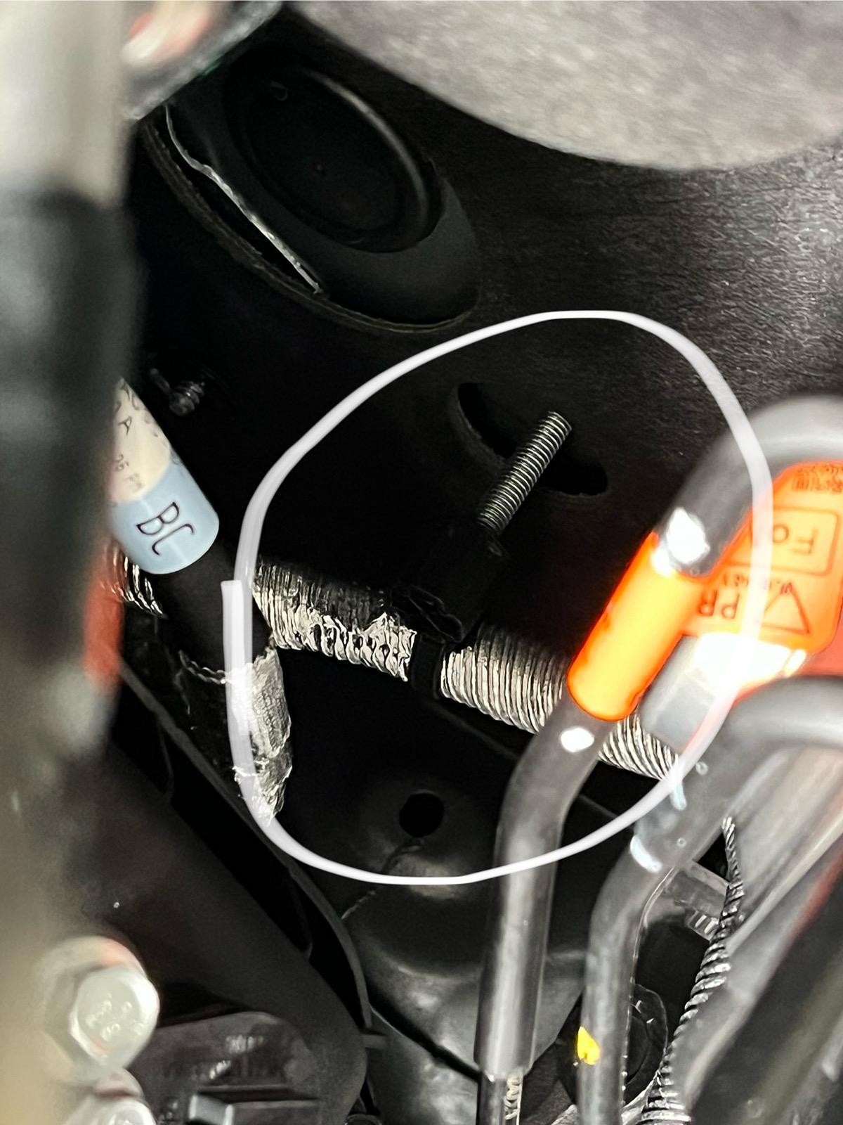

Had a look under the hood. The recall says behind the dash.
I did see one retainer for the clutch hose. It's a plastic retainer at the end of a stud.
It's holding at the tip of the stud.
I was able to squeeze my arm down there but can't push it further on the post. Looks secure though.
Yeah, I'm in the club too. I have an appointment for Monday, but if that picture is what we need to look at, I may just check mine and cancel if all is good. Ford said they would need my car all day because their tech is too busy right now.

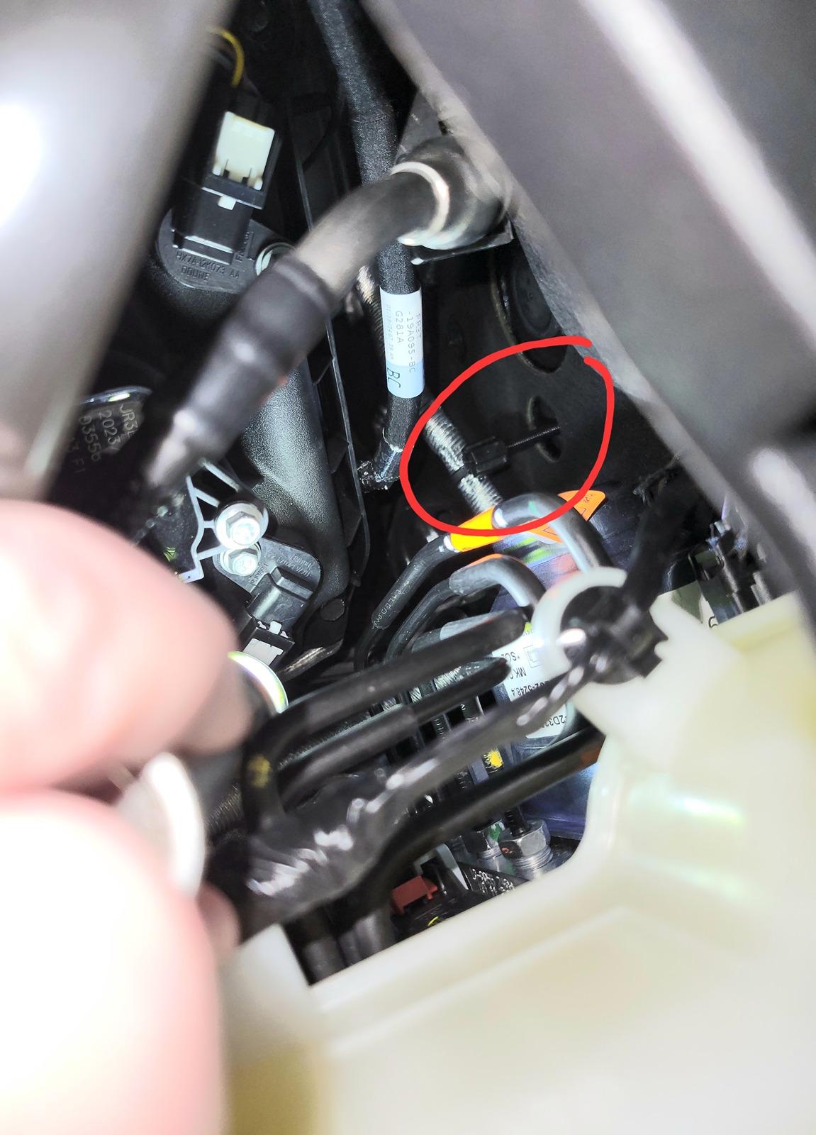

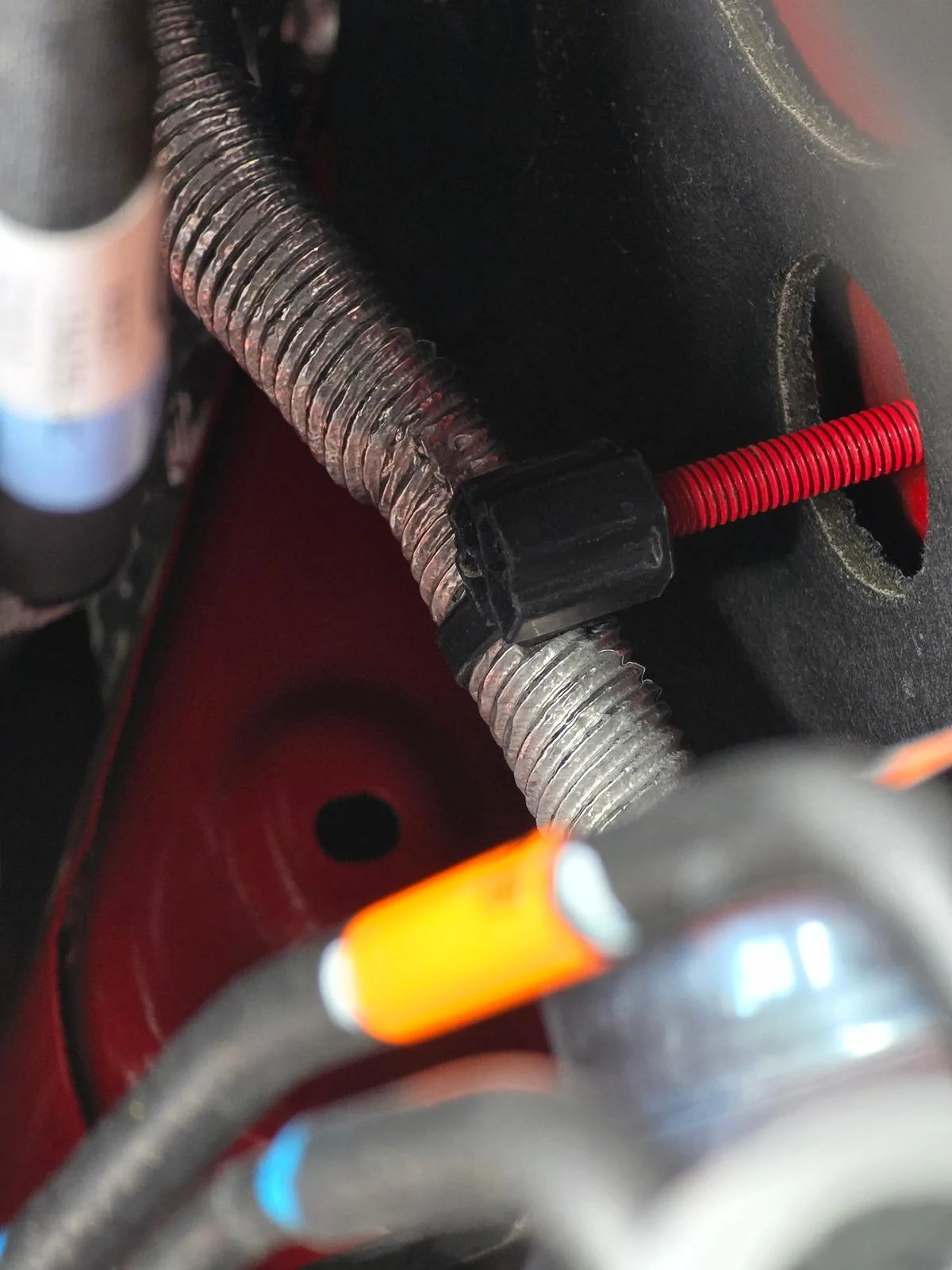

2024 GT Premium Convertible
I just checked, mine is secured to the firewall just as in the photos above. I'm cancelling that "all day" appointment to do what took me 15 seconds to do. I'll have them "check it" next oil change while it's there just to clear the recall.
