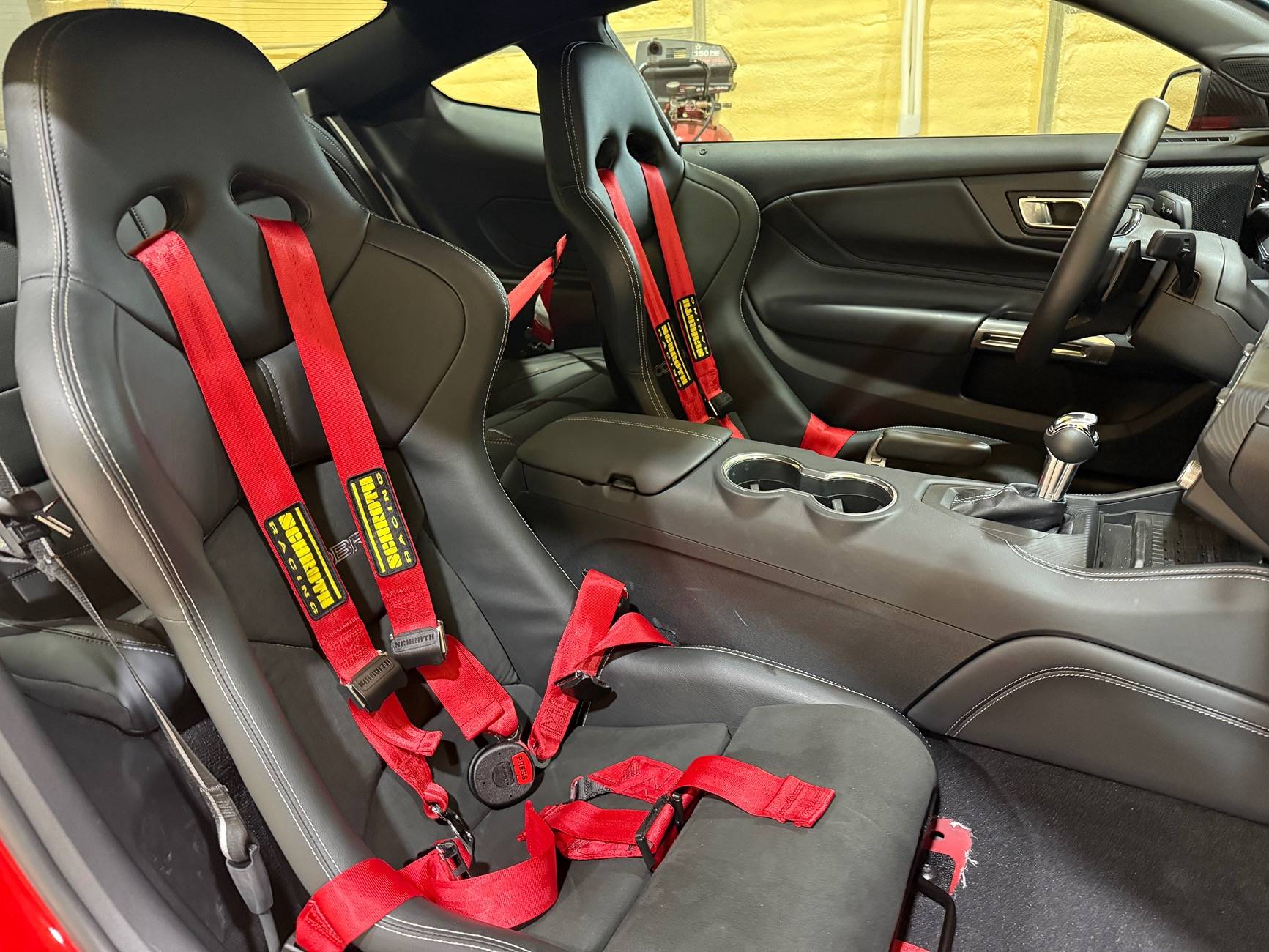

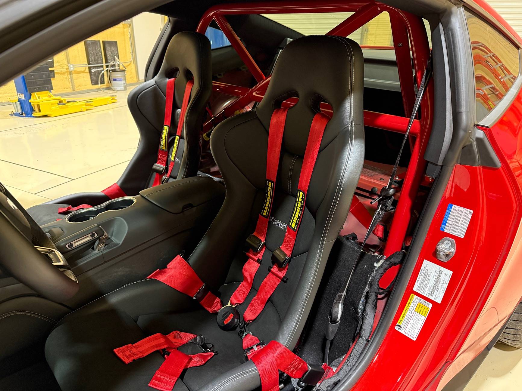

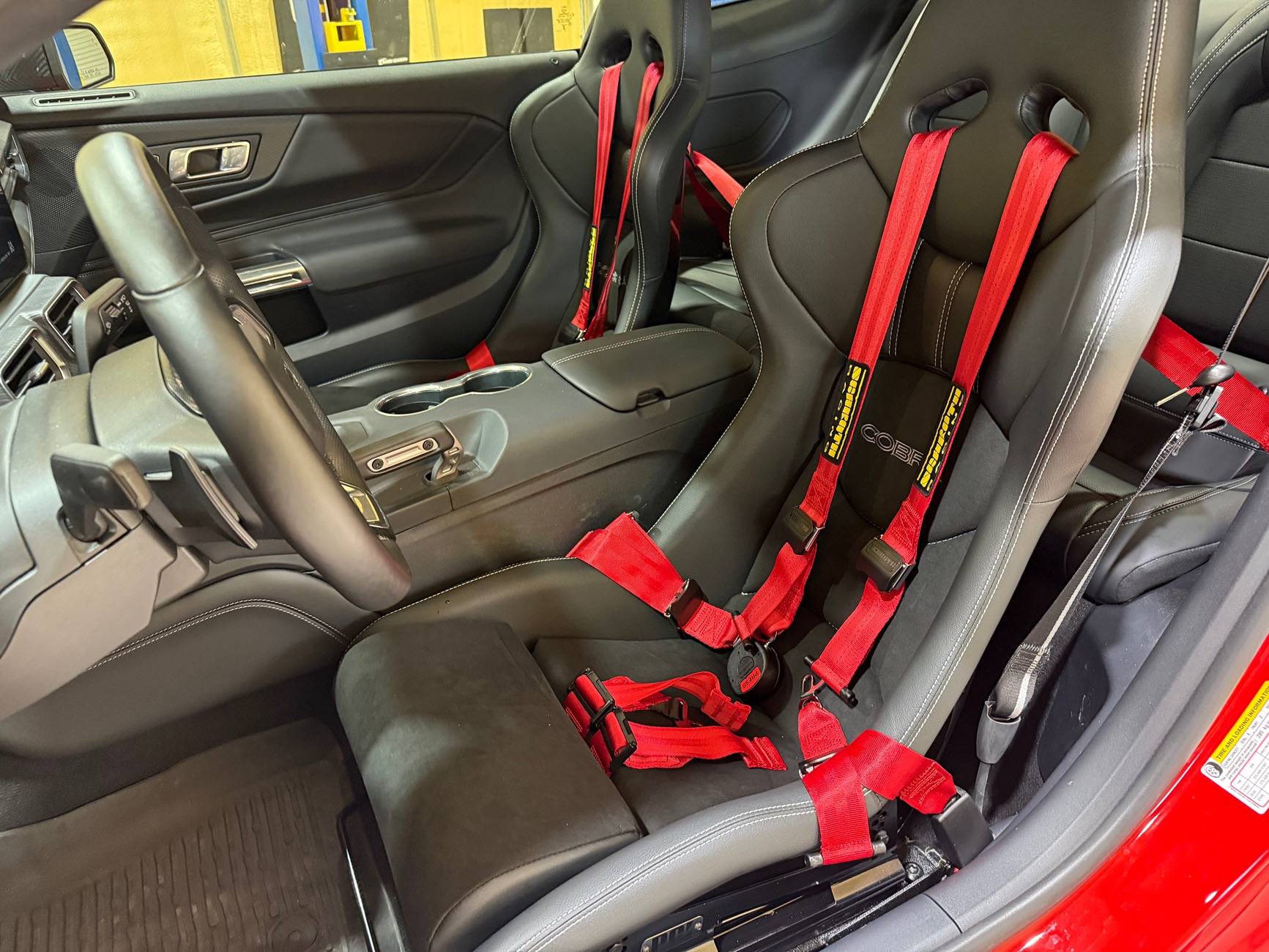

Update: After lots of research and considering options, I decided to go with the Cobra Nogaro seat with the Schroth Quick Fit Pro. I can run this setup without the roll cage, so it will be less hassle to just swap seats without having to pull out the cage.
