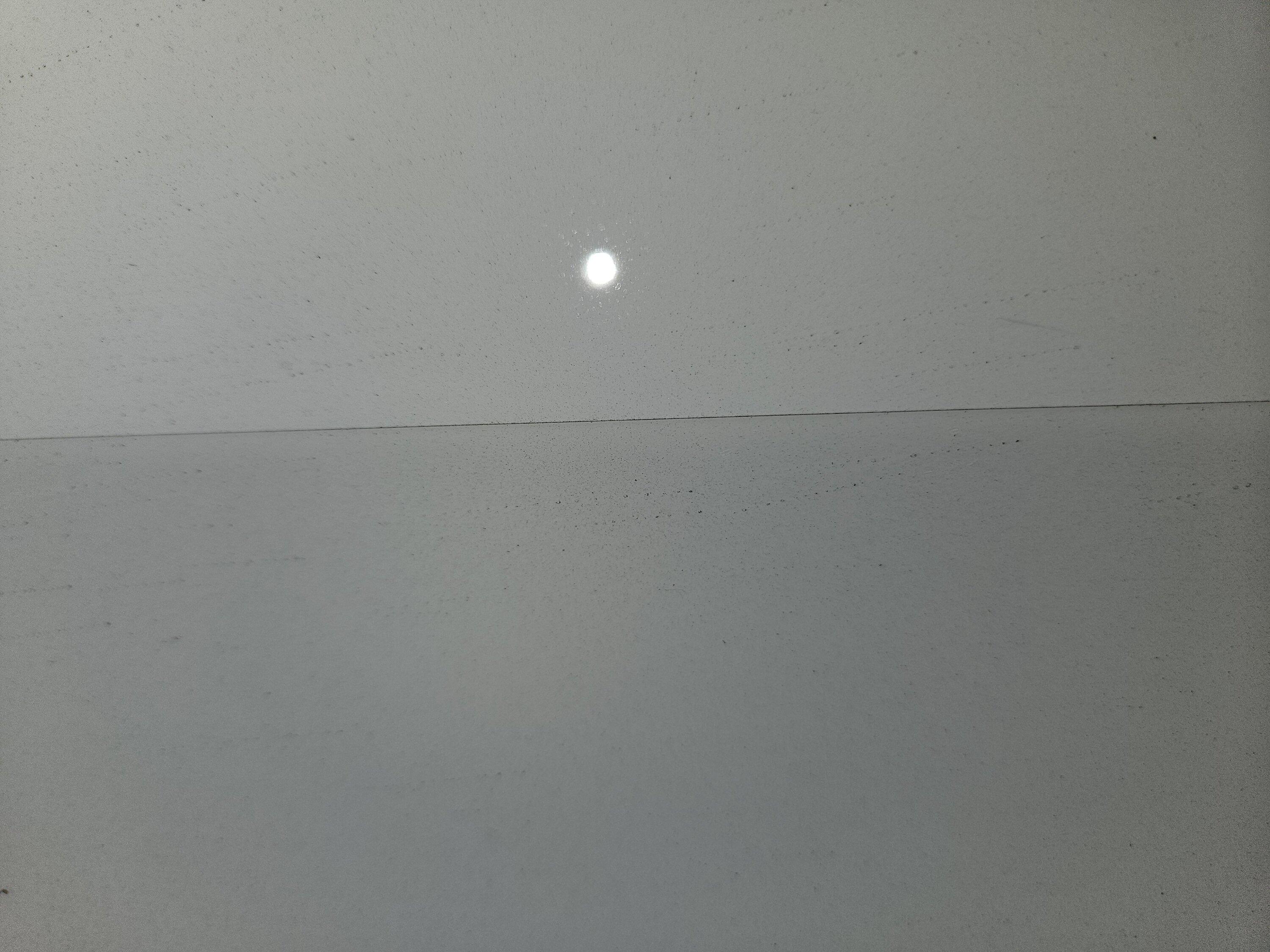

So you couldn't see a seam where the PPF ended? I think for me it's the OCD of having the entire car protected. I picked up my first rock chip about halfway up the driver's door so that's why I'm thinking just wrap the whole thing and be done. My luck I would wrap only the leading edges and side skirts and still get a chip where the PPF wasn't. I'm still shopping around. I really appreciate your input, though. I'm am thinking of doing a partial PPF as you suggested vs full.
Well, my car is white, it kind of shows everything. That said you really have to look for it. Here are two pictures of my rocker panels before I wash the car.
S650 Mustang Thoughts on Paint Protection - Wrap, Ceramic, Teflon,... 20240301_101714
On this image I used the flash so you can really tell where the seem is. Keep in mind the car is dirty, dirt tends to collect around the seems even if you wrap the entire car. Once I clear her up the seem line almost completely disappears.
S650 Mustang Thoughts on Paint Protection - Wrap, Ceramic, Teflon,... 20240301_101643
