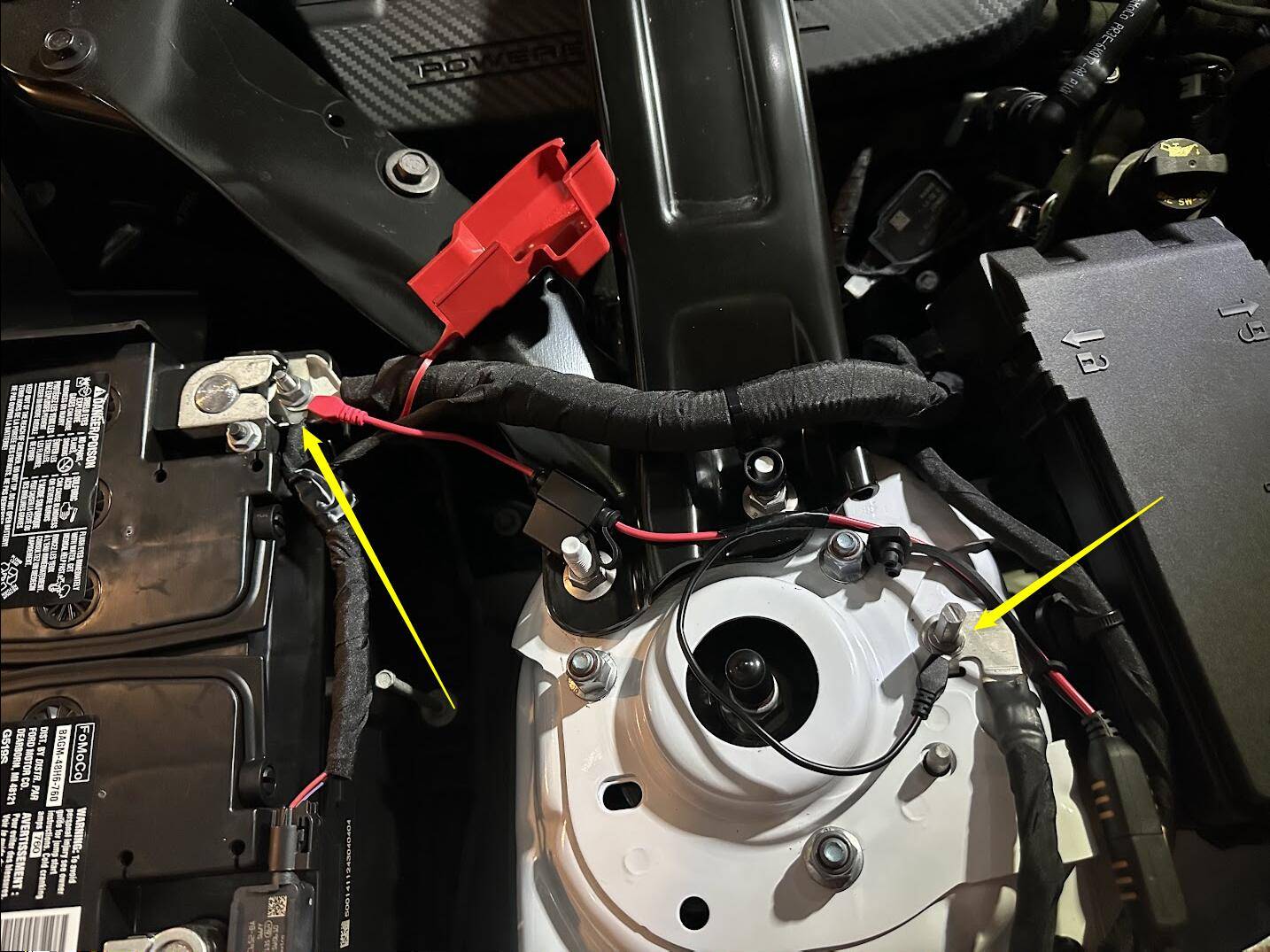

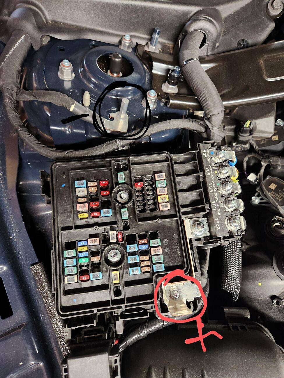

The tall ground terminal on the strut tower (never to the battery -), and the terminal under the red cover at the fusebox.
Thanks! So basically this image.

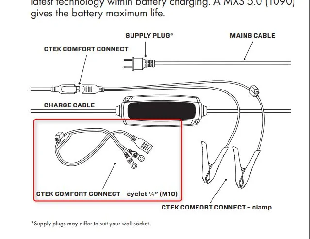

Not sure the pigtails that came with the CTEK are long enough to reach that. Will try later today after work. Will need M10 apparently.

I had read somewhere that connecting the power to the fuse box power terminal was a no no?

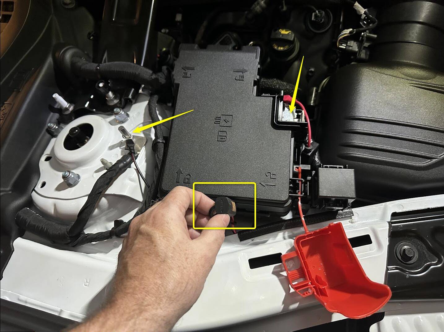

Since I'm WFH today I took a coffee break and went down to the garage to see if the pigtail connectors that came with the kit would work. They do, but barely. I had to tuck them under the fuse box.
I also think the M10 might be too big for the terminals to get a solid contact. Maybe an M8 would be better size but would like to see what you ordered before I pull the trigger on that.

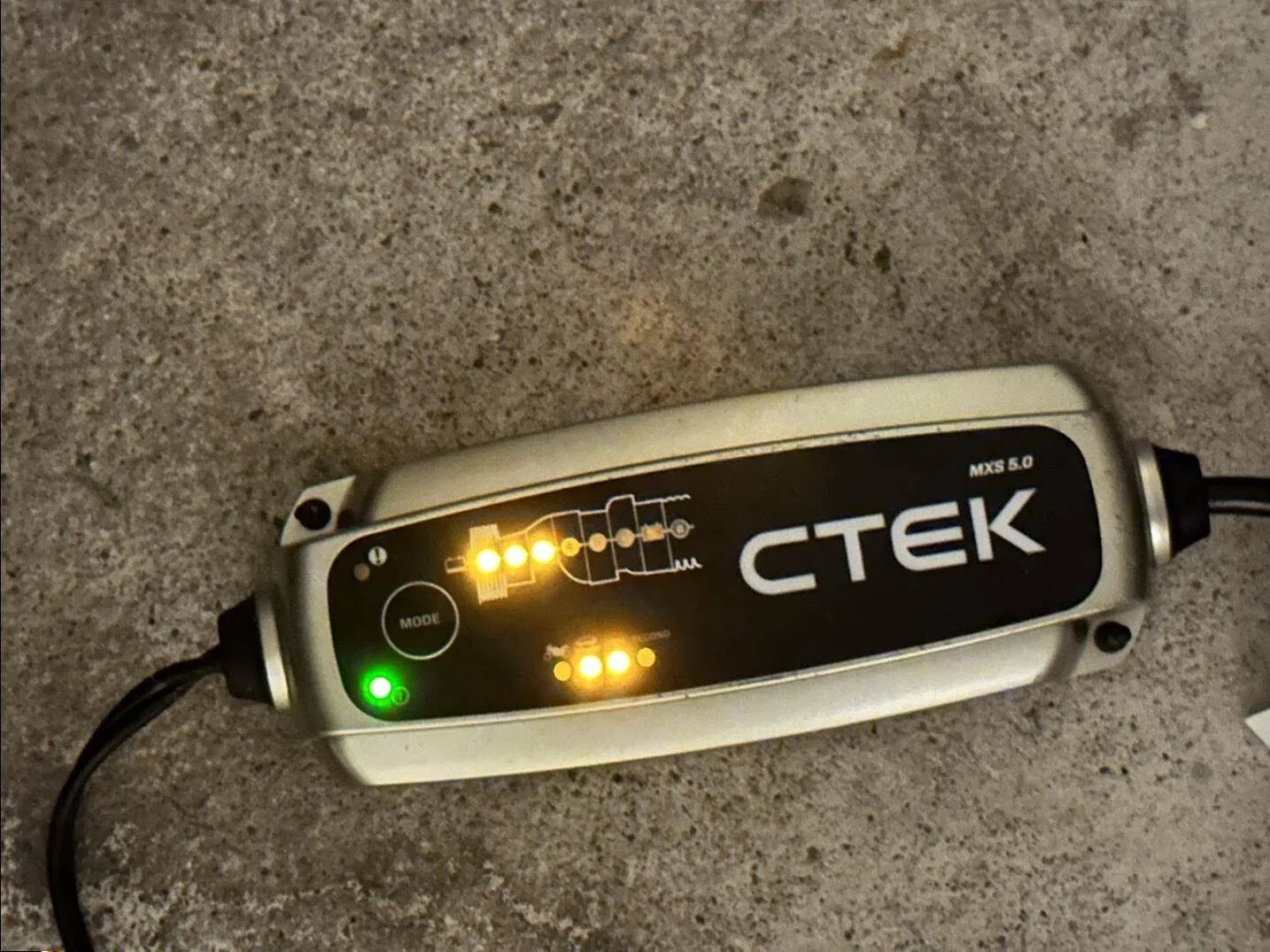

I opted to follow the instructions in the manual.
For negative grounded vehicles
POWER = the + terminal on the battery
GROUND = the chassis grounding post
Here is my temp setup until I start seeing more than 3 lights on the CTEK and then I'll button everything up.
S650 Mustang Trickle charger recommendation for winter storage. 1726076131773-7o
It IS in AGM mode as well since the battery is an AGM even though I don't have the START/STOP function in my Dark Horse.

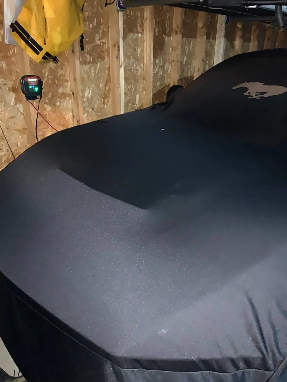

I have been using the optima d200 for awhile now. At a glance I can see the green lights that tells me alll is well.
