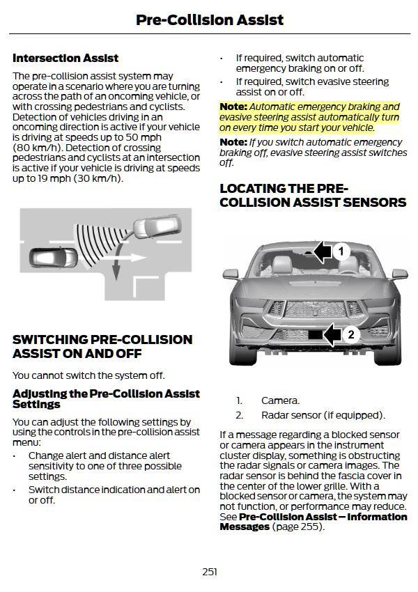

Roket, you once said that you can turn off AEB/emerg braking in your console, go away, come back a day later, and it still stays off. It doesn't for me. It auto-reengages. I've seen others report this.
I wonder -- is this country specific, or is it bcm1/2 specific?
Can you confirm... that AEB stays OFF forever when you turn it off?
64
2,043
2,992
gonna be totally honest here, i dont remember if i did say that or not. if i did, that was incorrect. according to page 251 of the 2024 Mustang Owner's Manual, pre-collision assist will only be deactivated for that key cycle
