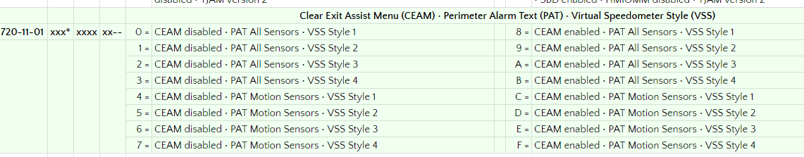

Where to find the speedometer change? I look through the excel sheet and cannot locate "change speedometer". I tried looking for the address but cannot find. In the excel sheet, is it under the tab "IPS 720"? Please help as I want to change it to the DH setting of 180MPH. Thanks!
AddressValue
720-11-01
the module is "IPC" and search for "VSS" or "Visual Speedometer Style"
Are you referring to the actual car in forscan or in the excel that was attached? Sorry, I'm new to this and don't want to mess things up.
64
2,042
2,991
the spreadsheet in the main post

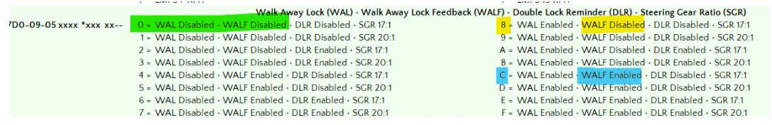

You're looking for Walk Away Lock Feedback?
BCM 726-91-01 xxxx xxx1 xx--
BCM 726-97-01 x1x1 x1x1 x1--
APIM 7D0-09-05 xxxx Cxxx xx--
You already changed BCM 726-91-01 for WAL. You need another change (different position) for WALF. Leave the first change (xxxx x1xx xx-- ) in place.
Also, you likely changed 7D0-09-05 from xxxx 0xxx xx-- to xxxx 8xxx xx-- to get WAL to work. If you want WALF to go along with it, that requires these two additional BCM changes, and it requires you to change what you already changed in the APIM to get WAL to get both:
APIM 7D0-09005 xxxx Cxxx xx--

The values I used worked for me for WALF, @MKS33. I did revert them back later as I didn't want the horn chirp, but I did test it out and the horn chirp when WAL triggered did work.
Suggestion: Double-check and make sure your edits are correct. I've been doing this for years and still screw up editing the wrong entry or changing the wrong digit.
For the BCM updates: Make sure you didn't confuse 726-97-01 with 726-97-02.
For WAL, the edit is for 726-97-02
For WALF, the edit is for 726-97-01
The confusing part is: The edit is the exact same VALUE for each: x1x1 x1x1 x1--
Once I got WAL to work, when I went back to try WALF, I mixed up 01 and 02, thinking I had already made that change (due to the value being the same). Then I realized I actually needed to (also) edit 01 for WALF. Once I did that, it worked.
And if I'm not mistaken, I believe the APIM update will add the WALF to the Sync screen under Vehicle / Locks. Make sure it's ON.
Also, you should always reset the APIM module after making any changes.

The APIM edit simply displays the option in the Vehicle/Locks screen. But without the correct BCM edits, that option won't do squat (enabled or disabled).
