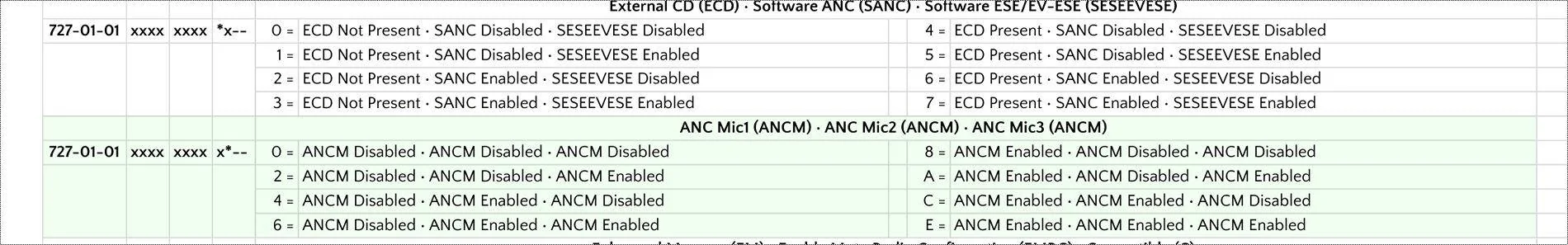

In the above there is talk about using forscan to disable it. That's for the S550, but the 650 should be the same?
Here's info from the spreadsheet in the forscan forum on this site. It does look like you can tell the car there are no mics, and also just turn of Software ANC.
Have you tried this?
(The dealer should be able to do this too, without a physical disconnect)

https://www.mustang6g.com/forums/threads/forscan-codes-s550-mustangs.98260/page-3#post-2155503
GT’s do not have ANC. They have the physical sound tube under the hood. ANC is for the Ecoboost.
