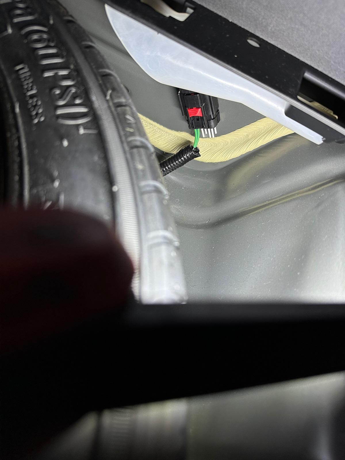

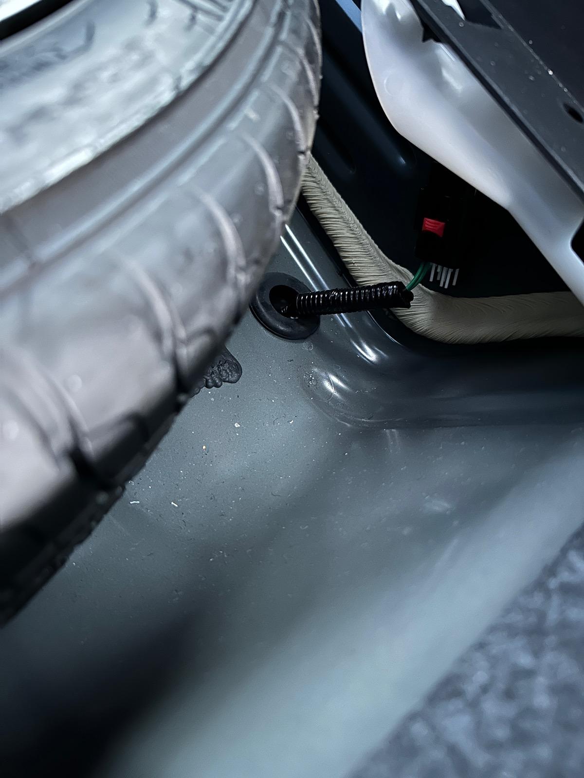

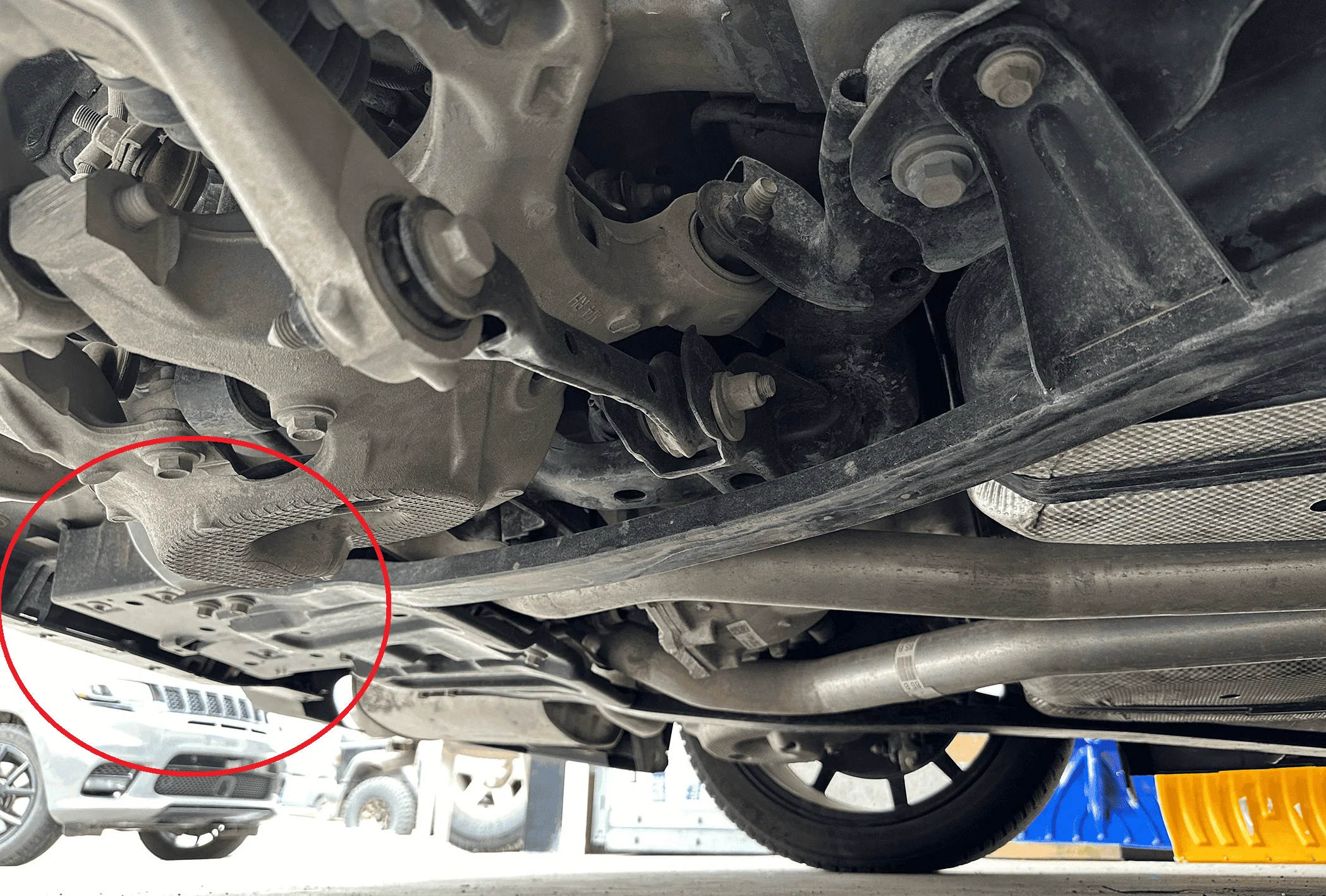

you are looking too far forwards. the wiring and actuators are at the very back. the harness that splits to power the actuators runs through the trunk. lift up the spare cover and look at the far back part. on the left is a wire that runs through a rubber grommet. that wire re appears underneath right next to a plastic box that has some evap stuff in it. the actuators themselves would be on the inner exhaust tips, after the muffler. do note i am taking about the S650
Oh Yes pictures were taken quick while I was changing tires. The red circle is exactly where I need to look at, right?
S650 Mustang Aftermarket OEM Active Exhaust 1713211397441-kt

yes, in that area. as for the connector, i am 99% sure that the same wires exist on act8ve and non active vehicles, and 100% sure that it is the same connector. i honestly wish i had a non active one to test on, because i hate leaving these kinds of things to speculation only

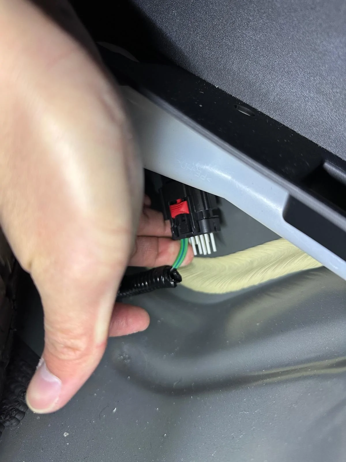

i found the wiring and it looks like the wires for active exhaust always exist at that connector, just are not used and not called by anything by programming. this is also backed up by the pictures i sent earlier, which seemed to always have the same wires regardless of whether or not it had active exhaust
I also found exactly the same one you posted. My friend who’s a mechanic, he told me that the harness seems the one I was looking for. What I will do from now is to get parts needed without a full exhaust system and reprogram first through forscan. I’m just curious if I only need one for each harnesses and two actuators
