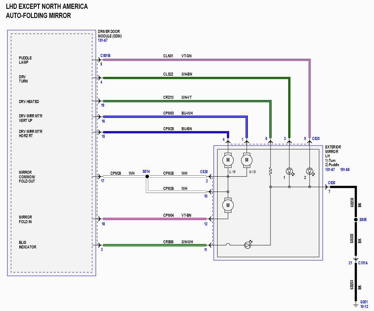

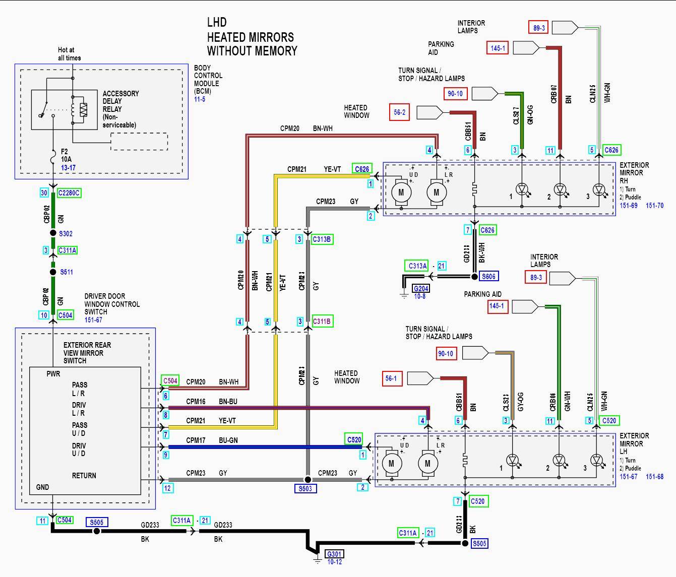

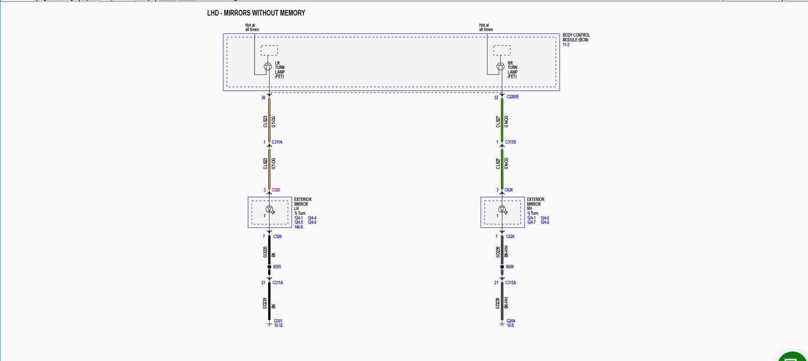

the first diagram is a layout of the connections to the mirrors on an NA Mustang. importantly, the caption says "without memory", but the diagram still shows the indicator. however, this specific diagram mainly highlights the wiring for the power adjustable mirrors for vehicles without the memory buttons, as the wiring is vastly different between the ones with and without. the second diagram is simply showing you that the BCM is still connected to the indicators even on mirrors without memory functionality. here is an explanation i put together
S650 Mustang Are the side mirrors with turn signals plug and play? 1736701765940-2b
the red boxes are wires that go somewhere not shown on the diagram, and the numbers are the cell and page for it.
the green boxes are connectors.
the cyan boxes are which pin that wire is in a certain connector.
the dark blue boxes are splices, where wires are split apart or come together.
the black boxes are grounds.
near the wires, you will see 2 or 5 character "words", like "BN-BU" (brown-blue) or "GY" (grey). that is the color of the wires, along with the wire colors being in the diagram. if its just 2 characters, the color is solid. if its 5 characters, the first 2 are the wire's main color, and the last 2 are the wire's stripe color.

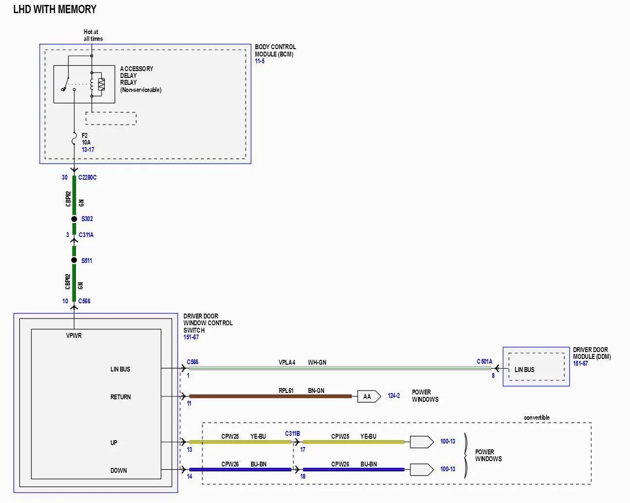

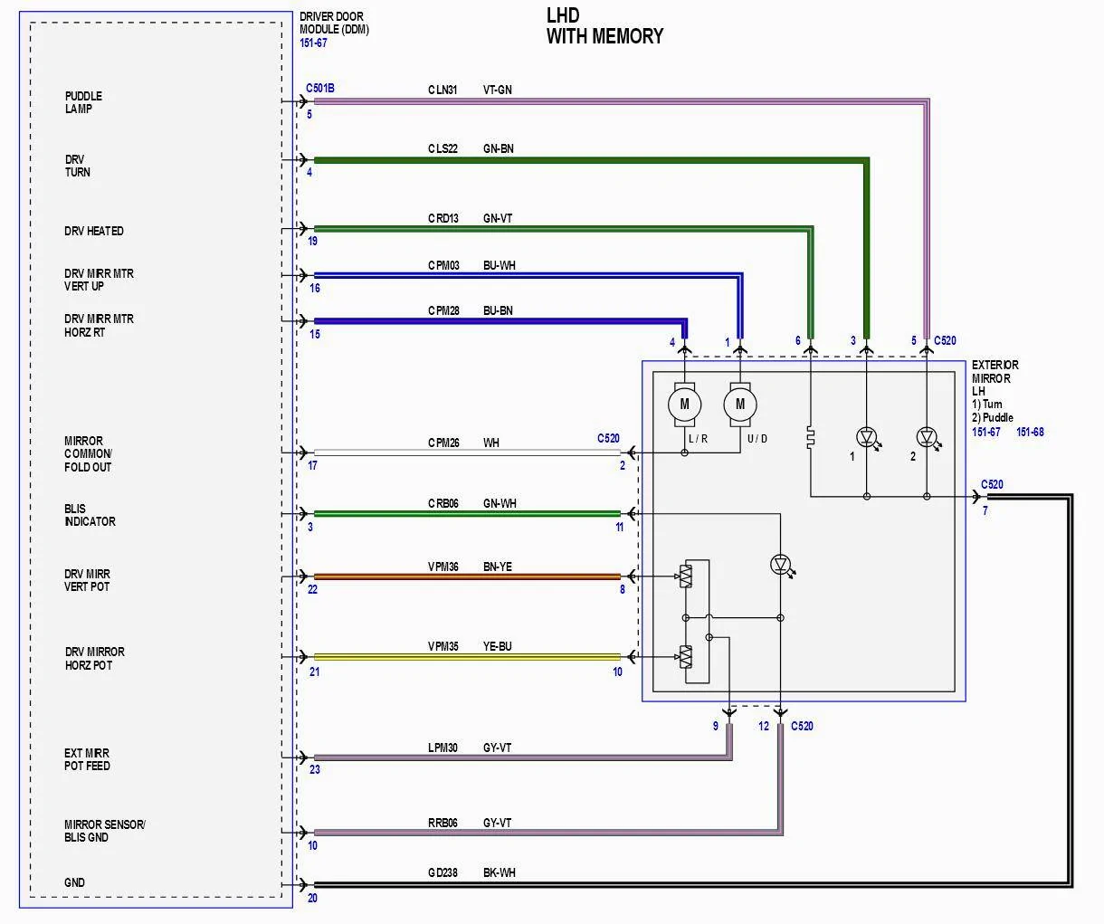

with memory functionality, it is very different wiring

and it looks like despite not having memory functionality, all overseas Mustangs use this "DDM and PDM control the mirrors" thing, which means it might be possible to retrofit memory seats and mirrors on overseas vehicles that are LHD. RHD vehicles might be out of luck due to the lack of a door handle that can fit a RHD memory button cluster, if one exists

i cant say for 100% sure, but the evidence of wiring diagrams and some posts on other forums from the previous gen certainly imply that it will work. just be sure to enable the indicators in the DDM and PDM
It appears there is no DDM or PDM without memory seats... turn signal wiring shown there is directly from the BCM.
thank you for pointing out my mistake. it might then be a matter of plugging it in, and if it doesnt work, exploring the BCM tab of the spreadsheet for possible solutions
actually, i just checked, and vehicles without memory seats actually do have DDM and PDM modules. i checked this using a 100A EcoBoost and a 700A Dark Horse with recaros. though, your point about it being wired directly to the BCM is true still
Very strange that there is a wire directly from the BCM while none of those Mustang trims have integrated side mirrors
64
2,044
2,998
probably leftover from shared designs and programming
